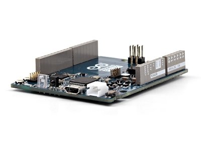

Thanks to a partnership with Nordic Semiconductor – the world’s most successful open-source ecosystem for education, Maker, and Internet of Things (IoT) markets -, Arduino announced its new board, Arduino Primo, including native Bluetooth Low Energy wireless connectivity and NFC touch-to-pair using Nordic nRF52832 SoCs.
The Arduino Primo combines the processing power from the Nordic nRF52 processor, an Espressif ESP8266 for WiFi, as well as several on-board sensors and a battery charger.  The nRF52 includes NFC (Near Field Communication) and Bluetooth Smart.  The sensors include an on-board button, LED and infrared receiver and transmitter.
There are three onboard microcontrollers:
  • nRF52832, the main Arduino microcontroller with integrated BLE and NFC
  • STM32f103, a service microcontroller used for advanced debugging and programming of the other microcontrollers
  • ESP8266, for Wi-Fi and related internet connectivity functions.
The board has:
  • 14 digital input/output pins (of which 12 can be used as PWM outputs)
  • 6 analog inputs
  • 64 MHz ceramic resonator
  • micro-USB connector
  • ICSP header
  • battery charger
  • Infrared receiver and transmitter
  • NFC antenna
  • BLE interface
  • Buzzer
  • two service buttons
  • LEDs
  • reset buttons (to reset the various microcontrollers).
Arduino Primo can be connected to a computer using a micro-USB cable, or it can be powered using a battery, connected via a 2-pin JST-PH connector. Having both Bluetooth and Wi-Fi connectivity on board makes it easy to get started in the IoT world.
