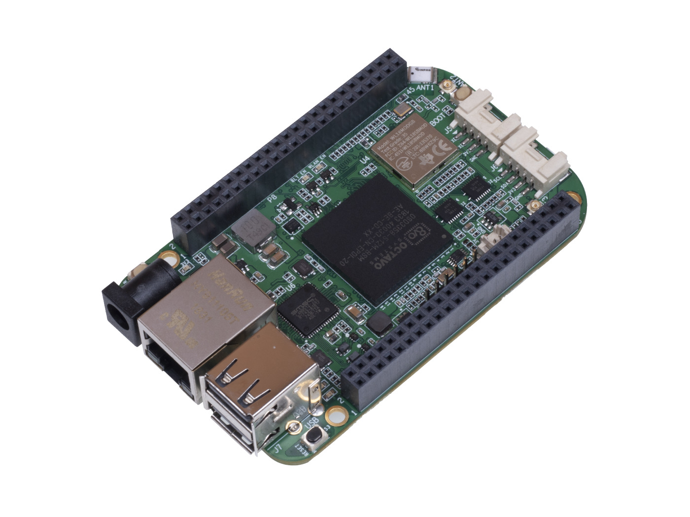

SeeedStudio has been working on an addition to their BeagleBone Green Development Board family with an update to the BeagleBone Green Wireless board named BeagleBone Green Gateway. The board features the new Octavo Systems OSD3358, which is a SiP (System in Package) that integrates the AM3358 1GHz ARM Cortex-A8 Processor, 512MB DDR3 SRAM, and other wonderful features into one package.

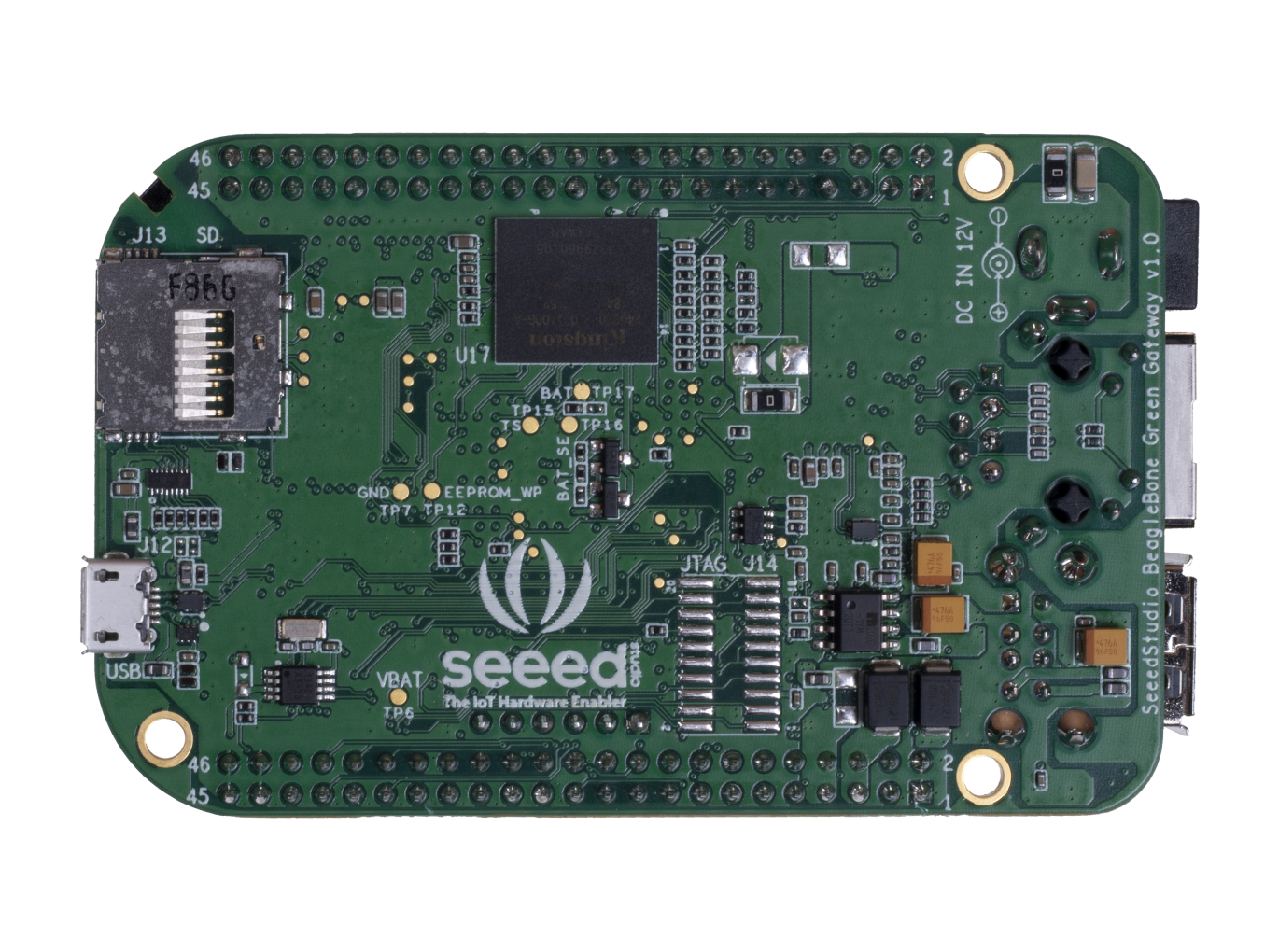

The new board is being designed to suit applications where the board is being used as a gateway, as such, it comes with both Ethernet Connectivity, WiFi and BLE Wireless connectivity options. The board also comes with an extra DC connector for power (overcoming the Micro USB only for power limitation), and an onboard I2C RTC, so that it is more suitable for industrial application or applications where time accuracy is required.

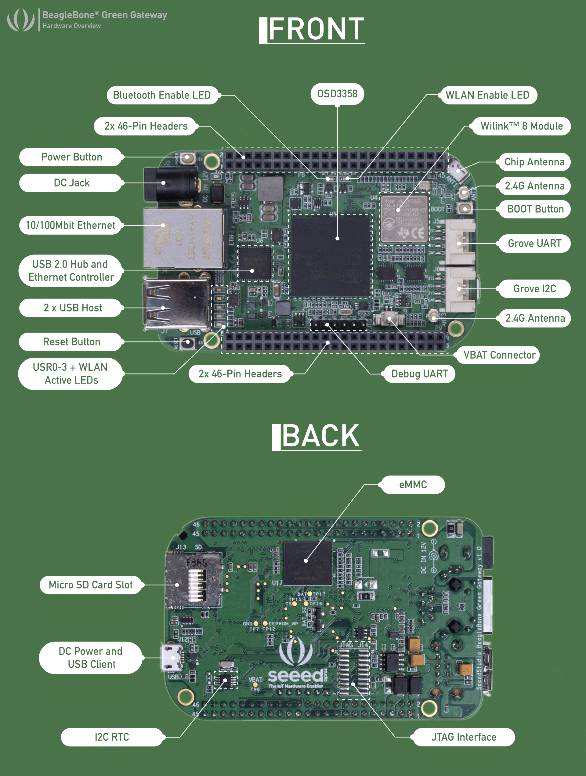

Some of the expected features and specifications of the new board include;
Processor
  • Processor: Octavo Systems OSD3358
  • AM3358 1GHz ARM Cortex-A8
  • 2×32-bit 200-MHz programmable real-time units (PRUs)
  • 3D graphics accelerator
  • NEON floating-point accelerator
  • 512MB DDR3 SDRAM
  • 4KB EEPROM
  • Integrated power management
Memory
  • 4GB 8-bit eMMC onboard flash storage
  • SD/MMC Connector for microSD
Connectivity
  • DC Jack for power, 12V
  • Ethernet 10/100Mbit
  • USB 2.0 Host x2
  • USB client for power and communications
  • 2x 46 pin headers
  • 2x Grove connectors (I2C and UART)
  • WiFi 802.11 b/g/n 2.4GHz
  • Bluetooth 4.1 with BLE
  • I2C RTC, and 3V battery connector
  • Debug UART header
  • 3x Buttons
  • 2x 46 pin headers and 2x Grove connectors fully compatible with Seeed Studio Beaglebone Green and Seeed Studio Beaglebone Green Wireless
  • Operating Temperature: 0 ~ 70
