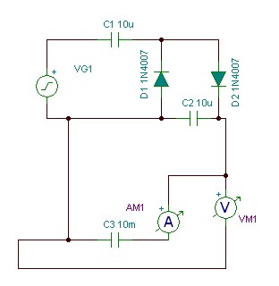

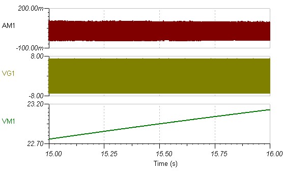

  14. After days of trying to choose between different ways, I chose to go with the CW multiplier. Tried to charge for more than 30 sec with 1n4007 and 10 nF cap system, the 10 mF cap got charged to only 500 mV. I think I have chosen wrong value cap. Here, I tried to simulate with 7 VA 800Hz source, and different stages of 10 uF cap and 1n4007 in TINA, got this result as shown in the attachment. Where am I going?
