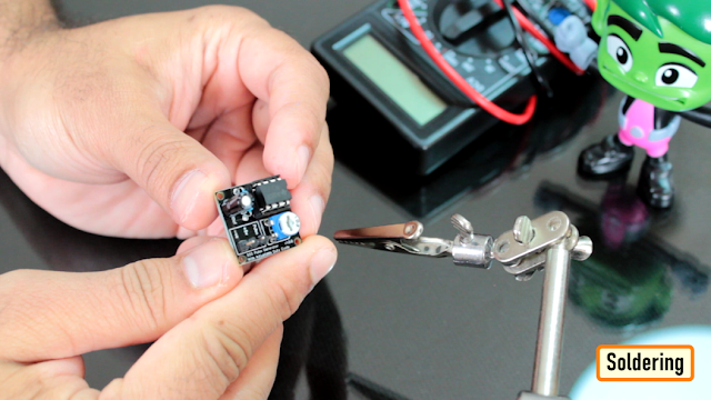

Top - Soldering Components
So, now lets start putting the components together. Lets solder the IC base followed by the 5 x NPN Transistors. Then, lets solder the 220Ω Resistors and the 10uf Capacitor to the board. I also added few pin headers to the board, 3 for the IR Sensor and 2 for the 5v power supply. The transistors are connected to the ribbon of wire which then connects to the cluster of LEDs that will slide under the top section.
Before putting the circuit into production lets do a quick test. Bang, nailed it..

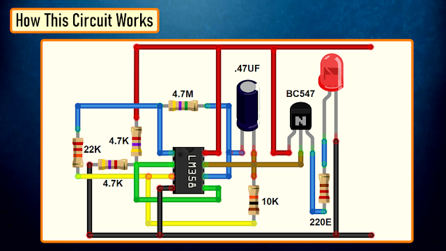

Lets first create the fader circuit without an Arduino. The base of this circuit is an operational amplifier IC named LM358. In this circuit, initially, the LED slowly glows with increasing brightness & after reaching its maximum brightness, the LED slowly dims its brightness and the process continues.Automatic Fading

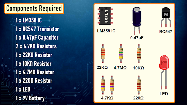

Components Required
For the Non-Arduino bit we need:- 1 x LM358 IC
- 1 x BC547 Transistor
- 1 x 0.47µF Capacitor
- 2 x 4.7KΩ Resistors
- 1 x 22KΩ Resistor
- 1 x 10KΩ Resistor
- 1 x 4.7MΩ Resistor
- 1 x 220Ω Resistor
- 1 x LED
- and a 9V Battery
How This Circuit Works
To get the fading effect we need to generate a series of triangular waves.Because of the triangular waves, the LED starts glowing slowly and then slowly dims off and the cycle continues.This setup is done using the LM358 IC. LM358 is a dual operational amplifier (Op-Amp) IC, integrated with two op-amps powered by a common power supply. Pins 1, 2, and 3 are one op-amp channel, and pins 5, 6, and 7 are the 2nd op-amp channel.As the capacitor charges and discharges the state of the PIN 3 switches from high to low and based on that the PIN 2 of the op-amp obtains the desire output. If you want to know more about this IC, please check out my "Tutorial No 21 : DIY - IR Module" : https://youtu.be/_M8FQIPi1qk.So, basically the op-amp here is used for voltage level detection. In this circuit, we are applying a voltage on positive pin (PIN-3) and the voltage to be detected is applied at negative pin (PIN-2).The transistor acts as a signal amplifier. You will need this if you are attaching a cluster of LEDs however for just 1 LED you can simply remove it.The Board

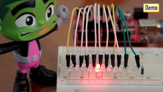

Now, I am going to repeat the same setup using an Arduino.Components Required
- For the Arduino bit we need:
- 1 x Arduino Uno/Nano (whatever is handy)
- 1 x 220 Ohm Resistor
- 10 x Red LEDs
- Few Connecting Cables
The beauty of using an Arduino is that the setup remains the same for all the previously shown circuits, the only thing that changes is the code. So, I am going to use this simple setup for the rest of the tutorial.Circuit Diagram
1. Forward Chaser
Code: The code for the forward chaser is very simple. Start by defining the constants and the global variables that will be used throughout the code.Then in the setup section define the pin modes.Now, in the loop section we are going to start by turning off all the LEDs followed by turning one LED on at a time. A counter is used to tell the loop which LED to turn on in the next cycle. Once the value of the counter reaches 10 (the maximum number of LEDs) the counter resets to 1 and the 1st LED lights up and the cycle continues.Demo: So this is how it looks like.2. Forward Reverse Chaser
Code: The code is same as the previous setup. The only thing that changes is the function that deals with the LEDs. In this setup we cycle through LED 1 to LED 10 and then reverse from LED 9 to LED 1. The counter resets when the max count is reached.Demo: So this is how it looks like.3. Left-Right Chaser
Code: The setup is exactly the same as the previous two setups. This function is the one which turns on the LEDs at the two far ends and then the one before that and likewise until they cross each other. The counter is reset when the max count is reached.Demo: So this is how it looks like.PCF8574 8-bit GPIO Port Extender

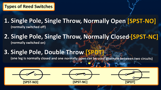

Types of Reed Switches
There are 3 basic types of Reed Switches:
1. Single Pole, Single Throw, Normally Open [SPST-NO] (normally switched off)
2. Single Pole, Single Throw, Normally Closed [SPST-NC] (normally switched on)
3. Single Pole, Double Throw [SPDT] (one leg is normally closed and one normally open can be used alternate between two circuits)
Although most reed switches have two ferromagnetic contacts, some have one contact that's ferromagnetic and one that's non-magnetic, while some like the original Elwood reed switch have three. They also vary in shapes and sizes.
