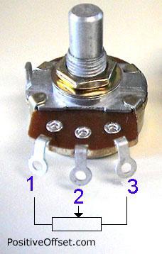

Um...Me123 Posted September 21, 2005 Report Posted September 21, 2005 I think I have things hooked up the right way now but as usual there are still problems.First hooked it up and got a steady 19V out, the pot doing nothing.Measured the ohms on the pot and it seemed pretty messed up. I think I was getting somewhere between 1k and 5k most of the time.I measured it the other way and got between 1 and 7k ohm so that seemed to be ok (is 7K normal?...on a 5K pot?). This is center tapped by the way. My output would go up just a few decimals higher than 7V and down to .1V. Shouldn't I be getting more though? Trans is 25V, half is 12.5V and doesnt the bridge give me an extra 3V (some poeple say it gives 3V some say it takes away 3V ???) Seemed ok as I adjusted it except that I could not get 6V at all. It would jump from 5V(point something) right to 7V.I'm thinking that the pot is broken because of the burning smell and buzzing noise it made a while back. :P Quote
Guest Alun Posted September 21, 2005 Report Posted September 21, 2005 Are you sure you're connecting the ptentiometer up correctly?How are you measuring its resistance?A 5k pot should measure between 4.9k and 5.1k between termials 1 and 3. Quote
audioguru Posted September 21, 2005 Report Posted September 21, 2005 He fried his pot because the LM317 was connected backwards.A pot that gives a "burning smell and a buzzing noise" is ruined. :'(His LM317 might also be ruined. :'( Quote
Um...Me123 Posted September 21, 2005 Report Posted September 21, 2005 Heres how I think I had the LM317 connected so maybe you can help me figure out if it ruined. I had the Vin wire conected to the ADJ--the ADJ wire connected to the Vout--and the Vout wire connected to the Vin. Do you know if this would ruin it and is there a way to test it? I did try it not center tapped once (25-28V) and thats when the pot fried so maybe that would fry the LM317 if the center tap didn't?ThanksP.S. This happens to everyone doesn't it? They fry their first project. Quote

Um...Me123 Posted September 21, 2005 Report Posted September 21, 2005 Never even when you were really young (or whenever you started working with electronics)! :PAnyway, through a tangle of wires I hooked up what I believe to be a test using a 220 resistor instead of a pot and got .59V not center tapped. The calculator said I should get 2.5 (on a 28V supply I think) so I'm guessing your right, the LM317 is history also. Sigh......Thanks guys. Quote
