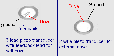

Hi Lapsap,
Just get a two-wire piezo transducer designed for external drive. Our project uses it as a microphone then drives it to make a sound.
A CD4069 inverter is just a pair of push-pull complimentary Mos transistors. It makes a pretty good linear amplifier with the negative feedback provided by the resistors from output to input. The feedback makes it self-bias, if the output DC voltage tried to be too low then it feedsback into the input which forces the output up to a voltage about half the supply voltage where its Mos transistors have the most gain. ;D

I hope this picture settles the matter. ;D
As long as you don't use a piezo buzzer with an internal driver this circuit will work. You can use either a 2 or 3 lead piezo transducer in this circuit, if you use the 3 lead variety then just connect the feedback to the drive.

I think there will be very little difference between the two, but I agree the two wire unit will be very slightly better and is a more appropriate choice. I was just pointing out that you can also use a three terminal device if it's more convenient to get hold of. ;D
