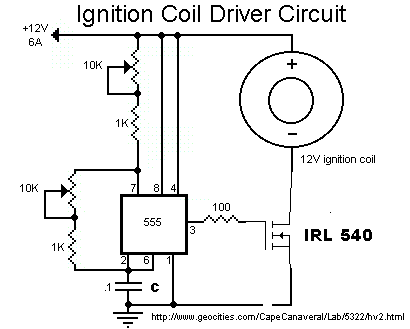

Guest Alun Posted March 3, 2005 Report Posted March 3, 2005 Hi Ante,Here is a high voltage limitation that we haven't discussed:The spark coil's core is going to saturate with a particular amount of current through its primary, which is determined by the voltage that is applied to it. Then applying more voltage than that won't make any difference to the voltage of the spark. True but won't a higher voltage cause the core to saturate more quickly thus causing a higher voltage?Once I was using a 240V to 6V transformer in reverse to generate more than 5kV from 12V. I foolishly decided to discharge a 340V 1uf capacitor though the 6V coil, it didn't cause any damage the first time as the spark gap protected the secondary from arc over but the second time it left it open circuit and the transformer secondary became short circuit.hotwaterwizard not that it makes any difference (unless you're powering this of a car cigarette lighter in acar) the +- terminals on the coil are the wrong way round. You could also make the circuit more efferent by using a power MOSFET.also try different values for C try 220nf and 47nf. Quote
steven Posted March 4, 2005 Author Report Posted March 4, 2005 :) alun thats the ignition coil driver i use and i use the irf540 n channel mosfet, and on another i used the irf740 mosfet , and with the irf740 mosfet the sound of the circuit in action is low frenqeuncy Quote
Raptor2021 Posted May 31, 2005 Report Posted May 31, 2005 I have quick question. Can an Ignition Coil Driver make a good Capacitor Charger? I'm currently working on a coil gun, and its working just fine for the exception of the charger; its just too damn slow! I used a voltage multiplier as a charger; the capacitor bank is 900v @ 4500uf. Any advice? :) Quote
steven Posted May 31, 2005 Author Report Posted May 31, 2005 :)hey raptor2021 this needs more exsperimenting , now if you havent seen my posting in the high voltage stuff section, of the high voltage photo flash capacitor charger,. it uses a disc shaped flyback transformer , without the biult in high voltage trippler , now i tried an ignition coil before useing an ignition coil driver circuit , and the same parts i used for the high voltage photo flash capacitor charger, but somehow it dident work with the ignition coil driven by the driver circuit , but if you look on the net there was a cheap coil gun that uses the photo flash capacitor charger from a camera and it had a few photo flash capacitors in parralell i think it was and that looked ok , so it would be easyer to biuld the version i biult, that uses a flyback transformer driver circuit and use that to charge a few capacitors in parralell then use that.. the disc shaped flyback and ignition coil both put out ac when driven by the driver circuits but i think it may of been the frenquency they were driven at may be the unkown facter as to why the flyback can be used and not the ignition coil , so ill try something else next time and if it works ill let you know , it would be great to have a high voltage capacitor charger useing an ignition coil ,as the 2n3055 npn power tranny would last longer that the n channel mosfet i use, because there so static sensitive they get damaged easy , so ill try when i get around to it, and this time ill use some of the parts i use in the high voltage photo flash cap charger driver circuit this time and see how it goes then Quote
Guest Alun Posted May 31, 2005 Report Posted May 31, 2005 I have quick question. Can an Ignition Coil Driver make a good Capacitor Charger? I'm currently working on a coil gun, and its working just fine for the exception of the charger; its just too damn slow! I used a voltage multiplier as a charger; the capacitor bank is 900v @ 4500uf. Any advice? :) The answer is yes you could but you'd need a diode on the output to prevent the capacitor from discharging back into the ignition coil, and you'd need another circuit to shut of the power when the capacitor voltage reaches 900V but it could be done. Quote

steven Posted November 20, 2005 Author Report Posted November 20, 2005 :)hhey raptor2021 yes you can use an ignition coil for cap chargeing view the latest posts to the topic high voltage photo flash cap chargers youll see it there Quote
steven Posted November 20, 2005 Author Report Posted November 20, 2005 :)the ignition coil driver dose have some good uses in exsperimenting with arcs and since ive come up with the simple capacitor charger in the other topic for chargeing capacitors up with by the use of the ignition coil with its ignition coil driver circuit , here is a recreation of one of my parralell ignition coil setups , i just have to put in the negative return wire electrode, these really crank out some great arcs but even better i once used a single ignition coil and i charged a cap up and dumped it into the coil and got better arcs from it, you may be able or should be able to do the same with the parralell ignition coil set up. so ill biuld another high voltage photo flash cap charger and include the coils so just switch it on to charge up and select object or pesty critter to be zapped then when ya charged the cap up just push a button and dump that charged cap into the parralell coils and fry that critter , like in the case of pesky skunks , the parralell coils ive made 2 ignition coil holders from pvc pipes for them so just run it off the simple ignition coil driver i even ran 3 coils in parralell of the same driver once Quote

audioguru Posted November 20, 2005 Report Posted November 20, 2005 Hi Steven,Can you wire the spark coils in parallel but in opposite phase, so that one produces +25,000V and the other produces -25,000V?Then you would have a long 50,000V spark jump between them.. ;D Quote
steven Posted November 20, 2005 Author Report Posted November 20, 2005 :)audo guru i get big enougth arcs when i wire them in parralell but what do you mean by opisite phase im not that familiar with that term yet. hey the voltage from the driver circuit to the coil is one thing you wait till i push a charged up cap through it like i once did with my old modified camera flash unit i added to diodes and took out the photo flash cap and put in a 350 volts 47 uf electro and charged that up and with the push of a button i discharged that into it and that was one coil at the time and even though ive ran a parralell coil of the driver and even did 3 i will biuld another ignition coil driver cap charger and do it that way charge the cap up a higher voltage and value and throw that though it for bigger arcs if possible so 2 copils in parralell would be intresting i can top those coils up some more with oil if need be i have spare coil oil around so this would be intresting to try Quote
audioguru Posted November 20, 2005 Report Posted November 20, 2005 When you parallel the coils, connect one of them with its terminals opposite the way the other one is wired to make them opposite phase. Maybe car ignition coils don't have the polarity of their primary terminals marked, so you would need to try it then reverse the connections to one of the coils to see if it makes a higher voltage between them. Quote
