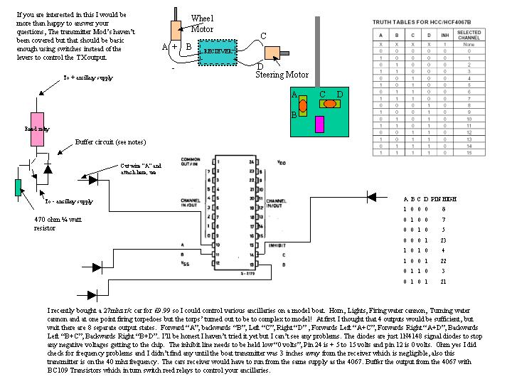

electrodoc Posted February 14, 2004 Report Share Posted February 14, 2004 would have inserted the circuit here but dunno how to do it yet so i'm affraid its a small 75k attachment.an idea i'm toying with. Quote Link to comment Share on other sites More sharing options...
electrodoc Posted March 17, 2004 Author Report Share Posted March 17, 2004 recently tried this and it works exeptionally well... i didn't bother with the diodes so i used a 4 way opto isolator due to using two seperate supplies. 12volt for the decoder and a 4.5 volt battery supply for the reciever. Quote Link to comment Share on other sites More sharing options...
