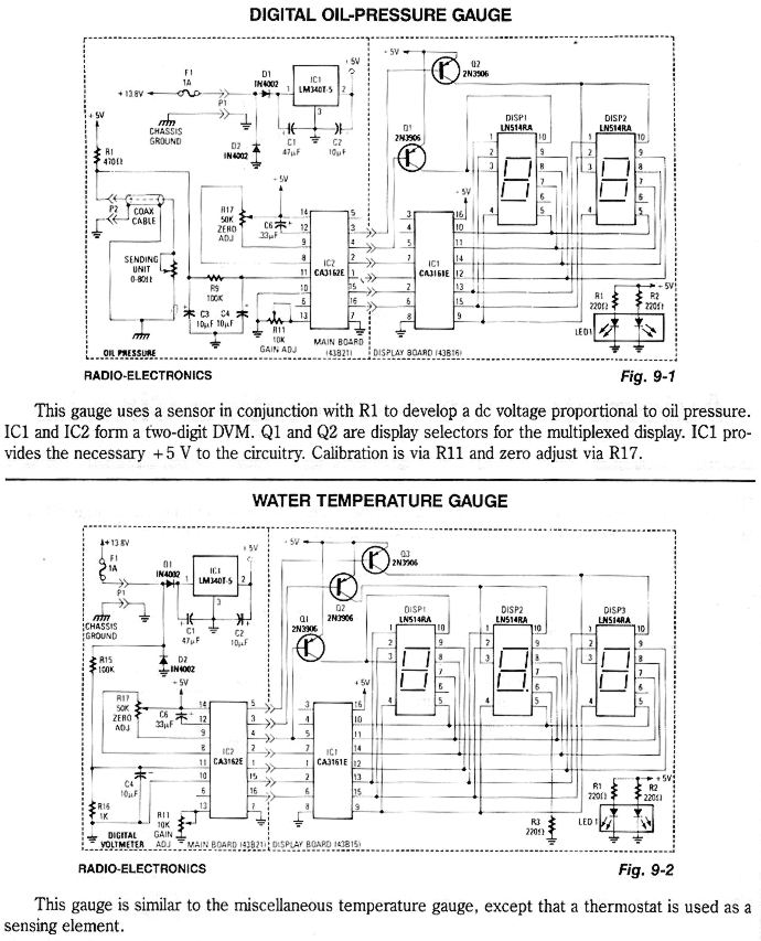

Eliminator Posted May 2, 2004 Report Share Posted May 2, 2004 Greetings all!I have a few questions, and although i can handle a sodiering iron i am by no means an expert at eletronics, but i know enough to know which end of the sodiering iron not to touch when hot!I am currently working on a project for a car.I want to read the tach/speedometer/volt/temp/oil pressure then send this information to a PC to be displayed on a graphical screen. Writing the code isn't the problem, i have C++ knowledge enough to write it. What i need is a way to convert the signals from the engine to the PC. The Transmission has a place on it for a digital signal to be sent, and the tach just uses a pulse signal, the temp i have already figured out how to do and the volt. The Oil pressure and Speedometer are the ones i am having trouble figuring out how to read. Does anyone have an ideas on what i can use/build/buy for this?? Once i get all the signals set up i'll use an interface into the Parralle port to update the PC or if i can make it wireless which would be a better idea but first things first, the signals for the speedo and oil pressure.Thanks,Eliminator Quote Link to comment Share on other sites More sharing options...
ante Posted May 2, 2004 Report Share Posted May 2, 2004 Hi,If you want accurate speed sensing I suggest you use one of the ABS sensor for this. If you don Quote Link to comment Share on other sites More sharing options...
MP Posted May 3, 2004 Report Share Posted May 3, 2004 eliminator, how are you with microprocessor chips? If you are familiar with them, then you might want to consider sending the information to the chip first, format the data in some way, then feed the data to the serial port of the PC instead. You will need other hardware to interface the parallel port to all of the different types of signals that you want. Some will be voltage levels and some will be pulses.MP Quote Link to comment Share on other sites More sharing options...

Kevin Weddle Posted May 5, 2004 Report Share Posted May 5, 2004 You certainly need an oscilloscope to determine how the siganal is changing. It might vary the pulse width(duty cycle), the pulse time, or the pulse amplitude. This is going to require a more complicated matching circuit. I would consult an electronics guy to develop the circuit. Quote Link to comment Share on other sites More sharing options...

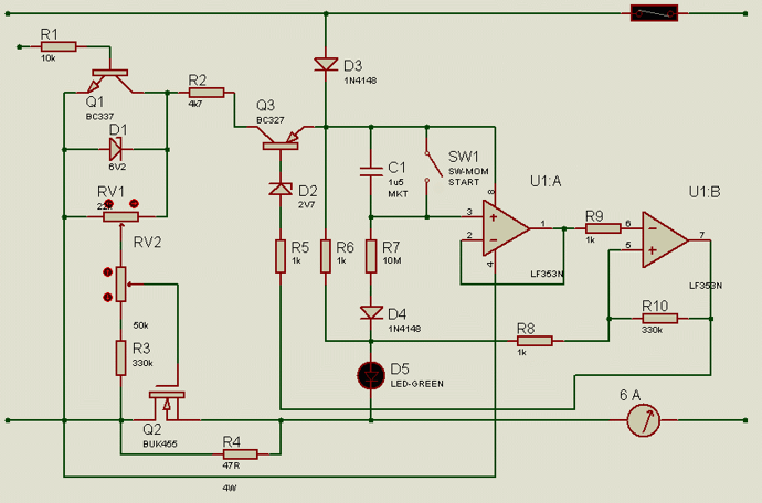

ante Posted May 9, 2004 Report Share Posted May 9, 2004 hotwaterwizard,Here is an example grabbed from one of my projects: Ante ::) Quote Link to comment Share on other sites More sharing options...
audioguru Posted May 9, 2004 Report Share Posted May 9, 2004 Ante,That's a good comparison, they both look almost the same, even with nearly 3:1 compression.What program do you use to convert GIF to JPG?Will it also convert BMP (huge file) to JPG? Quote Link to comment Share on other sites More sharing options...
ante Posted May 9, 2004 Report Share Posted May 9, 2004 I make a screen dump from ISIS to Photoshop and save as GIF and JPG. And the quality is definitely better in the GIF. Ante ::) Quote Link to comment Share on other sites More sharing options...
