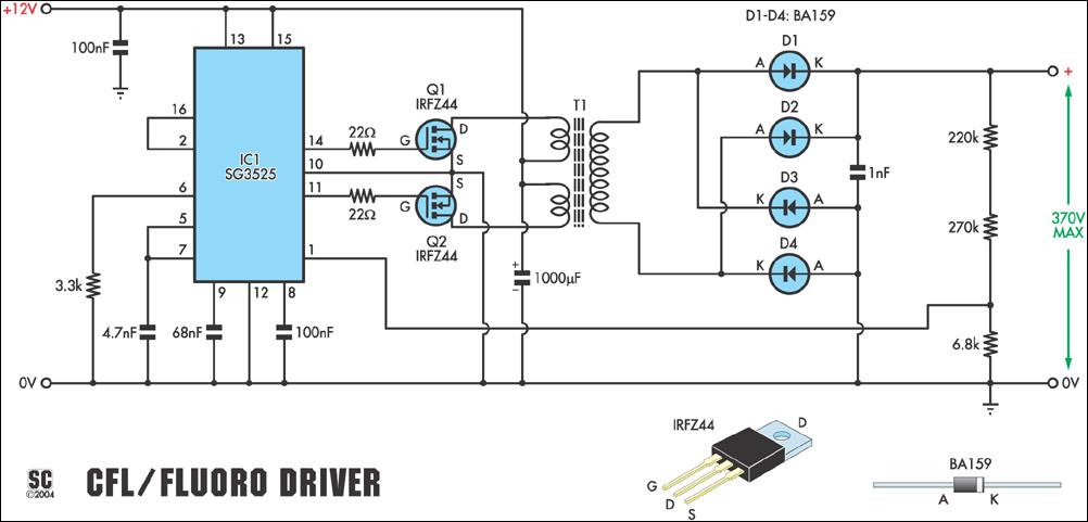

Hi Rhonn,
Ferrite is used only for high frequency transformers, isn't it?
You are right John..at 85kHz on this circuit. I'm planning to install it directly inside a 14" colored tv..
Link to comment
Share on other sites
Guest Kasamiko
That 370 VDC will be tapped directly to TV's main filter capacitor, 220uF/450VDC..then goes on TV regulator for 115VDC output for the rest of the circuit.. ;D

Guest Alun
rhonn  ;) ;)
You could increase the efficenciey by bypassing the TV's internal regulator, modifying your circuit to give 115VDC and using it instead of the internal regulator. Doing this you could save quite a few watts.

Guest Kasamiko
It's a good idea but then it will render the AC/DC function of the tv useless.. :P

Guest Alun
So you wan to be still be able to run this TV of the mains as well as a battery.
You could just use a switch and mount you inverter circuit somewhere on the inside of the TV's cas,  then add a switch to change it from mains to battery mode. In battery mode the TV's internal regulator will be bypassed and in mains mode it won't be. This would give you the best of both worlds.

can pls teach me how to calculate for the CD4047 and the MM5389 to get 50hz output??
The calculation for the frequency of a CD4047 oscillator is shown in its datasheet. It is used as a 50Hz or 60Hz oscillator in our 500W inverter project and here is the corrected schematic of its oscillator.

The circuit you posted with a linear sine-wave from Mosfets uses an XR-2206 function generator IC to make the sine-wave, not a square-wave. I don't think the XR-2206 is made anymore.
The 500W square-wave inverter project on this site uses a Cmos CD4047 IC to make the square-wave. It has a Cmos oscillator, a digital divider to make a perfect 50:50 square-wave, a direct output and an inverted output.
