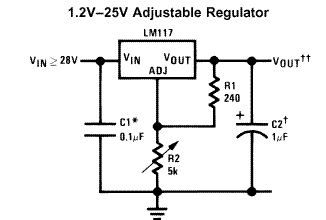

shekhar_dandya Posted January 1, 2005 Report Share Posted January 1, 2005 Hi All,A Happy 2005.I recently made a small adjustable power supply with a voltage range from 3V to 24V and a current range of 1A using the rectifier-filter-LM317 combination.I tested its outpput on a multimeter with its knob on"DC V" and it showed me the correct voltages.Then I turned the knob on "AC V" and found that it showed me an ac voltage of 56V! at the o/p of LM317.It also shows some 11V DC at the o/p of secondary (Knob kept on DC V) and a 71V AC at the filter(Knob kept on AC V).Should'nt the o/p of LM317 show 0V AC or atmost a few mV AC(The ripple)?Why am I getting a DC voltage at the o/p of secondary?despite the "AC V" shows the correct RMS value of 24V(RMS secondary).Due to lack of a CRO I cannot view the waveforms and have to rely on my DMM.is it faulty?It is not a true RMS meter.I guess it is directly coupled inside for ac voltages.I have used a capacitor of 3300uF and tests are carried out in no load condition.Is this making any difference?maybe the cap is not discharged?Thanks-Shekhar Quote Link to comment Share on other sites More sharing options...

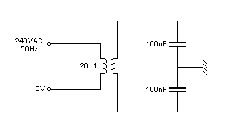

Guest Alun Posted January 2, 2005 Report Share Posted January 2, 2005 This could be some voltage getting through the interwinding capacitance of the mains transformer, try earth bonding the output, or you could connect a 100nf capacitor to protective earth on either side of the secondary on the mains transformer.I've had a similar problem before when I used an antique mains transformer, I held one leg of a neon lamp and connect the other to the transformer and it glowed dimly. I connected all of the windings to earth via capacitors and bingo Quote Link to comment Share on other sites More sharing options...

shekhar_dandya Posted January 5, 2005 Author Report Share Posted January 5, 2005 Hi Alun,I am trying to solve the problem as you told in the image.But by mistake I bought 100uF caps.could they help or should I strictly connect 100nF caps?Exactly what is the theory behind earthing the interwinding capacitance?how about using resistors instead of caps?do the caps form a certain kind of tuning circuit with the secondary windings?If so what effect does it have at 50 Hz?-Shekhar Quote Link to comment Share on other sites More sharing options...

Guest Alun Posted January 8, 2005 Report Share Posted January 8, 2005 Hi Alun,I am trying to solve the problem as you told in the image.But by mistake I bought 100uF caps.could they help or should I strictly connect 100nF caps?The value isn't critical, I would suggest trying anything between 10nf and 1 Quote Link to comment Share on other sites More sharing options...
ante Posted January 8, 2005 Report Share Posted January 8, 2005 Hi Alun,There is a big difference between 100nF and 100uF and I suspect that they are electrolytic caps. A current will flow through these caps at 50Hz and you state that the value is not critical well I think it is. 8) Quote Link to comment Share on other sites More sharing options...
Guest Alun Posted January 8, 2005 Report Share Posted January 8, 2005 Ante,I mean non-critical in that they don't have to be exactly 100nf. I did mention that 100 Quote Link to comment Share on other sites More sharing options...

shekhar_dandya Posted January 22, 2005 Author Report Share Posted January 22, 2005 Hi everyone,Well I did not require to use caps to earth for secondary.Its not showing any dc voltage now.But at the o/p I still get 6V ac when dc o/p is 3V and 56V ac when dc o/p is 25V(both no load.).Also the conditions did not improove with a load of 330 ohm resistor as a load.when the DMM connections are reversed(i.e +ve lead to -ve of 317 and -ve lead to +ve of 317)I am still getting 0V.(Whereas I expect at least a -ve voltage).Can this be due to bad soldering? My soldering is horrible.I don't have a scanner to show you people.The dc voltage between o/p and adj pins is 1.25Vdc.When measured with DMM knob kept on ac it reads 2.2V.Again,with the DMM leads polarity reversed it reads 0V.The dc o/p at the i/p of 317 ie across the filter capacitor is 31Vdc.when measured with knob kept on ac it reads almost 68V.Again the same thing ,you reverse the connections and it reads 0V.Somewhere in the ongoing thread Suraj said :Check your multimeter. If you are measuring DC voltage on AC range some multimeters display double the Value (this was true with older analog ones). .COuld this be the case with DMM's?Help needed.Thanks-Shekhar Quote Link to comment Share on other sites More sharing options...

shekhar_dandya Posted January 22, 2005 Author Report Share Posted January 22, 2005 Hi Kevin,I am using a TO 220 package and have connected pins properly.I have no problems with d.c.How does 317 ener voltage follower mode ?I have used a 240 ohm resistor from o/p tp adj and a 330ohm in series with a pot of 4.2K from adj to ground.I have also pput a 10uF cap at the o/p to reduce the ripple.Can I just neglect this thing happening for practical applications? I heard that people making adapters(ac-dc converters) do not bother to use a regulator as well.Am I expecting too much from my cheap circuit?more help needed.-Shekhar Quote Link to comment Share on other sites More sharing options...
