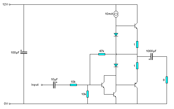

My question:
How do I calculate the value of Rbias in this class AB amplifier?
I thought it would be self biasing but the DC output level is far too low and this severely reduces the output drive capability.

Hi Alun,
Ibias needs to have a low voltage drop for it to turn-on Tr3 fully when the output swings high. Frequently a bootstrap arrangement drives Ibias higher than the supply voltage (with a capacitor from the output) for a good output swing.
Maybe Ibias has too much voltage drop or maybe you can't adjust Rbias for a half-supply voltage at the output because Tr2 leaks and needs a base-emitter resistor.  ???

Thanks audioguru,
I've tried a BJT with a zener for Ibias but is wasn't very good so I used a JUGFET with the gate joined to the source as a current source and it worked. I've managed now to get it to work quite well I got 6Vp-p from a 9V supply.
The problem is I had to mess around adjusting the value of Rbais to get it to work and when I change the gain I need to mess around with adjusting Rbais. I want to know if there is an easy way to calculate its value using the other resistor values and transistor betas?
Oh by the way here's a copy of the schematic with the values I used.

Hi Alun,
You are severely straining your poor little output transistors that have an absolute max current rating of only 100mA.
To get 6Vp-p into your 8 ohm load, each output transistor will have a peak collector (emitter) current of 375mA. You are lucky they survived and their hFE drops like a rock above about 50mA.

Hi Alun,
Yes the transistors did get quite warm, I'll replace them with more chuncky ones.
The open loop gain probably stayed quite high at the high output current because the darlington gives the circuit it's very high gain (>20,000) not the output transistors that carry the load current.
I think I've solved my problem of claculating Rbais.
If the we want the DC output voltage to be half the supply and the voltage across Rbias will always be the Rb (voltage of the darlington) then we have a potential divider consisting of Rf and Rbias.
The value given from the formula is not too different from the value I used, the differences are probebly due to the voltage drop of Ibias and the current taken by the darlington. I might try one of those proper constant current diodes and see if it's any better.
What do you think about removing Re and adding a 22ohm resistor between D1 and D2 to keep the baising the same and reduce the output impedance furter?

Hi Alun,
Good, but chunky transistors have less gain so Ibias will need to be higher.
Yes, Rbias is in a voltage divider with Rf.
Have you seen the high cost of those things? All they are is a FET with a gate-source short like you have now. Try a couple of bootstrap resistors with a cap.
What do you think about removing Re and adding a 22ohm resistor between D1 and D2 to keep the biasing the same and reduce the output impedance further?
Guaranteed thermal runaway of the output transistors! The negative feedback already makes the amp's output impedance extremely low. If you load the output and its voltage swing tries to drop, the negative feedback tells the open-loop gain, "Oh yeah? C'mon gain, help out!"  ;D

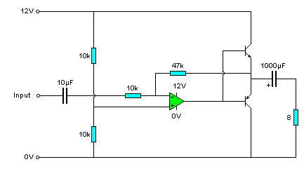

Well if I use BC546Cs for the darlington the gain would be a whopping 176,400 to 640,000, which beats the uA741's 20,000 to 200,000, but it will be never a good as the OPA134's gain of 1000,000. ;D
How does making a darlington pair affect the bandwidth?
The BC546C has an Ft of 300MHz, would this stay the same?
If this is the case then the circuit might have an open-loop gain of say 200,000 at 1Hz and 1 at 300MHz.
About your idea to use an op-amp, are you sure it will be able to provide enough current to drive the complementary pair at large output swings?

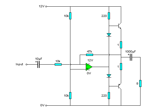

Hi Alun,
An Englishman named John Linsey Hood developed a "Liniac" small amp in the 70's. It used a darlington and current source for extremely high gain and very low distortion with negative feedback. He reported that the darlington multiplied its own small capacitance and it created a low frequency pole when it combined with the high impedance load. Therefore its frequency response was limited and he used it in single-frequency oscillators.
You might be able to find the article in a library archive of Wireless World magazine.
Is there any chance it looked similar to my circuit? ;D
Your darlington has a current gain very high but its voltage gain won't be as much. With its high impedance load its response will rolloff at a fairly low frequency.
Is this because the parasitic capacitences are multiplyed too?
But hang on a second, if the both the gains and capacitences are multiplyed then won't this cancel out?
If an amplifier has a 6bB roll of caused by a capacitor, and we multiply its gain by 100 and the capacitor's value by 100 then the unity gain bandwidth should remain the same. This makes sense to me as the MPSA14 has an Ft 0f 125MHz.
The Ft of a transistor is the frequency that its voltage gain is only one, like a piece of wire. So in theory, a 300MHz transistor has a gain of 10,000 at 30kHz. In practice, you'd be lucky to get a gain of 50, a darlington might have a voltage gain of 2500 at 6kHz.
??? you must be mistaken, I've never seen a single transistor with such a high gain even at DC, unless you're talking about a darlington of course.
Using an opamp for gain, you would need voltage-wasting darlingtons or a compound PNP-NPN complimentary pair as output current amplifiers for about 50W into 4 ohms or 30W into 8 ohms. For just a few watts and a 12V battery, a single pair of BD135/BD136 would be fine.  ;D
What do you think of these circuits?
I don't like the first as I doubt the op-amp will have a high enough gain to get rid of the crossover distortion under load, I prefer the second as there shouldn't be any crossover distortion in the first place.

Hi Alun,
In 1980, telephone interconnect came to Canada and the sound systems company I worked for decided to sell and install phone systems. Instead of selling the same ones as other companies they decided on a phone system from a little-known Korean company called Goldstar (now called LG Electronics). It had the worst pcbs and soldering that I have ever seen! The phones were all speakerphones and had the same amp circuit as your 1st one, except with much more gain (and therefore much less negative feedback).
They had terrible crossover distortion! I had to go around and add a resistor to the circuit to let the opamp drive the load for low signals but only the ones customers complained about. I would modify a few in one company and they called back the next week requesting the rest also be done. Whew, lotsa work! :o
I have modified your 1st circuit including the resistor at the output transistors. I also changed the circuit around so it has more gain for use with a CD player or tuner. More gain reduces its tendency to oscillate. I didn't use inverting like you did so that its input impedance wouldn't be too low or its neg feedback resistor be too high (phase shift).
Your 2nd circuit has the opamp driving the output transistors and their 220 ohm biasing resistors. An opamp doesn't have enough output current to do both.  ;D

Nice circuit audioguru.
How did you calculate the values you used?
What do the extra capacitors do?
That 68ohm resistor is connected accros from the input to the output of the complementary pair, as it's non-inverting this will give posative feedback could this lead to oscilation or even latchup?

Hi Alun,
My circuit has proper negative feedback, the transistors don't invert, they are just followers.
I very carefully matched the 39k feedback resistor to the 33k in series with the two paralleled 10k resistors so any high input current opamp can be used without offset voltage.
I also carefully matched the 20Hz rolloff of your 1000uF output cap into the 8 ohm load with the 1.5k resistor and 4.7uF cap, and the 0.22uF input cap with the 33k reference resistor. There is a trick about matching the 3 capacitors so that the amp produces a perfect square wave without tilt at low frequencies. Now I think the 4.7uF should be about 2.2uF for that to occur. Try it, changing the cap changes the tilt (overall phase shift).
Oh, oh! Both you and I forgot to include a supply bypass cap.  ;D
The 47uF cap should fully-charge (98%) by the two 10k resistors in about 1.2 seconds for good filtering.
The gain is 1 plus (39k divided by 1.5k) so a 100mV input gives a 2.7V output (about 7.6Vp-p).
The opamp drives the load through the 68 ohm resistor until 10.3mA flowsand the resulting 0.7V turns on the transistors.

So the 68ohm resistor is to get rid of the cross-over distortion my concern was that because the complementry pair has a gain of 1 the resistor would give positive feedback and lead to latch or oscillation why won't this happen?
Yes it does need a capacitor across the supply, 100uf should do.
Thanks for explaining it so well, I'll build this when I get the time.

Hi Alun,
The complimentary emitter-followers won't oscillate due to positive feedback into them through the 68 ohm resistor:
1) An emitter-follower isn't perfect so will have a max voltage gain of maybe 0.95 with a low resistance load. It is less than 1.0 so it can't oscillate.
2) The open-loop output impedance of the opamp is between 10 ohms and 100 ohms depending on which opamp. Its output impedance forms a voltage divider with the 68 ohm resistor further reducing positive voltage feedback through the 68 ohm resistor.
I haven't tried it for many years but I remember my little amplifier performing very well:
1) The output transistors can't have thermal runaway since the 68 ohm resistor bypasses any base leakage current.
2) Very high output voltage swing since the transistors don't have emitter resistors.
3) Very low crossover distortion since the opamp drives the load until the current allows the output transistors to be fairly linear.
4) Extremely low idle current since the output transistors are turned off.  ;D
