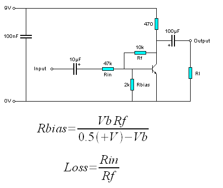

Guest Alun Posted April 30, 2005 Report Posted April 30, 2005 The good thing about transistor attenuators is the output impedance is very low and unaffected by the load unlike a potential divider. Quote
audioguru Posted April 30, 2005 Report Posted April 30, 2005 I think the gain/loss is a lot more complicated:1) Much of the input current through the 47k resistor is dumped in Rbias.2) The input impedance of a transistor without an emitter resistance is fairly low so also attenuates the current through the 47k input resistor.3) In addition to current gain, the transistor has some voltage gain (same thing?).4) The feedback resistor feeds current into the 47k input resistor to cancel some of it, into Rbias, and into the low input impedance of the transistor.I just finished doing my daughter's income tax so I don't want to calculate anything more.A perfect application for a smart sim program or actual bench testing! ;DAn inverting opamp circuit is much easier to figure its gain/loss. Quote
Guest Alun Posted April 30, 2005 Report Posted April 30, 2005 Yes audioguru an op-amp would be much better.The the current though Rf cancels out the low emitter impedance and Rbias this is an example of how negative feedback increases the input impedance. I've done a quick simulation and the loss is just under Rin/Rf, if you increased the open-loop gain by using a darlington or constant current collector load or even both then the loss would be damn near Rin/Rf. Quote
audioguru Posted April 30, 2005 Report Posted April 30, 2005 this is an example of how negative feedback increases the input impedance.Hi Alun,You mean the negative feedback decreases the input impedance, don't you?The input of the transistor is approaching being a virtural ground. I think that the input impedance is very close to the value of the 47k input resistor.Is your sim program any good? Frequently they screw-up on complicated issues like this one. ;D Quote
Guest Alun Posted May 1, 2005 Report Posted May 1, 2005 audioguru,At DC the current through Rf if added to the input current therefore increasing the input impedance this is why Rbias makes very little difference since the base has a very low impedence anyway and 700mV across 2K issn't going to cause much current to flow, and yes you're right the input impedance will be about the value of Rin. This circuit is a lot better than a potential divider but nowhere neard as good as an ap-amp. Quote
audioguru Posted May 1, 2005 Report Posted May 1, 2005 Hi Alun,Never mind the DC current, the thing is cap-coupled.The junction of the input resistor and the feedback resistor is a low impedance point at AC because as the input swings positive, the output swings negative and vice-versa. Therefore the junction is a virtural-ground like the inverting input pin on an inverting opamp amp. ;D Quote

Guest Alun Posted May 2, 2005 Report Posted May 2, 2005 Oh sorry of course -1uV with 1V input because it's inverting silly me.;D Rf is providing feedback, some of the output is fed back to the input and as it's an inverting amplifier the output will be opposite to the input and cancel it out to some extent, hence the feedback is negative, the ratio of Rf and Rin deturmines the amout of negative feedback.The principle is the same with my transistors circuit, the base is always near ground at 700mV and the transistor has a gain of about 100, Rf and Rin reduce it to 10/47, the transisto has a lower gain than the op-amp so in practice the gain will be a bit below 10/47. Quote
