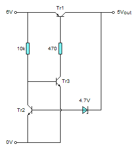

Here''s a low dropout regulator I designd a while ago, it was designed for low power useage (<100mA) and I've never needed to build it. I have a feeling it will form an oscilator as it's effectively  a 3 stage high gain amplifier, does anyone here know how to compensate it properly to prevent oscilation?

Yes but this is more of an experiment more than anything else, besides it's cheaper than an LM2931-5. ;D a MOSFET would work very well in fact because it's on resistance is so low the dropout voltage might be even lower than the LM2931-5.
Oscillation might still be a problem though, I wonder if a capacitor on the output would get rid of it or whether I should add other compensation capacitors between the different stages.

I've built my circuit and it works very well, I added a 100n and 100uf capacitor on the output and a 100uf on thie input. I didn't use any other compensation capacitors since the transistors aren't passing much current their gain is too low for oscilation and the 100uf & 100nf on the output did their job very well. I needed to add a 620ohm resistor from Tr's base to ground because there was too little current flowing though the zener to establish a sizable voltage drop across it, with a 4.3V zener the output was only 2.4V, I used a 5.1V one in the end to give 5.6V.
Both circuits will have a dropout voltage = Ron * current (Ron = MOSFET on resistance) but yours will be better as N channel MOSFETS generly have a lower on resistance. Your circuit might be able to be improved by using an op-amp and a precision voltage reference.
