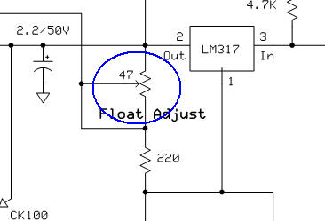

Guest Kasamiko Posted April 23, 2006 Report Share Posted April 23, 2006 Here is the charger, we assembled this circuit seperatly for charging 12V 250AH battery with a current of 30A max (15.1V). set the float current 1A we used a stack of eight 2N3055 transisters with 0.1ohm 10watt emitter resistorSasi,I just cant find a 47 Ohms trimmer used for FLOAT adjustment for this charger..the lowest value available in our place is 100 Ohms..Any idea how can I modify it to used 100 Ohms trimmer?See attached image below..Thanksrhonn ;) ;) Quote Link to comment Share on other sites More sharing options...
