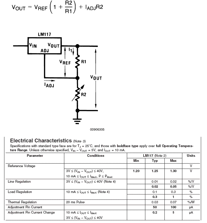

Guest Alun Posted October 2, 2005 Report Posted October 2, 2005 You about using the LM317 instead? It has better ripple rejection and better regulation than its fixed counterparts.Look, I'll even re-arange the formula for you. ;D Quote

Guest Alun Posted October 2, 2005 Report Posted October 2, 2005 Less parts is simpler, OK? A pot costs more than a diode where I livePots? ;DWhy would you need to use a pot? I know the circuit suggests one, but if you substitute it for an ordinary fixed resistor then it'll work a treat - just put the numbers in to the formula to get the value. But this is splitting hairs, don Quote

V8meathead Posted October 24, 2005 Report Posted October 24, 2005 Alun: I kind of understand how you got your equation. I don't really get the concept behind it setting the Iadj*R2 = 0. Could you explain this in more detail? Quote
Guest Alun Posted October 24, 2005 Report Posted October 24, 2005 If you look at the datasheet you'll find that the IADJ is only 100uA maximum so will make very little differance to the output.For example:We want a 20V regulator so using my formula:R1 = 240VOUT = 20R2 = 240(20/1.25 - 1) = 3600 = 3k6.Now lets put that back into the origional formula to see what the actual voltage will be:VOUT = 1.25(1+3600/240)+100*10-6*3600 = 20.36VSo we're only 360mV out, from the datasheet VREF can vary from 1.2V to 1.3V and this will make far more differance than IADJ. Try calculating the values of VOUT at both extreems of RREF to see for yourself. ;D Quote

Guest Alun Posted October 24, 2005 Report Posted October 24, 2005 You can also minimize the effect of IADJ by making R2 smaller but to do this R1 needs to be proportionally smaller, if you make R1 120R and R2 1k8 then the ideal output voltage will be 20.18V. The bad thing about this is the lower resistor values will increase the quesent current which will now be 10.42mA instead of 5.21mA. Quote
audioguru Posted October 25, 2005 Report Posted October 25, 2005 The more expensive LM117 uses 240 ohms for R1, the cheaper LM317 is supposed to use 120 ohms. Its current holds down the output voltage without any other load. Quote
Guest Alun Posted October 25, 2005 Report Posted October 25, 2005 I'vejust noticed I posted the LM117 section instead of the LM317 section but this doesn't make any differance here as IADJ is the same for both. I didn't know that R2 is supposed to be 120ohms for the LM317 I've always used 240 and had no problems at all. I understand that R2 provides the minimum load current and with the LM317 it's 10mA maximum and 3.5mA minimum so I must've been lucky. Hang on the only project I've built that doesn't have a minimum load anyway was my LM217 power supply and the LM217 specifies 5mA so I was alright anyway.This wasn't my point though my point was that using smaller values of R2 reduces the IADJ error, but to do this you need to reduce R1 by the same factor. In theory if R2 was 9k ato get 20V R1 would need to be 60R so the real output voltage would be 20.09V, however as I said before this doesn't matter as the error caused by VREF is far greater. Quote
MP Posted November 7, 2005 Report Posted November 7, 2005 The data sheet does not specify a resistor (R1) between Vout and Vref for either LM117 or LM317. The resistors used in the various examples are just that. "Examples". The formula is Vout=1.25V(1+R2/R1)+Iadj(R2). MP Quote
audioguru Posted November 7, 2005 Report Posted November 7, 2005 The data sheet does not specify a resistor (R1) between Vout and Vref for either LM117 or LM317. Alun is correct. The minimum load current rating for a premium LM117 is 5mA. The R1 value is calculated 1.25V/5mA= 250 ohms. 240 ohms is the closest 5% resistor value and is shown in the application circuit on the 1st page of the datasheet. The cheaper LM317 has a min load current rating of 10mA, so needs a 120 ohm resistor to hold down the output voltage to the regulated voltage without any other load.The minimum load current is spec'd with a voltage from input to output of 40V and is lower with lower voltages. The datasheet shows a curve of a typical load current being half with 10V from input to output when it is hot. ;D Quote
