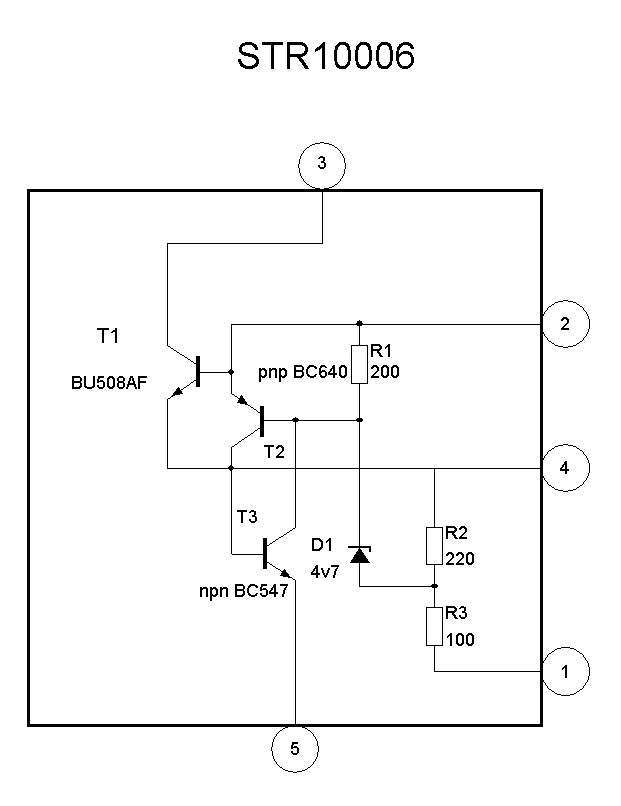

Guest AngeloFranca Posted February 10, 2006 Report Share Posted February 10, 2006 Hi everybody,i'm going creasy to find out the datasheet of this IC:str17006it's a voltage regulator from sunken.I hope you can help me.Thank you Quote Link to comment Share on other sites More sharing options...
hotwaterwizard Posted February 11, 2006 Report Share Posted February 11, 2006 I found a Schematic.STR17006_Schematic.pdf Quote Link to comment Share on other sites More sharing options...
Guest AngeloFranca Posted February 13, 2006 Report Share Posted February 13, 2006 Thank you! It's better than nothing. Almost i can guess how to connect the IC.Where did you find it? Quote Link to comment Share on other sites More sharing options...
hotwaterwizard Posted February 13, 2006 Report Share Posted February 13, 2006 I have this too. Numbers are not the same but closeSTR10006_Replacement_Spanish.pdf Quote Link to comment Share on other sites More sharing options...
