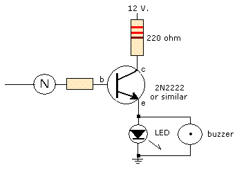

I have a wire that will go positive with around 12V under certain conditions (when a que is being tested)  I have a 12V LED assembly (before i knew how to use resistors) and a 12V buzzer that are suppose to light up/sound.  In series the buzzer doesnt work well due to the resistor in the LED.
Parallel won't work will it?
Ok so if I connect a transistor to it like this, will it work?:
the negative side of the led to the base
A 12V supply (not within this circuit) to the collector and
the positive of the buzzer to the emitter
To me this would work but no one has really yet told me if I have the correct understanding--just everything wrong with making an IR signal go around a corner!! (should not be that hard!!)
thnx

If you connect the 12V LED to a 12V battery then it lights.
If you connect a 12V buzzer to a 12V battery then it buzzes.
If you connect the LED and the buzzer to the battery then they are in parallel aren't they?
Why connect an LED to the base of a transistor? The LED doesn't turn itself on and off unless it is a flashing LED.
Where is the anode of the LED connected?
Where is the negative of the 12V connected?
Is the transistor an NPN or a PNP?
Make a sketch of your circuit design in MS Paint or something so you can see all the things in it that aren't connected to anything.

You don't want the transistor switch as an emitter follower. It switches better when it is a common emitter stage.
My transistor switches the LED with its resistor and the buzzer to the 12V battery. They are in parallel.

Hi Um...Me,
Q1 doesn't have a base current-limiting resistor so it will fry. Q1 is not needed.
The LED also doesn't have a current-limiting resistor so it will also fry.
The relay coil makes a very high voltage when it is turned off because it is an inductor. The high voltage will destroy Q2 unless you add a reversed biased diode across the coil.
The 2 supplies must have their grounds connected together.

Actually, your transistors are connected as emitter-followers and don't need a base resistor. If the emitter is grounded and the load is between the collector and positive supply then the base would need a series resistor to limit its current.
With a 12V supply, a 1 ohm resistor would limit the base current to 12V - 0.7V= 11.3V/1= 11.3A. Transistors have current gain so a little 2N3904 can have a 200mA load at its collector and only 1mA to 10mA at its base will turn it on.
