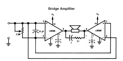

zak4000 Posted June 11, 2006 Report Share Posted June 11, 2006 Can someone design a PCB for this schematic?? (The dotted cap. is ment to be a 10uF elec. with a dual pot. in series (one for each amp) for the gain and the 2.5M is the volume) The amp type i'll be using is the LM380N. ThanksLM380_2.5W_Amp..pdf Quote Link to comment Share on other sites More sharing options...
windoze killa Posted June 12, 2006 Report Share Posted June 12, 2006 Can someone design a PCB for this schematic?? (The dotted cap. is ment to be a 10uF elec. with a dual pot. in series (one for each amp) and to be connected to pin 1 not ground and the 2.5M is the volume) The amp type i'll be using is the LM380N. ThanksThis seems a very simple design. Why not have a go at it yourself? There are plenty of progs out there to help you. Quote Link to comment Share on other sites More sharing options...
zak4000 Posted June 15, 2006 Author Report Share Posted June 15, 2006 I've designed this using PCB Wizard v2.0, will there be any loop/feedback things?? I havn't mirrored the text yet. :) Quote Link to comment Share on other sites More sharing options...

MP Posted June 17, 2006 Report Share Posted June 17, 2006 Zak, it looks good. Nice ground plane and the traces look like they are far enough apart so that they will not cause interference.I was not able to check your schematic against the board layout, but the layout itself looks well done.MP Quote Link to comment Share on other sites More sharing options...
zak4000 Posted June 19, 2006 Author Report Share Posted June 19, 2006 Just an update on the design, the dual pot isn't ment to be there - i was getting mixed up with the LM386 that has a veriable gain :-[ Quote Link to comment Share on other sites More sharing options...
