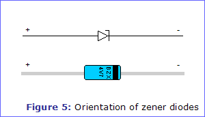

audioguru Posted January 11, 2006 Report Share Posted January 11, 2006 Did the circuit make about -5.6V? If it was much less then Q1 will turn on when it shouldn't. Quote Link to comment Share on other sites More sharing options...
Tedy Posted January 11, 2006 Report Share Posted January 11, 2006 Voltage across D7 is 0.71V :o Quote Link to comment Share on other sites More sharing options...
audioguru Posted January 11, 2006 Report Share Posted January 11, 2006 Isn't D7 installed backwards? Quote Link to comment Share on other sites More sharing options...
Tedy Posted January 11, 2006 Report Share Posted January 11, 2006 that colored ring is pointing to ground (0V) ???Here are some more measurments on -5.6V elements:Ud5=266mVUr2=0VUd6=420mVUr3=5mVUr14=-220mV (common of instrument was on Q1 base)Uc2=40V (common of instrument was on negative of cap.)Uc3=650mV (common of instrument was on negative of cap.) Quote Link to comment Share on other sites More sharing options...
audioguru Posted January 12, 2006 Report Share Posted January 12, 2006 Hi Tedy,Your Zener dagram is confusing. It shows the polarity of ordinary diodes, not zener diodes.Your D7 is installed correctly. D5 also has its cathode to ground.Your lowest voltage is at C3, maybe it is shorted.Do you have a 4-diode full-wave-bridge rectifier for D1 to D4?Is the transformer's terminal #2 on my sketch accidently grounded? Quote Link to comment Share on other sites More sharing options...
Tedy Posted January 12, 2006 Report Share Posted January 12, 2006 HiI have checked C3 and it is not shorted, yes I have 4 rectifier diodes.My D5 is also installed corectly.Transformers terminal #2 is not grounded. Quote Link to comment Share on other sites More sharing options...
audioguru Posted January 12, 2006 Report Share Posted January 12, 2006 Well, there isn't much remaining:R2 or C2 are open or the wrong value.D5 or D6 not working or backwards.Shorted diode in the bridge rectifier.Broken trace or shorted traces on the pcb.??? Quote Link to comment Share on other sites More sharing options...
Tedy Posted January 12, 2006 Report Share Posted January 12, 2006 Shorted diode in the bridge rectifier.That was it, thanks ;DIt was cold joint at D1 :-[ Quote Link to comment Share on other sites More sharing options...
