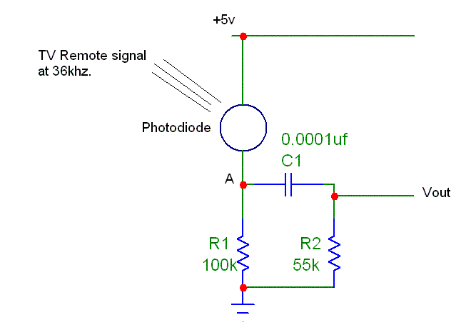

Hi,
As an aside (should i start this as a new post ?) i came across high pass filters while doing some research. Sounds interesting and i came up with the attached circuit as a possible filter.
I believe that most remote controls use a frequency of about 36khz and based on this ive selected the values of the capacitor and R2 so that it attenuates all frequencies below 30Khz.
Are these calculations correct? I dont think so as i dont get any voltage when a remote button is pressed. Vout remains at zero.
Any ideas?

Hi Axle,
The filter is still part of your IR receiver so keep it in this same post.
The 0.0001uF capacitor and 55k resistor make a highpass filter with a cutoff frequency of 29,090Hz when it has a very high impedance load. It is very simple so will have a very gradual cutoff slope, 14.5kHz will be reduced to half, 7.3kHz will be reduced to 1/4 and 3.7kHz will be reduced to 1/8th, etc.
It doesn't pass DC through the capacitor so the transistor at its output will do nearly nothing. If the transistor is biased correctly with a DC voltage divider then the divider will load-dwn the filter and the photo-diode. You would need to rectify the resulting high frequency output to measure an output anyway.

Hey,
Thanks for the info. Unfortunately these modules arent available here in South Africa. Ive tried quite a few electronics shops and the closest thing they have is the two pin photodiode im using. :(
Im stumped at the moment as im not connecting the filter to anything, im just checking the ouput voltage (Vout) relative to ground and i still get a zero reading on my multimeter. If my calculations are fine then surely when i hold the remote close to the photodiode i should get some reading across R2?

Don't you have modern TVs and VCRs and parts for them in South Africa? Don't people throw them away and you can remove their parts?
Modern remotes send an IR beam in bursts of 38kHz pulses. The output of your filter will have 38kHz pulses with a high impedance. Do you have an oscilloscope or high frequency milli-voltmeter to measure them?
A multimeter is made to measure 50Hz or 60Hz AC power line frequencies. It won't measure frequencies as high as 38kHz.

Ive made some progress since the last time i posted.
Good.
1. I dont have an oscilloscope so im not sure how my input signal looks. I would assume it is a train of pulses with a frequency of 38Khz?
Yes.
2. My reading on V1 (See attached) is above 3V when a button is pressed.
Each IR pulse turns on the darlington transistor so its emitter rises to +4V max, then the lower end of the LED would rise to +2.2V or less. A DC meter would measure half which is 1.1V or less. Your LED is missing its cathode line and is drawn backwards.
How come i can see this voltage if i cant see the voltage at Vout (after filtering)? Is it that at V1, im seeing the voltage due to the dc bias?
You have a highpass filter that blocks DC. You need a lowpass filter that smooths and passes DC.
A lowpass filter is a series resistor feeding a capacitor to ground. Then the smoothed DC output is across the capacitor.
3. After filtering how would the output signal look? Another train of pulses from 0-3V?
You cannot get 3V because the darlington plus LED voltages reduce the 5V to only 2.2V or less, then the average of the pulses is 1.1V or less. After filtering if the output has a very high load resistor value then it will be 0V and 1.1VDC. The filter will smooth the pulses into DC.
