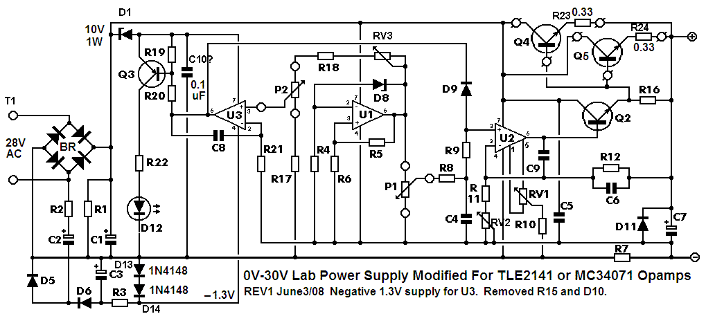

Tarkul Posted December 20, 2009 Report Posted December 20, 2009 Hey. Ive beentrying to fix the circuit. The problem now is that the ooutput voltage is steady at -0.5V!!! The good news is that the current limitng LED is now off... Voltage of D7 is -0.7V voltage of U2(out) is zero u3 is 32V and u1 is 8.3, D8 is at -5.6V.Thanks a lot audioguru Quote

audioguru Posted December 20, 2009 Report Posted December 20, 2009 Hey. Ive been trying to fix the circuit. The problem now is that the output voltage is steady at -0.5V!!! The good news is that the current limitng LED is now off... Voltage of D7 is -0.7VD7 is a 5.6V zener diode. Its voltage should be -5.6V so maybe you installed it backwards and maybe D5 and D6 are installed backwards.voltage of U2(out) is zeroU2 will not work properly without a -5.6V supply. The output from U2 should go from about +1V to about +32V in your circuit.u3 is 32VIt is low because your 24VAC transformer voltage is too low.u1 is 8.3, D8 is at -5.6V.The output of U1 should be +11.2V (the 5.6V from D8 times a gain of two). R4 should be changed to 1k.D8 should be a 5mA zener diode (BZX79C5V6). Quote

Tarkul Posted December 21, 2009 Report Posted December 21, 2009 Hey audioguru, i inverted de D7 zener, but still gives me bellow 1V. Maybe I ought to change the diode. Just one question. I had some 6A rectifying diodes, which I used for the rectifying part. Do you think this can be the source of the error? The diodes only say 6 A 4 UTLSo Im not sure of their code.Thanks again Quote
audioguru Posted December 21, 2009 Report Posted December 21, 2009 So Im not sure of their code.Then throw them away and use good diodes that are very inexpensive. Quote

Tarkul Posted December 21, 2009 Report Posted December 21, 2009 Hey I'va tried to find the MC33071 and the TLE2141. The closest I was able to find was MC33171P and MC34002N. The first one is close, but has lower quality. Do you think this matters to much? It can handle the voltage levels required Quote
audioguru Posted December 21, 2009 Report Posted December 21, 2009 Hey I'va tried to find the MC33071 and the TLE2141. The closest I was able to find was MC33171P and MC34002N. The first one is close, but has lower quality. Do you think this matters to much? It can handle the voltage levels requiredThe MC33171 is low power so its bandwidth is too low for this circuit. The MC34002 has a max supply of only 36V which is too low and its inputs do not work anywhere near ground.Digikey in Canada and the USA has 439 MC33071, 1323 MC34071 and hundreds of TLE2141 opamps in stock today.Newark in Canada and the USA has 645 MC33171, 1024 MC34071 and hundreds of TLE2141 opamps in stock today.Newark is now owned by Farnell who are in many countries. Go to www.farnell.com and click on the flag of your country. Quote

audioguru Posted December 21, 2009 Report Posted December 21, 2009 I cant believe they have Chile Colombia and Puerto Rico, and not have Mexico....Can you sneak across the border into the USA??How about the MC34080BP?Its inputs don't work when they are closer than 4V from the negative supply pin. Quote
