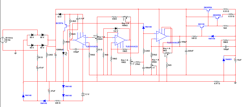

Guest nida Posted April 3, 2013 Report Posted April 3, 2013 Hello. I tried making this power supply circuit on Multisim 12. When I simulate it, the C2 capacitor with value 47uF/50V gets burned. Also I am getting only 12V at the output and the voltage is not varying when I connect the pin4 of U1(op-amp) with 2 1N4148 series diodes.But when I give -1.3V at the pin4 then I dont get any output and simulation error arises. I am posting my schematic as well.Please help. Thank You. Quote
audioguru Posted April 3, 2013 Report Posted April 3, 2013 Hello. I tried making this power supply circuit on Multisim 12. When I simulate it, the C2 capacitor with value 47uF/50V gets burned. Also I am getting only 12V at the output and the voltage is not varying when I connect the pin4 of U1(op-amp) with 2 1N4148 series diodes.But when I give -1.3V at the pin4 then I dont get any output and simulation error arises. I am posting my schematic as well.I think Multisim did not learn about electronic circuits properly. It does not know about the extremely simple negative supply source so you had to add a 1.3V battery in series with it.It does not have a model of the modern TLE2141 opamps.A little capacitor (C2) cannot burn and it will not even get warm with 50Hz half-wave at a low current.Your schematic has one wire of the AC input shorted to the output 0V (the ground). The 28VAC secondary winding of the transformer MUST NOT be connected to ground! Maybe that is why the circuit does not work properly. Quote
Guest nida Posted April 4, 2013 Report Posted April 4, 2013 Hello,I have checked the circuit with and without ground the 28VAC power source but it gives the same results so ground does not makes any difference. External Negative 1.3V supply is necessary for U3? If it is necessary so Why it is? What is the modern model of TLE2141?Which software is better for the simulation of this circuit? Quote
audioguru Posted April 4, 2013 Report Posted April 4, 2013 Hello,I have checked the circuit with and without ground the 28VAC power source but it gives the same results so ground does not makes any difference.It makes a HUGE difference.Without the ground at the 28VAC then the full-wave rectifier works properly and the negative supply works properly.With the ground then the rectifier is half-wave and the negative supply does not work. External Negative 1.3V supply is necessary for U3? If it is necessary so Why it is?Yes it is necessary for the U3 current regulator to cause the output voltage to go to zero volts when the current is high and the output is shorted. For the output to be zero volts then the output of U3 must go a diode drop (D9) negative.Without the negative supply, when the output is shorted then there is nothing to limit the current and many parts will burn. Remove the ground at the 28VAC and remove the 1.3V battery. What is the modern model of TLE2141?Texas Instruments make the TLE2141. Get the simulation model of it from them.Which software is better for the simulation of this circuit?I haver never simulated this project. If I did then I would use the LTspiceIV program that is free from Linear Technology and Yahoo has a user group that provides help and models. Quote
sobol Posted April 9, 2013 Report Posted April 9, 2013 So, I have built that power supply, but after test run i've found what follows:P1 (voltage control pot) - without a load on the output i've got 7mV to 5V, and at maximum pot position current limiting turns on (while P2 is on the maximum, while less, current limiting is constantly turned on and output voltage is about -200mV).U1 gets too hot in my opinion - after 10 minutes of test run it was about 80-90 celsius degrees.Any ideas what could be wrong? Quote
audioguru Posted April 9, 2013 Report Posted April 9, 2013 So, I have built that power supplyWhich version? The original, a modified one or the latest modification?Which transformer? 24VAC, 28VAC or 30VAC?Which opamps? TL081, MC34071 or TLE2141?P1 (voltage control pot) - without a load on the output i've got 7mV to 5VThe output should be able to go from calibrated 0V to calibrated 30.0V.Measure the output voltage of U1. It should be about 11.2V. The output amplifier has a calibrated gain of 2.68 times to make the output 30.0V max.at maximum voltage pot position, current limiting turns on (while P2 is on the maximum, while less, current limiting is constantly turned on and output voltage is about -200mV).Your current regulator U3 is not working correctly. Its output should be high (so that D9 cannot reduce the output voltage and does not turn on the LED) until the load current in R7 causes as voltage drop that is more than the amount of voltage set by P2. U1 gets too hot in my opinion - after 10 minutes of test run it was about 80-90 celsius degrees.If you used DIP 14 pins case opamps then their maximum allowed dissipation is 1000mW when the anbient is 25 degrees C.The MC34071 will dissipate a maximum of 302mW and the TLE2141 will dissipate a max of 470mW. Not too hot. Quote
sobol Posted April 9, 2013 Report Posted April 9, 2013 Which version? The original, a modified one or the latest modification?Which transformer? 24VAC, 28VAC or 30VAC?Which opamps? TL081, MC34071 or TLE2141?Version from the first post (latest i believe), 28VAC transformer, TLE2141 opamps.The output should be able to go from calibrated 0V to calibrated 30.0V.Measure the output voltage of U1. It should be about 11.2V. The output amplifier has a calibrated gain of 2.68 times to make the output 30.0V max.I'll check it tomorrow and i'll post measurements.Your current regulator U3 is not working correctly. Its output should be high (so that D9 cannot reduce the output voltage and does not turn on the LED) until the load current in R7 causes as voltage drop that is more than the amount of voltage set by P2. I'll focus on the U3 neighbourhood, maybe I will find a mistake.If you used DIP 14 pins case opamps then their maximum allowed dissipation is 1000mW when the anbient is 25 degrees C.The MC34071 will dissipate a maximum of 302mW and the TLE2141 will dissipate a max of 470mW. Not too hot.If its ok, i'm ok too. : D Quote
audioguru Posted April 9, 2013 Report Posted April 9, 2013 If you made the circuit on a solderless breadboard then the opamps are probably oscillating which makes them maqlfunction and get hot. Quote
sobol Posted April 10, 2013 Report Posted April 10, 2013 Power supply is soldered on normal PCB.OK, I've made some measurements, look at the result:U1 pin 6 (output) - 11.2V.U3 pin 3 - varies from 0 to 1.3V, depends on P2 position.10V zener diode works properly, there is 29V on emitter of Q3 while current limiter works, and 29V on pin 7 of U3.U3 pin 6 - 29V while current limiting off, -1V while current limiting on.And still power supply does not work properly. Any ideas? Can't see any bad soldering or something like that. Quote
