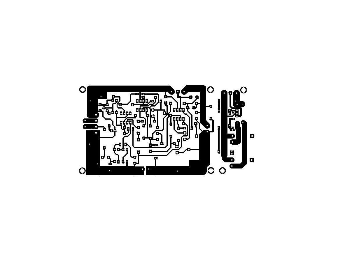

Guest jayjaymuller Posted May 10, 2013 Report Posted May 10, 2013 Hi,I'm new to the forum and also looking for the revised printout of the PCB. Can someone please post a link to this.Thanks. Quote

Guest Big zee Posted May 13, 2013 Report Posted May 13, 2013 jayjaymuller this is the last PCB ;) Quote
