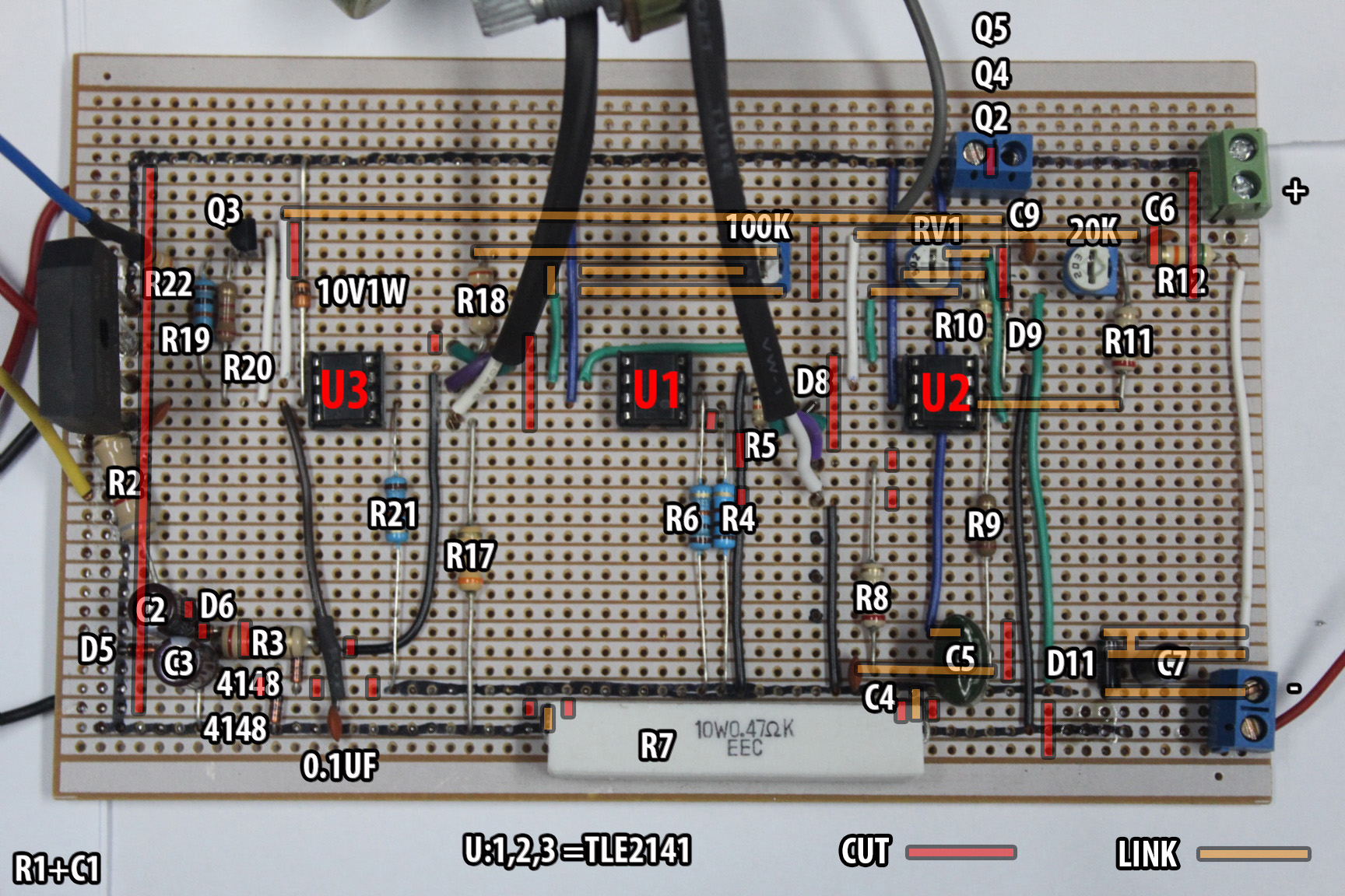

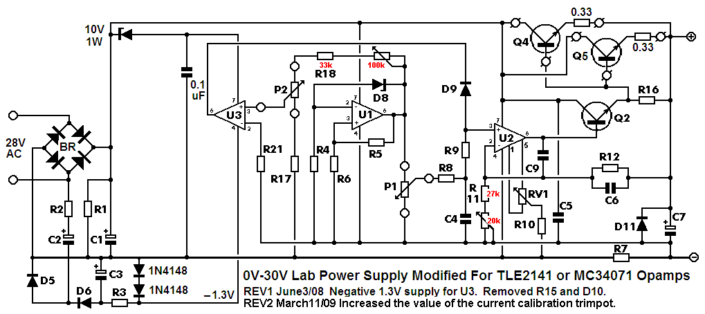

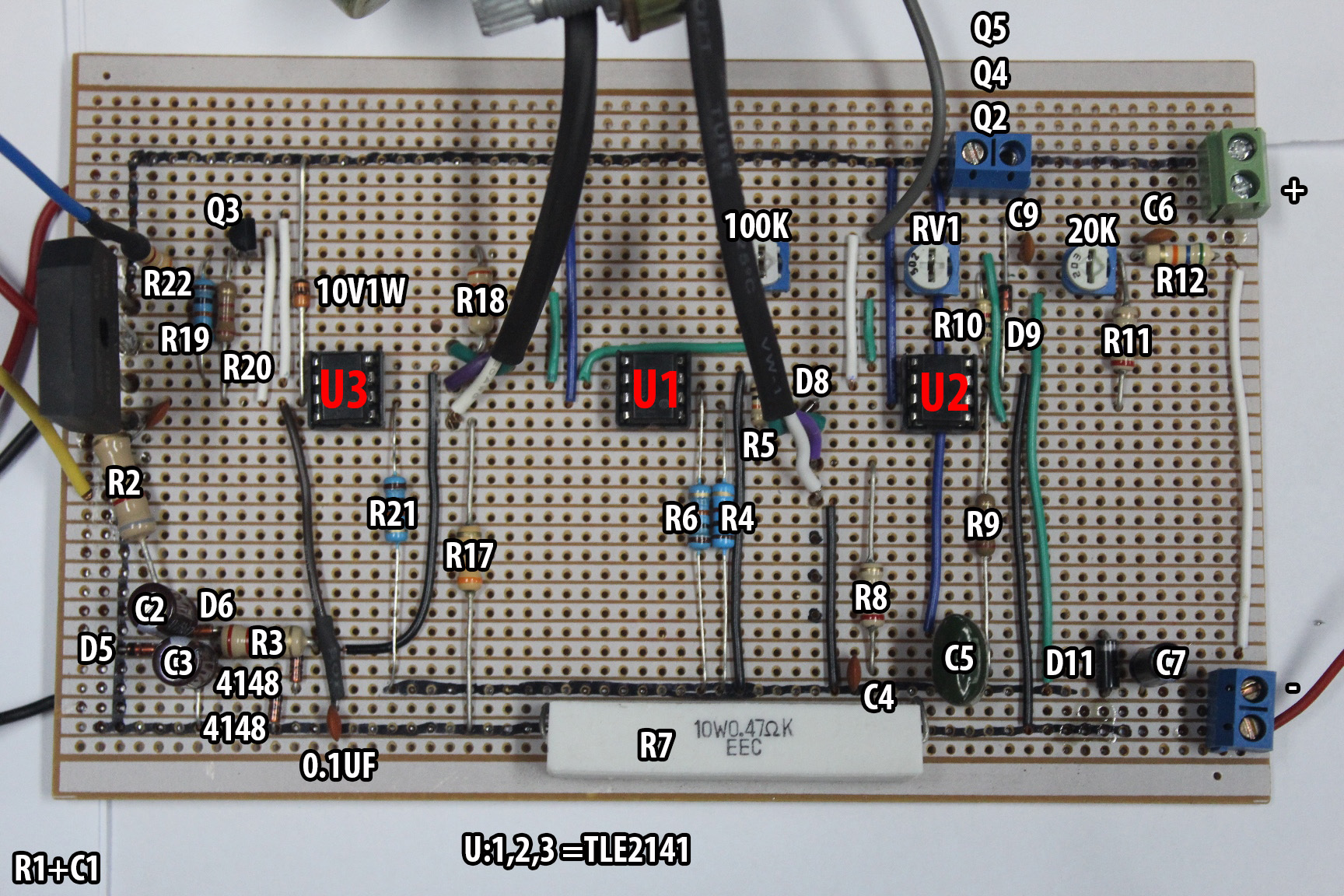

Guest Big zee Posted June 24, 2013 Report Share Posted June 24, 2013 the supply for U2 is the main negative supplyand not the same as U1 and U3 !-1.3vshould it be the same as the rest of them ? Quote Link to comment Share on other sites More sharing options...
Guest Big zee Posted June 24, 2013 Report Share Posted June 24, 2013 oknow its canon cam Quote Link to comment Share on other sites More sharing options...

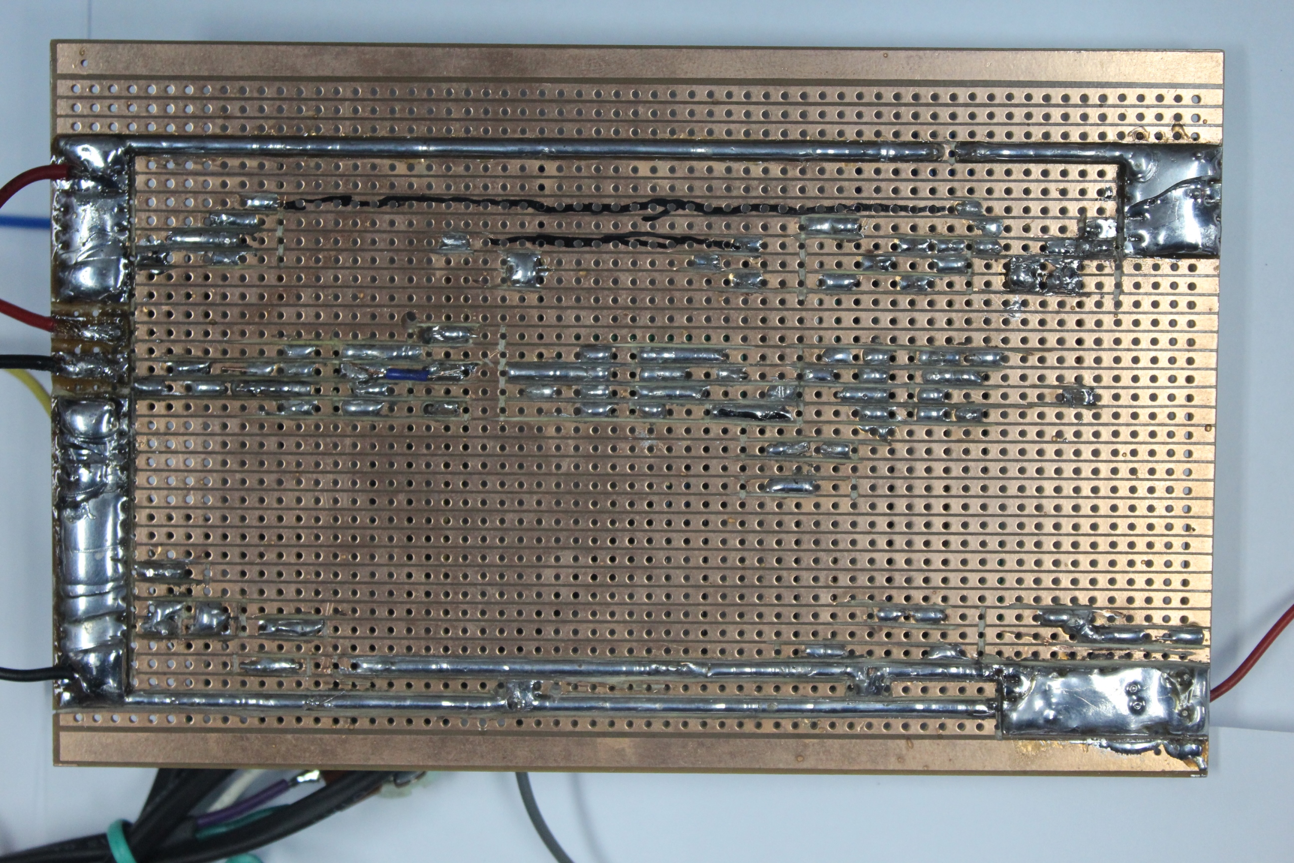

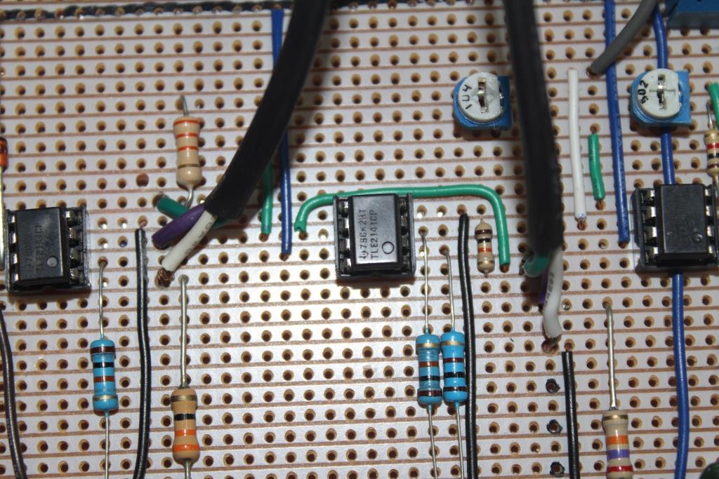

Guest Big zee Posted June 24, 2013 Report Share Posted June 24, 2013 ignore the blue wire on the back of the board Quote Link to comment Share on other sites More sharing options...
Guest Big zee Posted June 24, 2013 Report Share Posted June 24, 2013 PS Quote Link to comment Share on other sites More sharing options...

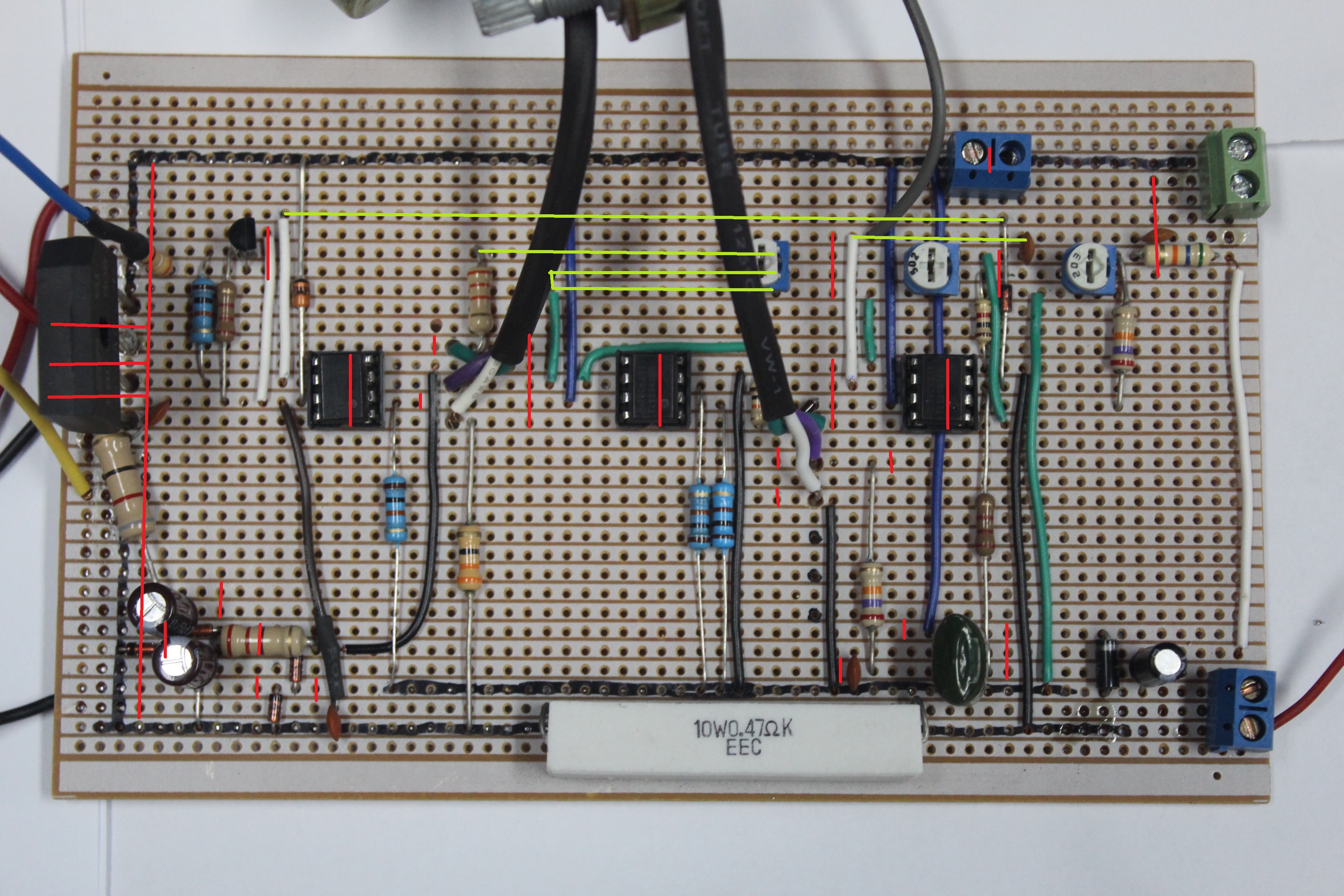

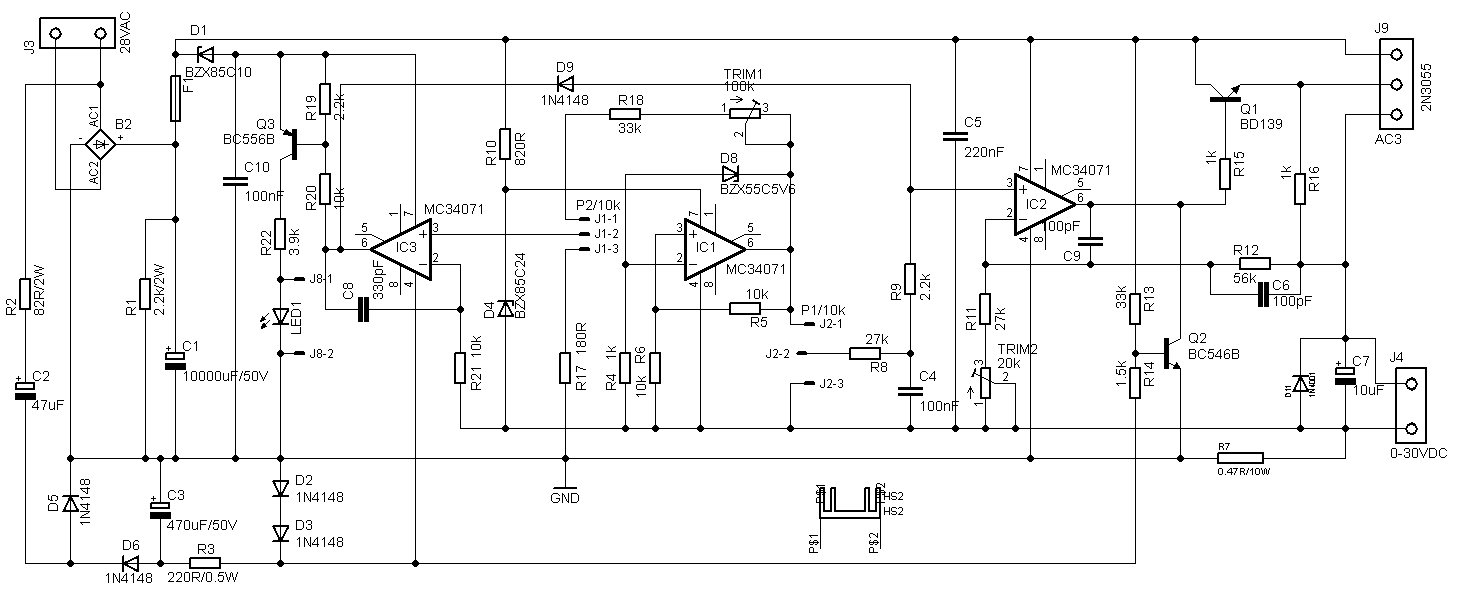

audioguru Posted June 24, 2013 Report Share Posted June 24, 2013 The schematic shows that only U3 uses the -1.3V supply because its output must go a little negative due to the forward voltage drop of D9 when the output of the project is shorted.I cannot trace your stripboard layout since none of the parts in your photo are numbered. Quote Link to comment Share on other sites More sharing options...

Guest Big zee Posted June 30, 2013 Report Share Posted June 30, 2013 hello KevinIV I did the PS for the 6th time and it still gives me the wrong value I don't know what went wrong everything seems in order .but I ran of the ICs , and I still into it . Quote Link to comment Share on other sites More sharing options...

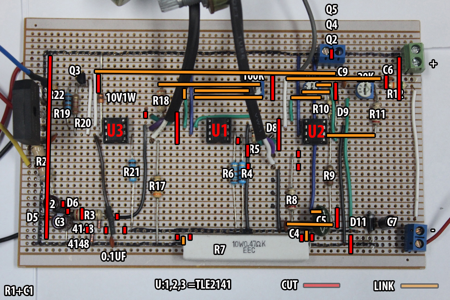

Guest Big zee Posted July 1, 2013 Report Share Posted July 1, 2013 for AG Quote Link to comment Share on other sites More sharing options...
audioguru Posted July 2, 2013 Report Share Posted July 2, 2013 for AGSorry. I cannot follow the wiring of your stripboard circuit. Quote Link to comment Share on other sites More sharing options...
Guest Big zee Posted July 2, 2013 Report Share Posted July 2, 2013 for AG Quote Link to comment Share on other sites More sharing options...

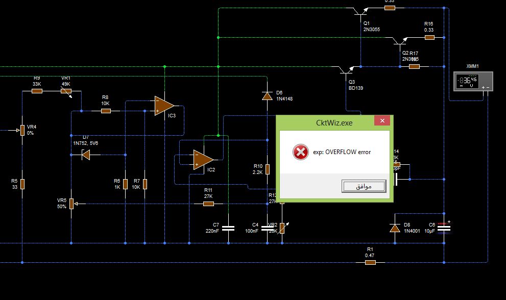

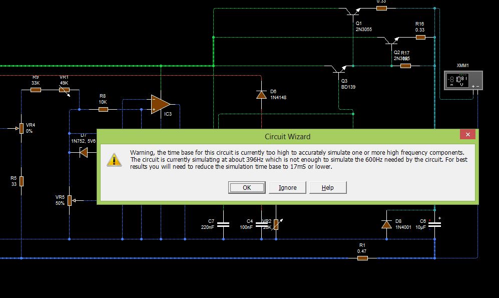

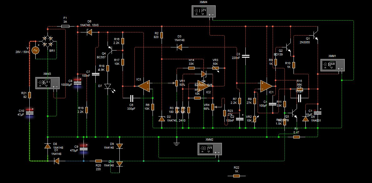

Guest Big zee Posted July 3, 2013 Report Share Posted July 3, 2013 I tried to simulate it on circuit wizardand there is some thing wrong !???I attached the circuit for you to tray it .PS30Verror.rar Quote Link to comment Share on other sites More sharing options...
audioguru Posted July 3, 2013 Report Share Posted July 3, 2013 I have never seen Circuit Wizard before so I do not know its errors.The part numbers on your schematic are different from the part numbers on the original and on my schematic:1) You have IC3 as the 11.2V reference but I have U1.2) You have D7 as a 20mA 5.6V zener diode but I have D8 as a 5mA 5.6V zener diode.3) Many other parts have different part numbers.It is a very simple circuit for you to see what is wrong. Quote Link to comment Share on other sites More sharing options...
Guest Big zee Posted July 3, 2013 Report Share Posted July 3, 2013 ok forget about the numbering its by defaultI'm not sure about the current in the D8what if its more than 5mA ?check the attached you can see the D8. Quote Link to comment Share on other sites More sharing options...
audioguru Posted July 3, 2013 Report Share Posted July 3, 2013 I'm not sure about the current in the D8what if its more than 5mA?R6 in your circuit is 1k. The voltage gain of IC3 is 2 so R6 has 5.6V across it then it sets the zener diode current at 5.6mA. My circuit uses a zener diode BZX79C5V6 rated at 5mA. There are a few other 5mA zener diodes available. Your older 1N752 zener diode is designed to be 5.6V at 20mA which will not happen and its voltage might be 3V, 4V or 5V at the current set by R6. IC3 cannot accurately supply much more current than 5mA.The output of your IC3 should be 11.2V plus or minus 0.5V. What voltage is it? Quote Link to comment Share on other sites More sharing options...

Guest Big zee Posted July 4, 2013 Report Share Posted July 4, 2013 R6 in your circuit is 1k. The voltage gain of IC3 is 2 so R6 has 5.6V across it then it sets the zener diode current at 5.6mA. My circuit uses a zener diode BZX79C5V6 rated at 5mA. There are a few other 5mA zener diodes available. Your older 1N752 zener diode is designed to be 5.6V at 20mA which will not happen and its voltage might be 3V, 4V or 5V at the current set by R6. IC3 cannot accurately supply much more current than 5mA.The output of your IC3 should be 11.2V plus or minus 0.5V. What voltage is it? in circuit wizard I replaced the zener to BZX55C5V6 then its shows its 11.44 voltbut the output of the PS not stable if the voltage adjustment 15% and its shows errorif its 10% the volts sets at 3 volt then its jump to more than 30 volt then its goes slowly to 3 volt repeatedly FYI the RV1 for U2 not connected in circuit wizard because there is no pin 5 or 1and I will look into BZX79C5V6 and I will try it on my PS Quote Link to comment Share on other sites More sharing options...
audioguru Posted July 4, 2013 Report Share Posted July 4, 2013 The BZX55C5V6 zener diode has a little better voltage regulation than the BZX79C5V6 zener diode.The reference voltage of about +11.2V should be stable and never change up and down.U2 and the driver and output transistors are a very simple amplifier with an adjusted voltage gain of (30V/11.2V=) 2.68 so the output voltage will never vary up and down like in your simulation.U3 uses a negative supply so that when the output of the project is shorted then the output of U3 can go to about -0.7V so that D9 can reduce the output voltage to zero. Quote Link to comment Share on other sites More sharing options...

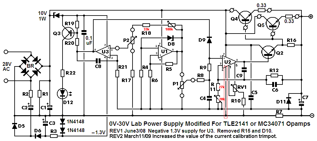

Kevin Weddle Posted July 5, 2013 Report Share Posted July 5, 2013 My mistake Big Zee, Q3 appears as only a warning that the power supply is shorted. If it were a good power transistor it could reduce the voltage too. The negative power supply should be more than 700mV and a resistor used in series with D9. Quote Link to comment Share on other sites More sharing options...
audioguru Posted July 5, 2013 Report Share Posted July 5, 2013 My mistake Big Zee, Q3 appears as only a warning that the power supply is shorted. If it were a good power transistor it could reduce the voltage too. The negative power supply should be more than 700mV and a resistor used in series with D9.No.Q3 lights the LED to warn you that the current regulator is reducing the output voltage. It will light its LED even when the current regulator is set to 100mA and a load draws 110mA. It will also light when the output is shorted because then the output current will also be higher than the setting of the current regulator.The current regulator opamp reduces the output voltage just low enough so that the load current equals the current regulator current setting.A resistor in series with R9 is not needed because the current is very low and a resistor is not wanted. Quote Link to comment Share on other sites More sharing options...

audioguru Posted July 7, 2013 Report Share Posted July 7, 2013 You show two schematics with different parts designation numbers so it is confusing for me to say what is wrong.The transistor connected to the output of the voltage amplifier opamp is needed when the opamp is the original TL081 because it has the "opamp phase inversion problem" where its output goes high when the power is turned off.The transistor that shorts the output of this opamp to ground when the power is turned off is not needed (and might even turn on when it shouldn't) when the opamp is a TLE2141 or MC34071.I selected the TLE2141 or MC34071 opamps because their max allowed supply is 44V. The the original TL081 was operating from a total supply that was far too high for it (the max for the original TL081 is only 36V) and these newer opamps work fine when their input voltage is as low as their negative supply (the TL081 needs a 5.6V negative supply so that its input voltage is far away from it). Also these opamps do not have the "phase inversion" problem. Quote Link to comment Share on other sites More sharing options...
xristost Posted July 8, 2013 Report Share Posted July 8, 2013 AGcan you check the attached and the linkI need your feedback http://diyfan.blogspot.ro/2012/02/adjustable-lab-power-supply.htmlbecause the thing is I got the TLE2141 not the other one .You must rename all parts to be with same designation in two schematics. It will be much easier to check for mistakes.And about the transistor Q2 in the output - I think it had another purpose - to shut down output voltage quicker when schematic is powered off. Quote Link to comment Share on other sites More sharing options...
