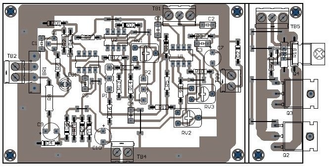

Guest DrinkH2SO4 Posted January 3, 2014 Report Posted January 3, 2014 Hello people, i want to ask you something. First i started building the original project but since reading this nice thread, i started building the revised version. I now got the rev 5 parts list, but i already had made the pcb from Picmaster. Now there are some layout inconsistency, i cant find R17 anywhere, or it says R16 instead R17 and in the place of Q1 which is not used there is a 3 pin gap. Is there a revised version of this pcb, or i need to make the another one, that is in the zip with rev 5? Any help would be appreciated. (still learning)Thanks Quote

redwire Posted January 3, 2014 Author Report Posted January 3, 2014 Hi DrinkH2O4, I don't know if anyone is going to try to match up parts on the board layout provided, to see what Picmaster changed from the design being discussed on this thread. It would certainly be easier with the sketch layout but you may need to pick a design and either ask Picmaster or this board for help. I thought Picmaster used a PIC chip to do some of the control work. Quote
audioguru Posted January 3, 2014 Report Posted January 3, 2014 Hi Sulphuric Acid,I have Picmaster's schematic. He changed ALL the parts designation numbers. Quote

Guest DrinkH2SO4 Posted January 3, 2014 Report Posted January 3, 2014 Hi again, and thx for the replies. I think the pcb in the latest zip file (the brd file) is double layered pcb, for which i dont have both sides copper plated board at the moment. Also i wouldn't want the pcb i already made (from the layout picture i posted before) to go to waste. :) Quote
