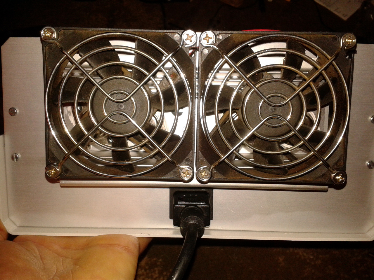

It looks like you have 2 output transistors per half mounted to the rear.  What kind of heat sink is on the back?
I got the heatsink on Ebay and is exactly like this one.  I've also got two 80mm fans mounted to it as well for active cooling once I get the temp sensors and associated circuitry worked out.

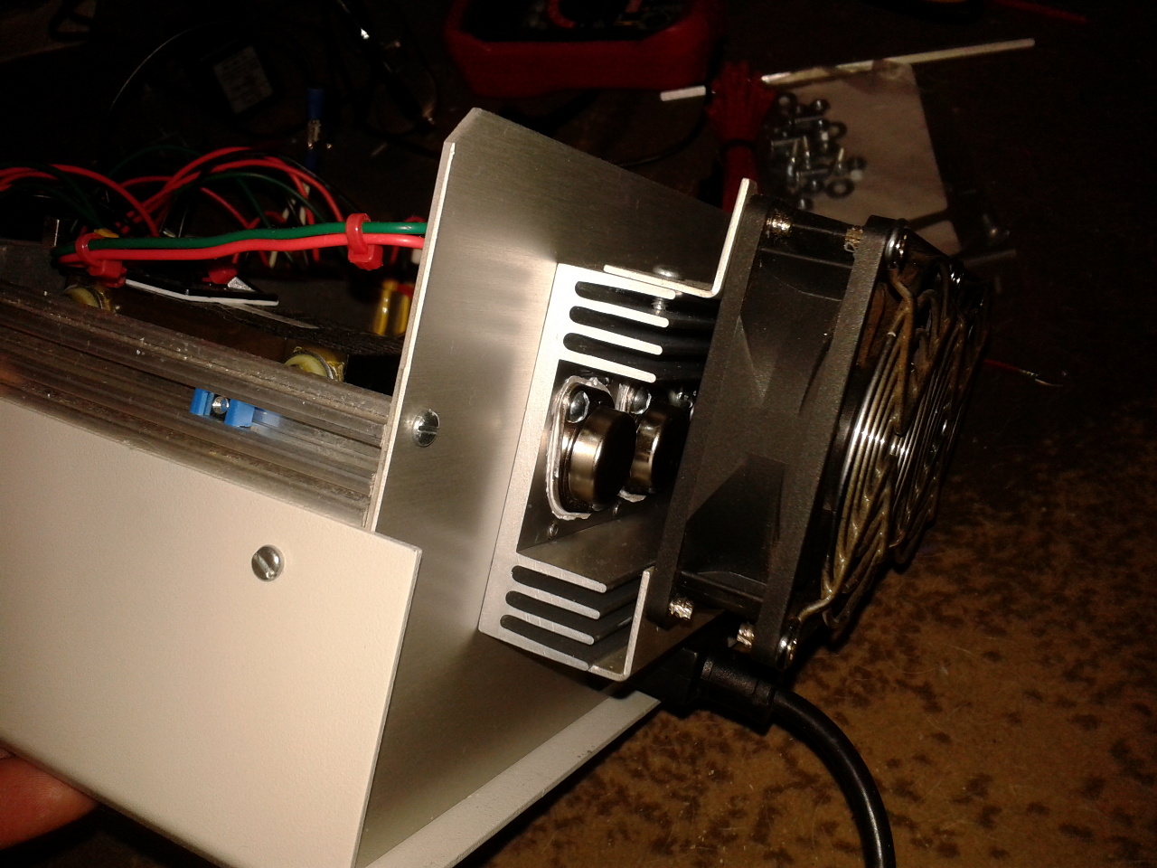

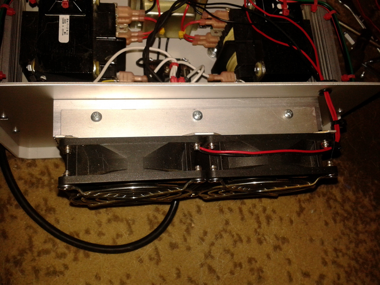

Here's a few pics of the back and how I mounted the fans.  It's kind of hackish but worked out fairly well.

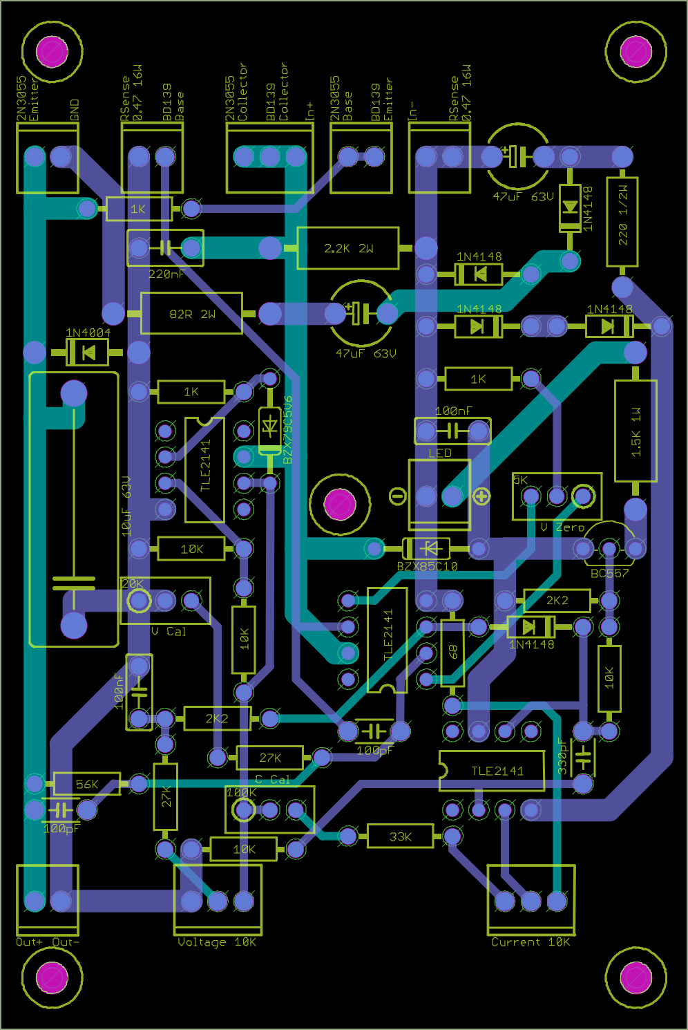

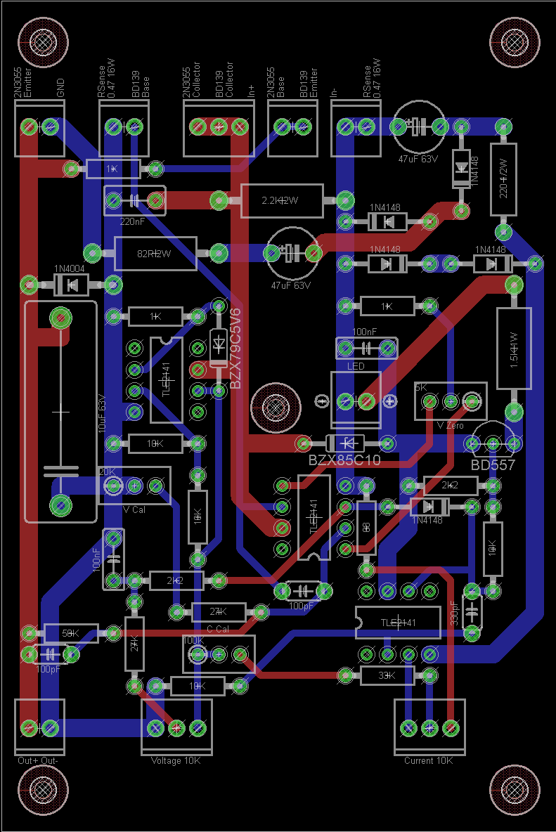

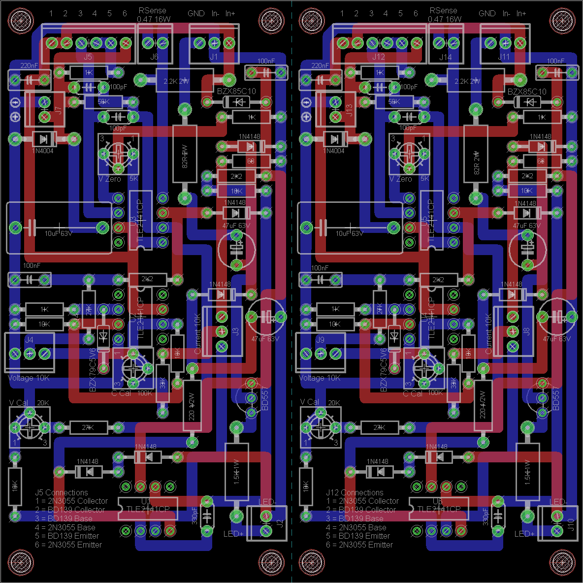

This is what I've come up with for a dual board that can be cut down the middle so that the boards can be separatec into two single supplies.  Sorry for the largish nature of the image but i wanted people to be able to see the text.  I didn't use the part numbers, just the values because I think that would be the most useful.  The board is 10cm square so it can be fabricated relatively inexpensively.  If I don't catch any glaring errors, this is what I'm going to have made to put in my box.
Link to comment
Share on other sites
Do you intend to have the board professionally made?  Some board houses require a minimum of 3 boards (OSH Park)and you pay by the area.  If you only need 2 boards,  than you may want to make single boards and have one spare.
All of the traces are the same size.  My preference would be to use small traces for the millivolt powered parts which are 90% of the parts and use double the size shown for the power traces.  For example, you have conveniently located IN+ and 2N3055 Collector very close.  I would have doubled the size of that trace.    Between IN- and R7 I would have done the same and then from R7 to the output.  The only other item that has some power is the CE pins of the BD139 but your traces look adequate for that.
Itead has a deal of 10 two layer 10cm square boards for $20, can't beat that.
I've been thinking about the layout and figured I could get two boards into the case stacked on top of each other because it's so tall.  Taking things into consideration that folks have been suggesting, I redid the board again but with just one PS per board.  I've tried to keep the power traces wide and fairly far away from the other traces.  To facilitate easier routing, I also changed most of the terminal blocks to be two wire except for the positive in/collectors which is three wire.  The only thing I don't understand is whether or not I'd need power/ground planes and what sizes to actually use for the traces.  I think I'm getting close with this one though.

Liquibyte,  Are you using EAGLE?  I would suggest shrinking the outline because most fabricators charge by the outer dimension.
  The price is likely for a minimum of 10 boards at $20 each.  $200 total.  Better verify.
Link to comment
Guest liquibyte
Yes, using Eagle.  I've been shrinking things a bit as I get the parts exactly where I want them and spaced out a bit more.  I wanted to have a hole in the center for a fifth standoff because I'll be stacking two boards and want really good rigidity.
According to everything I've read in reviews they are decent enough and that's the price for 10 boards even according to their site.

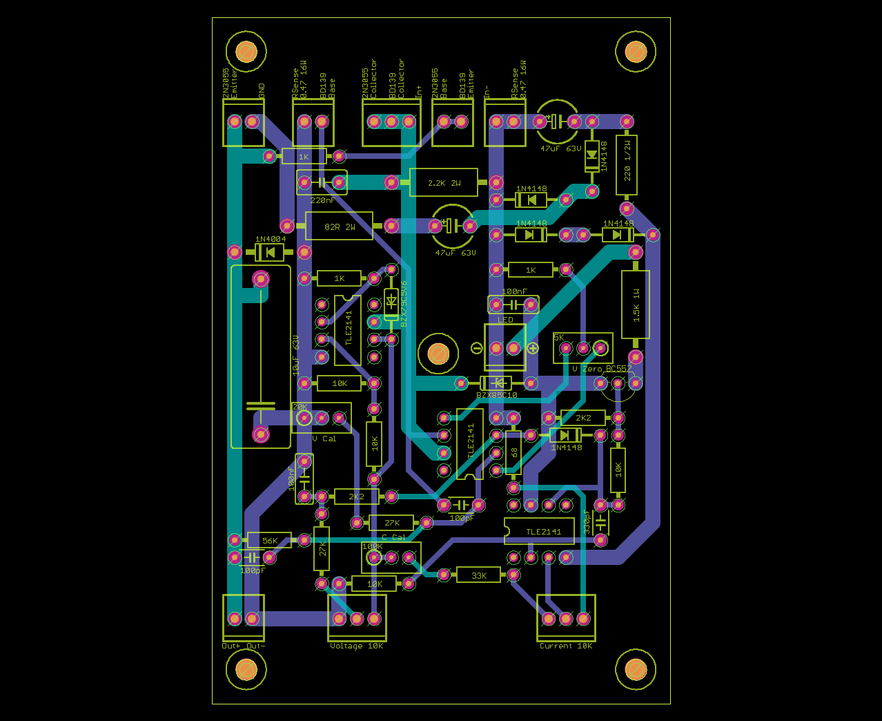

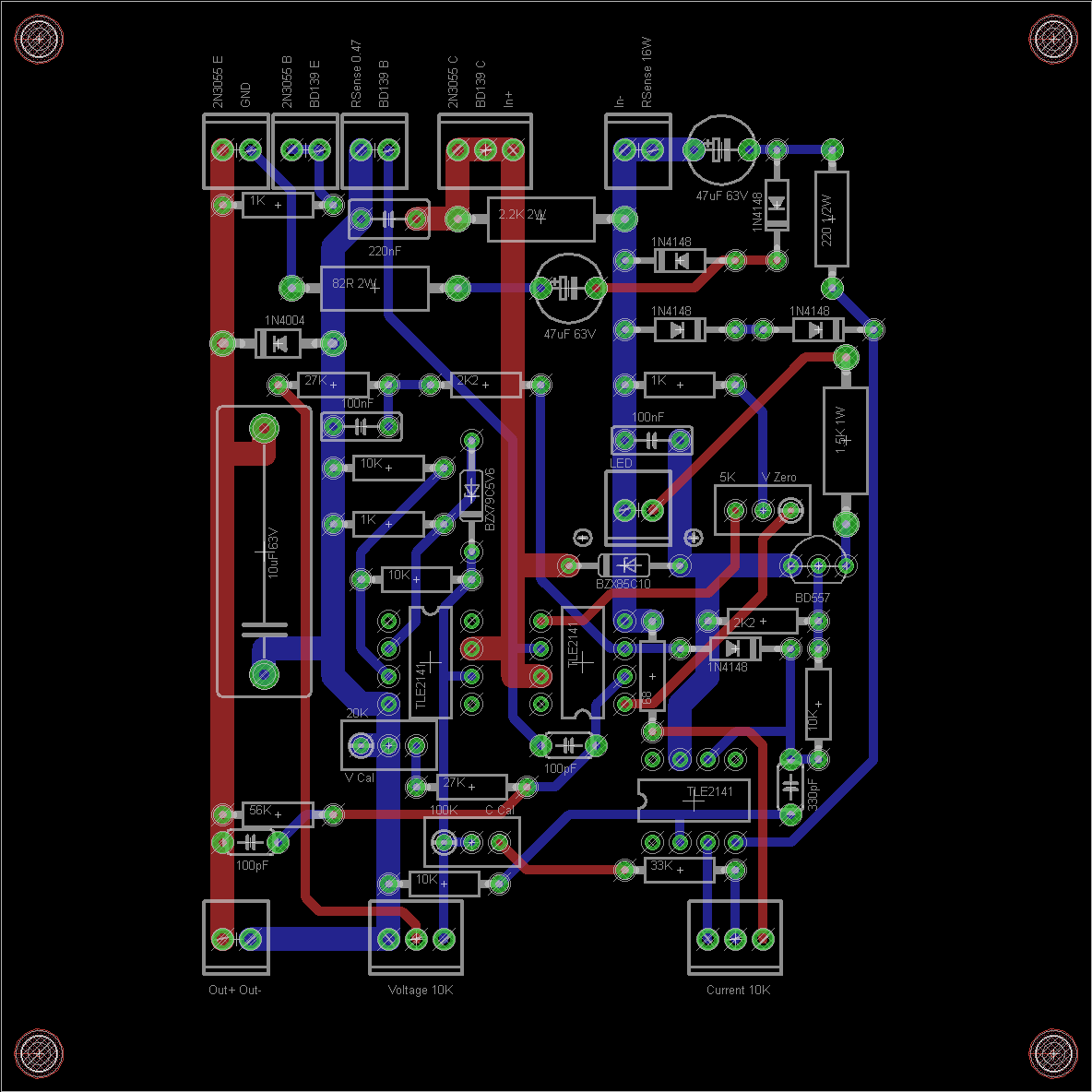

I ordered my boards today.  Doing these has been a learning experience.  Here's a view from GerbV and I'm attaching the board files Itead required to get the boards made plus the Eagle .brd and .sch files in the hopes that these might be useful to someone.  Total cost for 10 boards was $28.80 including shipping.  One of the cool things about Itead is that if you "open source" your board design, they'll send you two boards for free of two other open sourced designs that other people have done and released as such.  I don't think you can find out what until you receive them but either way it's a cool idea.  I did this just to see what I get.
The off board parts are the two 2N3055's, the BD139, the 12,000uF smoothing cap, the bridge rectifier, the 10W current sense resistor (in my case 16W so you'll have to change that on the silk screen layer), the two 10K pots and the LED.  Connectors are marked for all of these except where the bridge rectifier goes across the smoothing cap, in that case it's just marked In+ and In- respectively.  The center connector for the pots is the wiper and I haven't marked this on the board to indicate it but it should be obvious as it's the center.  The parts are pretty bog standard except for the 10uF cap at the output on the schematic (C7).  I changed that to be a film cap instead of an electrolytic and is rather large on the board due to this fact.  They aren't exactly cheap either.
Quick edit to remove the zip file because the board and schematic aren't correct due to the BC557 being reversed.  I'll put up the corrected version at the end of this thread tomorrow along with the gerbers.

Liquibyte,  your board looks good.  The only thing that stands out it your  OUT+ and OUT - header is very close to the mounting hole.  I think there if enough room to miss the mounting bolt but if you are stacking board is may be more difficult to make connections once installed.  I probably would have either moved the terminal block between the first 2 headers on the upper right side of the board, or just soldered an additional wire  to the emitter on the 2N3055 (after the 0.33 ohm resistors) and solder an additional  wire to the  0.47 ohm Sense Resistor and those 2 wires would serve as the main power carrying wires for the PS front panel, whereas the OUT+- pins can be used for  testing/Misc but you wouldn't need to carry 3-5 amps through your board.  I guess stacking the boards back to back is a possibility.
If you end up doing a lot of assembly and disassembly/testing  I would suggest  using a push on type connector (such as molex KK  with a ramp) for the voltage and current adjustment potentiometers) These carry very little current .  Assembly, testing and disassembly is quick and  easy because  you don't need to figure out which wire goes where - the ramp only goes one way.  Also if you have stacked boards you can use a right angle connector and won't need a tool to remove.
Again these are really incidental  comments .

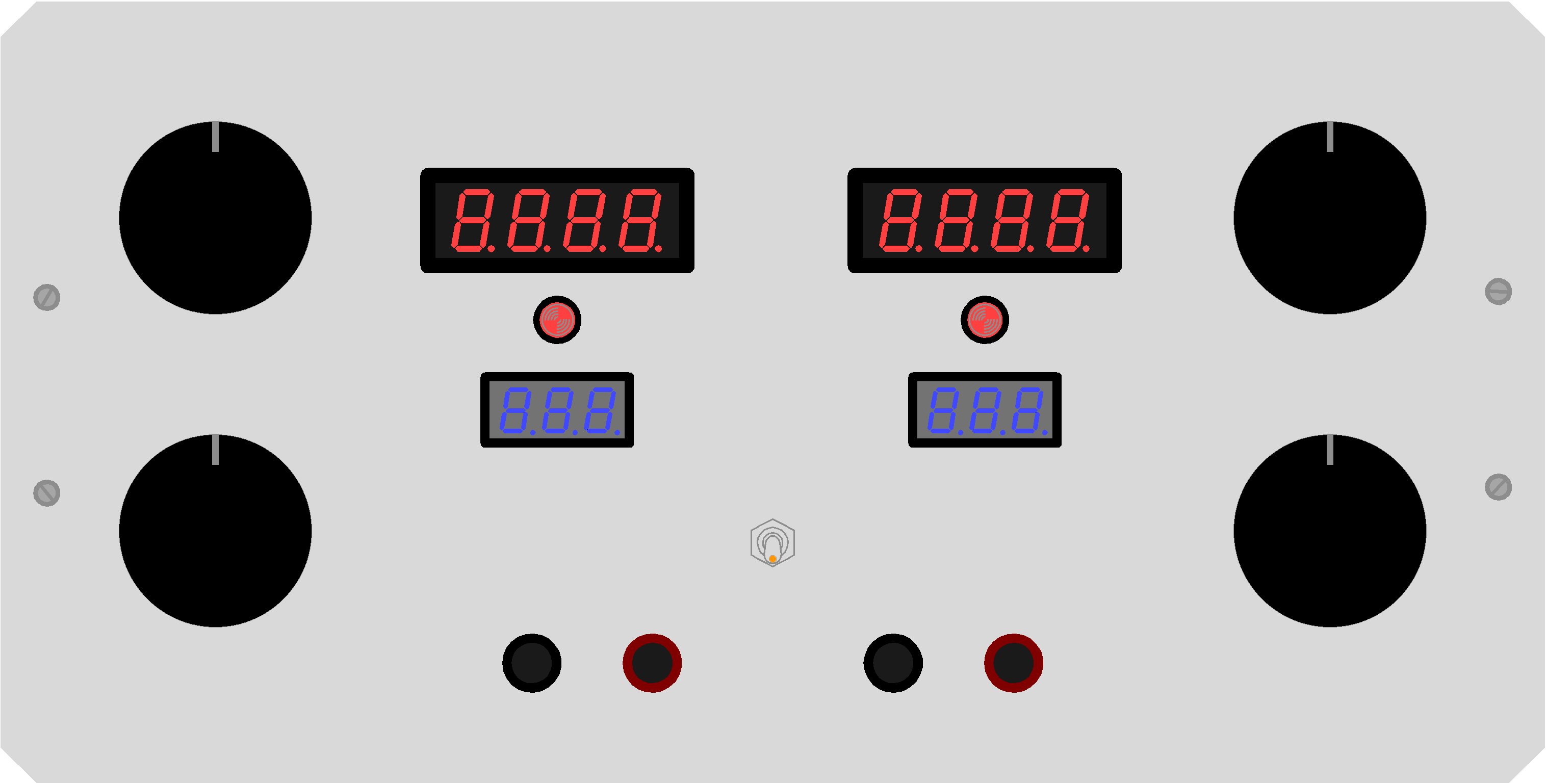

I've also done a mockup of the front panel with the measurements being fairly precise so this is basically what it's going to look like on the front.  I did order the big 1.25 inch knobs because it's common that people have stated they wished they had bought bigger knobs.  So, that's what I did.

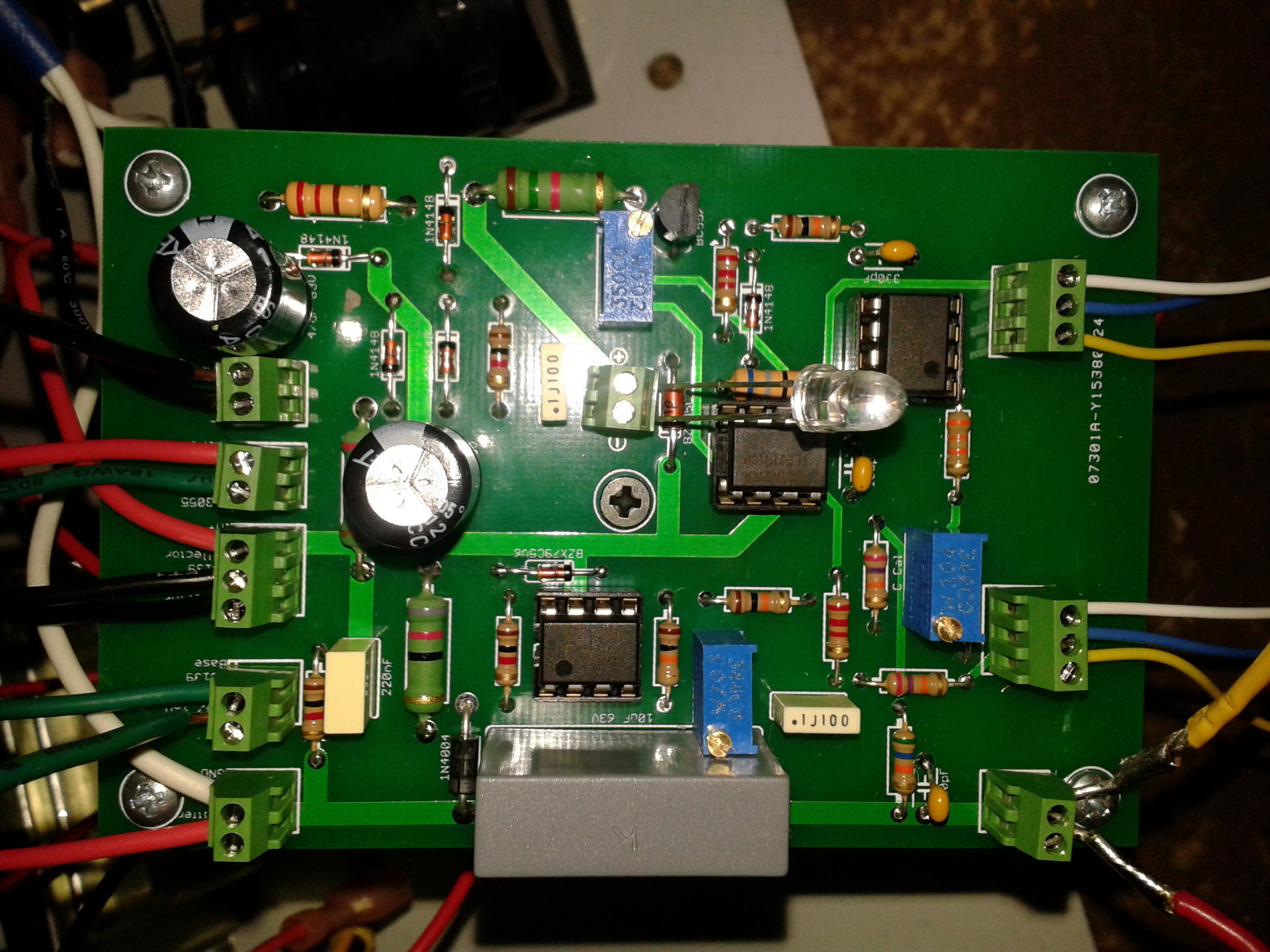

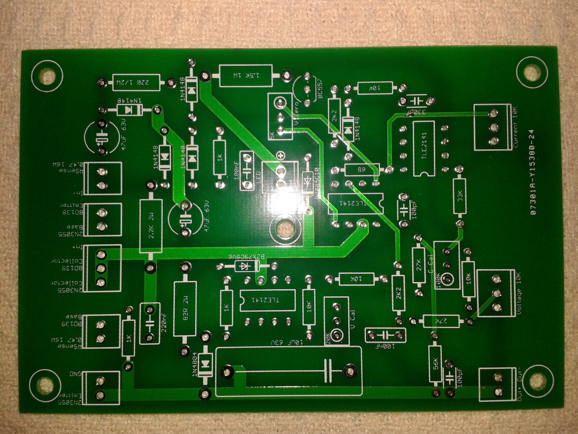

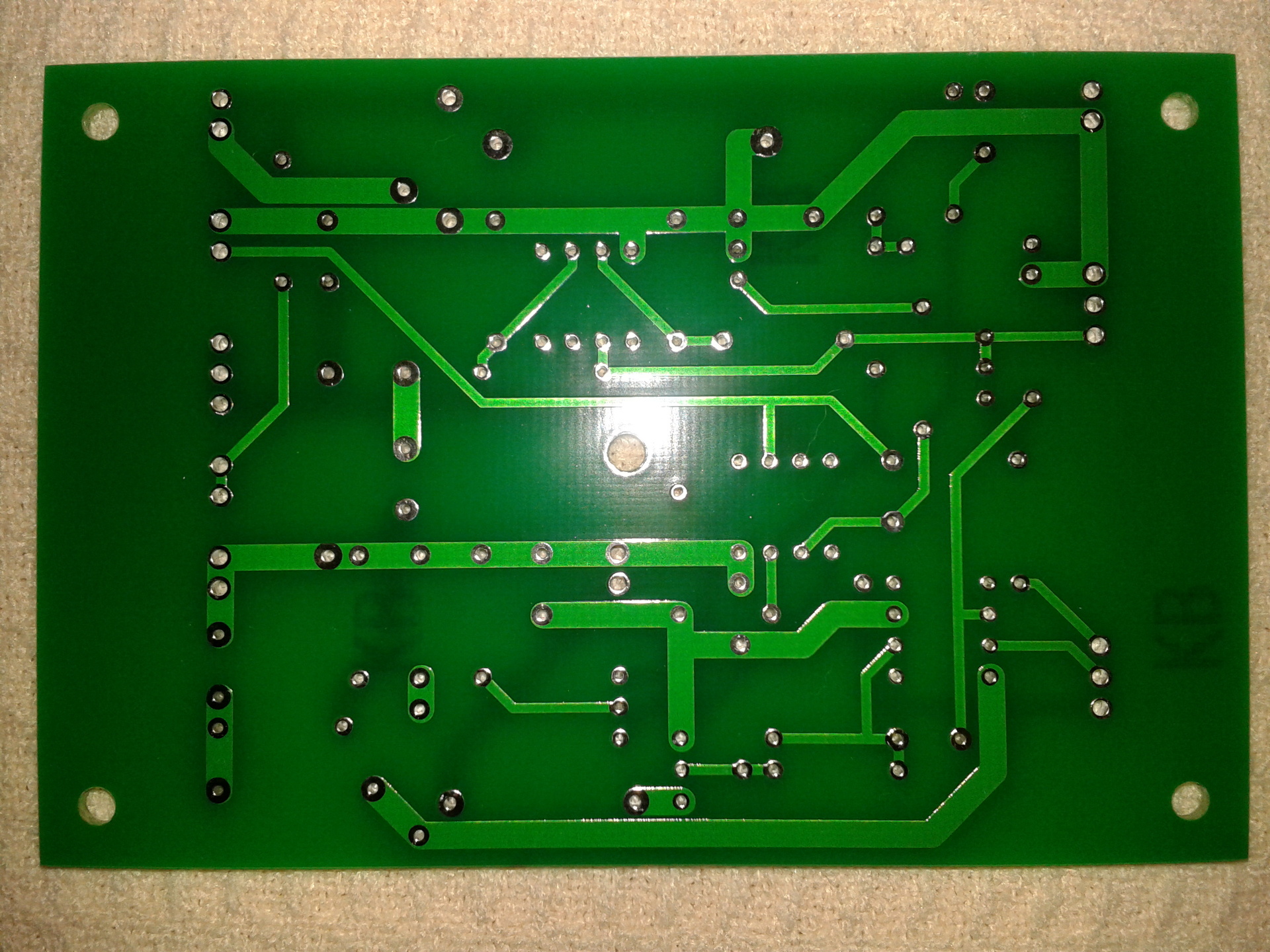

OK, my boards came in today.  I populated one of them and almost everything is working right.  The only issue I have is that the current limit LED stays on.  I think there was someone else here with the same issue but I haven't looked back through the thread yet to see if it solves the problem.
Redwire, just an FYI, I did receive 10 boards for the price they quoted and I think they came out nice enough.  I'm attaching a few pics for everyone to see.  The total for the board order was:

All in all, I think that's not too bad a price for what you get but I have no idea what I'm going to do with the other eight.  I'll probably end up making a few of these just to have around I guess.
You did not say if the current regulation LED is on all the time or only if the current-setting pot is at zero and there is no load.
Opamp U3 is simply a comparator. Resistor R7 is simply a current to voltage converter of the load current.
When the voltage produced by the current-setting pot exceeds the voltage produced by the current sensing resistor R7 then the output is high and there is no current regulation and the LED does not light.
Resistor R17 sets the lowest voltage produced by the current-setting pot and was 33 ohms. If the LED lights when the pot is at zero and there is no load then increase R17 to 68 ohms.

LED is on all the time and R17 is 68 ohms already.  One of the problems I did have with R17 is that they sent me 1/2 watt resistors instead of 1/4 watt for some reason.  I figured that wouldn't matter much in the grand scheme of things.  I used your parts list with these but I did make sure that I got 10 turn trimmers this go around as I wanted finer control over things..
Yes, the price seems out of line with other board manufactures.  Your boards looks good enough and it is hard to make them yourself for that price!      I actually made an order from them for a simple rectifier board, similar to what you would use for your Radio Shack transformer.  I'm waiting for them to arrive.
As for your LED always being on, check your transistor Q3 to make sure it is connected properly. You could have leads crossed.  Post the voltage reading of all of the pins on U3.  Check to make sure you didn't swap R19 and R20.

You nailed it man.  I had Q3 collector and emitter reversed.  I don't know if the package comes that way in Eagle or if I mirrored it somehow.  Everything is now right with my world, thanks.  I wish I had caught that before I sent out for the boards.  I'll just have to remember to reverse the transistor when I build further versions.

Yeah, I double checked the part and it has reversed legs, why I don't know.  I mirrored it and corrected the board file and gerbers to reflect the correct part I used.  I deleted the zip file from my previous post so I don't cause confusion and I'm attaching the corrected version here for anyone that wants to use the files.  Included are the schematic and board files plus the gerbers that I used at Itead to get the boards made.  The recommended weight should be 2oz copper for 3A given the trace width, however, that adds $25 to the cost of the boards with them.  I used 1oz and am going to run 22awg jumper wire along the bottom between the components and the outputs to handle the current.  Probably not the best solution but I imagine it will work alright.

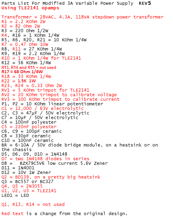

Edited to include a parts list of Digikey part numbers.
I had concerns that the traces were on the thin side as noted earlier  but  I still think you can rearrange parts  and small traces, and widen the power traces to use  1oz copper.  The overall placement is pretty good as the power traces are nearly a straight line on the left side of the board.
