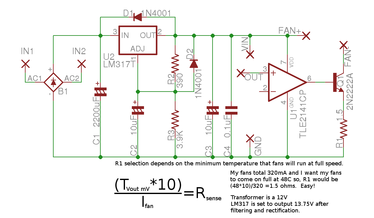

I've been working on a temperature controlled fan circuit to run the fans based on the temps of R7.  The circuit for the fan control consists of an op amp, an LM35, an NPN transistor, and a resistor, in other words, everything to the right of the last cap.  I want to add that I didn't come up with this, this guy did.  All I did was test it out, though I did change the op amp and transistor used.
Link to comment
Share on other sites
Guest liquibyte

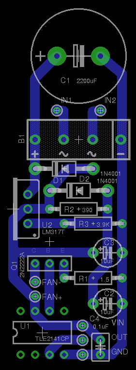

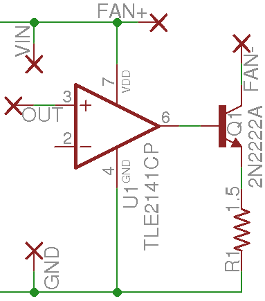

The temp sensor is off board, hence the VIN, OUT, and GND. The pinouts for the TO-92 and the TO-220 are different so doing a board for one precludes the other unless you just use wire pads, a terminal block or some sort of connector.  Pins 1, 5, and 8 aren't  used so I didn't invoke them.  I just cobbled this together quick just in case someone wanted to try it out.
Edit:  To be honest, I wanted to see how small I could get the board.  I know it's ugly and not finished yet, but this is what I have so far.

Liquibyte, your temp sensor board looks really good, but sort of complicated. I've seen lots of sensor circuits, most are really simple, like this (attached) Sorry about the rough drawing. I'm using something like this and it works fine, except I've adjusted the pot to only come on if my heat sinks get really hot, because I hate noise when I'm trying to work. I 'm not criticising your circuit, I'm just interested in what makes it better.
The LM35 and its accuracy.  I searched this one out because I wanted one sensor to control 3 fans.  The resistor can be changed according to the total current draw.  If you look at the schematic, you'll see that I've included a power supply in addition to the temp circuit.  Here's just the temp circuit.  VIN, OUT, and GND are the LM35 connections basically using any sort of 3 wire to board connector you have on hand.  I used a TLE2141 because I had some handy but any bog standard op amp will do and any bog standard NPN transistor will do as well.

Yes, I know the LM35, and I see your circuit. I am confused with the logic involved. You said you need to control three fans. but from how many points of reference? You will have to go easy with me. I'm a thrift designer/developer. the guy who strips good designs down to economically viable production prototypes. I am struggling to understand your need to over engineer this good, but basic concept. Its a good design, made better because of the open initiative of many hobbyists assisted by experts within this forum. We need, however, to be pragmatic and explore the fact that

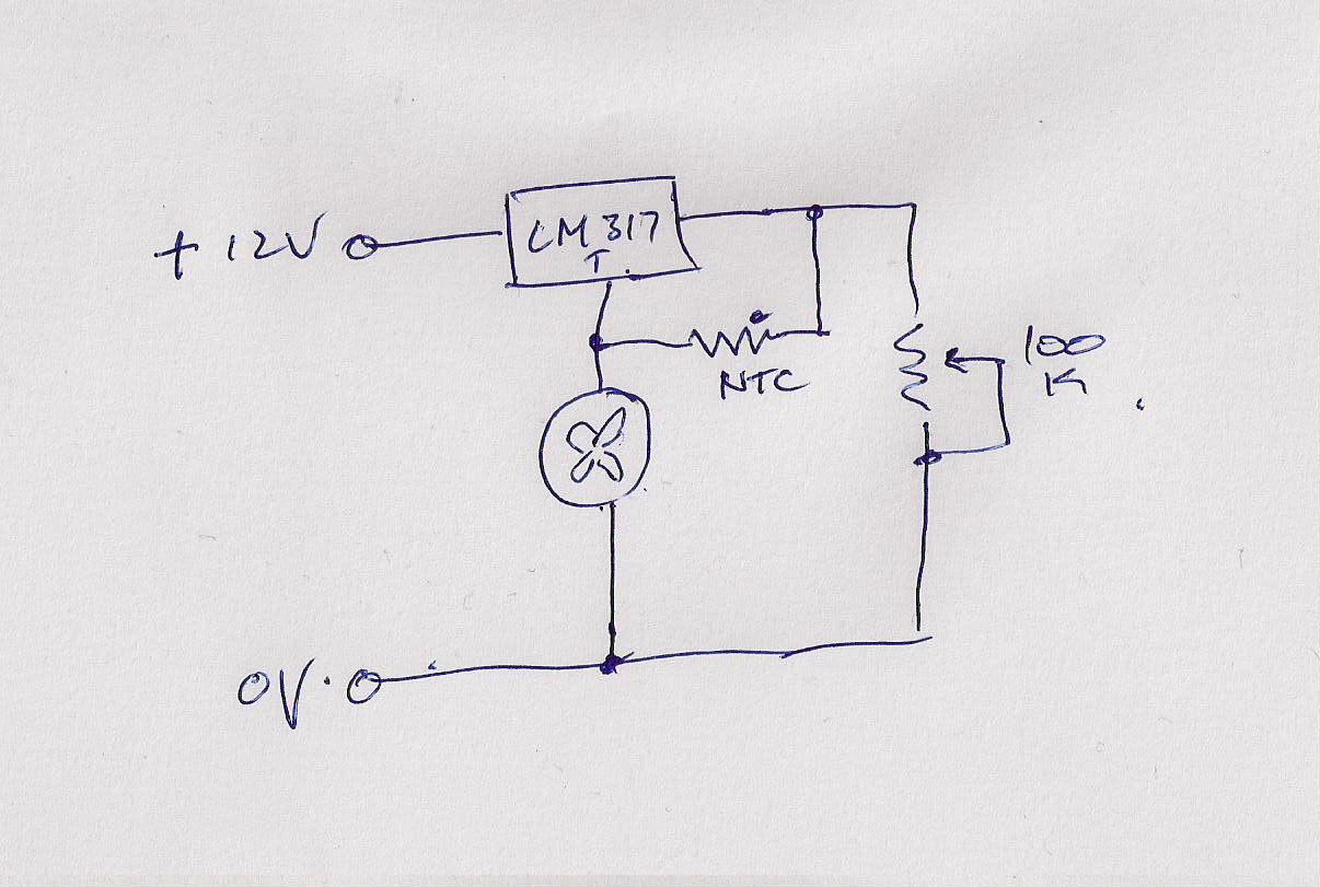

this design is probably not the best choice to bet all your money on. I have an old power supply based on the old LM723 and 2N3055 parallel solution that out performs this in every way except that it won't go to zero volts. I could add, that this is something that could be fixed without a major outlay. Your project is impressive. but what will you do with it? What is your end game? You have a dual supply with three fans. Impressive in every detail, but compared with what? Liquibyte, my questions are not intended to annoy you. I am simply interested in understanding your motives. why are you investing so much into something that has little or no return? What will you do with your masterpiece?

I just finished building the power supply.  Liquibyte did a nice job on his board!
