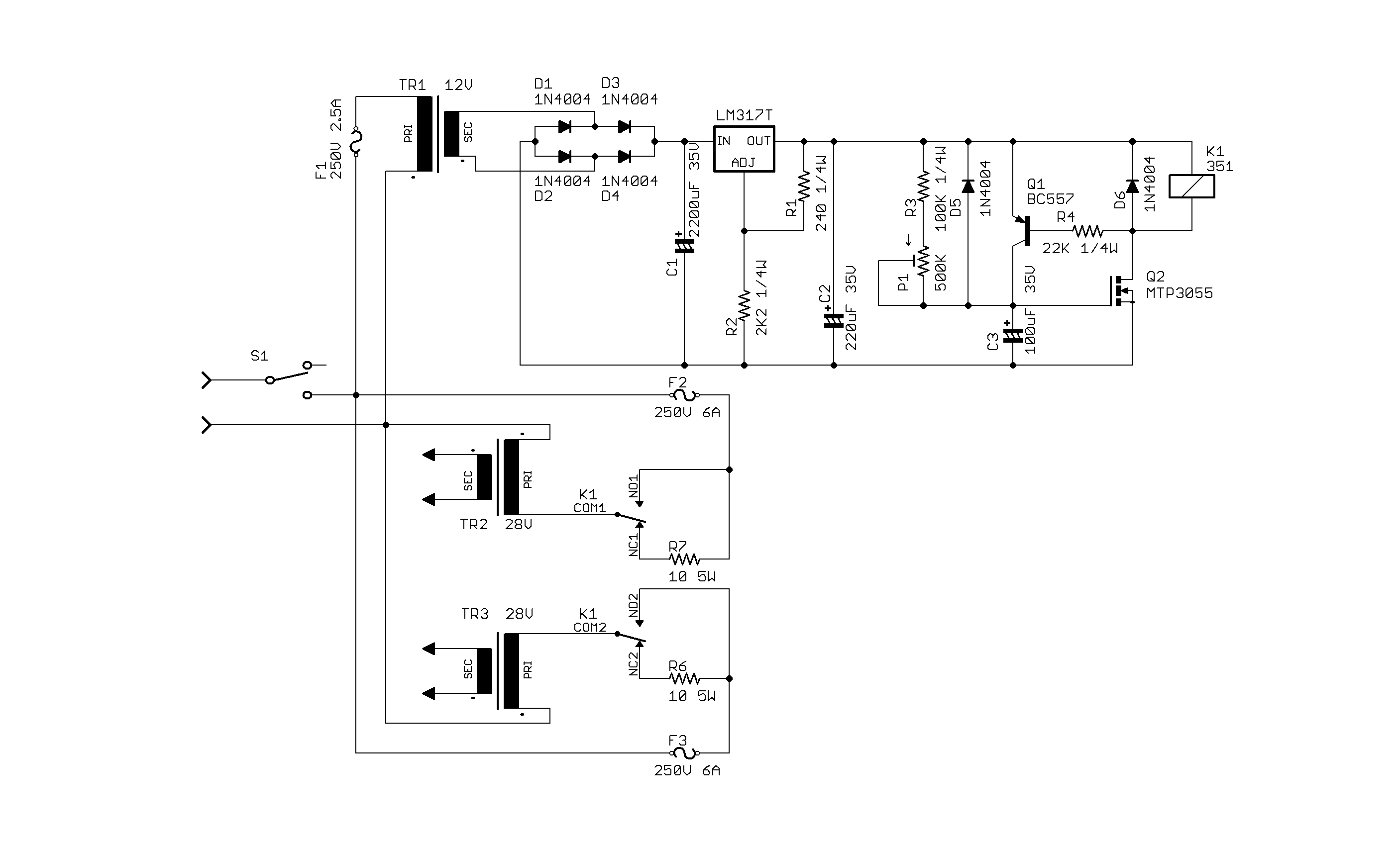

Guest liquibyte Posted September 8, 2014 Report Share Posted September 8, 2014 I have a slightly different circuit than the one shown below but essentially this is what we need to be doing. I've been told that it might even be better if the anode of the 36V zener was tied to the negative supply and increased to -2.5 to -5 volts if 36 volt op amps are used. I think if that's the case then the 10V zener would still have to be in play as far as U3 is concerned though. I'm not sure as I haven't done the math on it. Theory disproved.I've tested this with the 10V zener in place but connected between the 180R resistor and the positive side of C1 and the anode of the 36V zener tied to the ground at C1's negative side. I can still reach 30 volts output with no issue and I'm not getting the very serious 61 volt spikes anymore but I am still getting a P1 dependent spike. The really odd thing is that at 30 volts it's a 6 volt spike and around 20 volts it increases to around an 8 volt spike and then falls off again at about 10 volts back to a 6 volt spike. I'm going to keep working on it but I think there's something inherently wrong with the design and may require more changes to work reliably. I'm getting really odd results but I don't have the equipment that I'd like to have to test this fully. A more modern scope would help immensely but I just don't have the cash to get one right now. Donations accepted. :PI'm going to say to anyone that hasn't built this, DON'T. This thing suffers from too many problems to work reliably. Find something else that's stable and proven. It does work and it also does almost everything you'd want it to with the one exception that when you turn it on, you're going to get a voltage spike that can possibly destroy anything you have hooked up to it at the time. If you have one of these built already, turn on the power first and then hook it up to your circuit. If audioguru would build one of these and test it, we might get quicker results. As it stands, I'll be working on this and I believe redwire will as well in about a month.Edited to remove schematic, it was wrong. Quote Link to comment Share on other sites More sharing options...

audioguru Posted September 8, 2014 Report Share Posted September 8, 2014 I have a slightly different circuit than the one shown belowI guess you know the 180 ohm resistor reduces the maximum output current to almost zero for an output voltage of 30V. The maximum output current with an output of 5V is only about 150mA. Quote Link to comment Share on other sites More sharing options...
Guest thiagoas Posted September 8, 2014 Report Share Posted September 8, 2014 I guess you know the 180 ohm resistor reduces the maximum output current to almost zero for an output voltage of 30V. The maximum output current with an output of 5V is only about 150mA.I was gonna say that. hehe Quote Link to comment Share on other sites More sharing options...
Guest liquibyte Posted September 8, 2014 Report Share Posted September 8, 2014 I guess you know the 180 ohm resistor reduces the maximum output current to almost zero for an output voltage of 30V. The maximum output current with an output of 5V is only about 150mA.Yeah, you're right. I was just following a suggestion from somewhere else. I didn't think about the output current when I put this in under no load. If it gets loaded at 3A, the magic smoke's gonna happen. I guess what we're going to have to do is some sort of soft start circuit. The inrush current from the filter cap is wreaking havoc. Quote Link to comment Share on other sites More sharing options...
audioguru Posted September 8, 2014 Report Share Posted September 8, 2014 The voltage drop of 180 ohms at 3A is 540V! If you use 1.8 ohms then its voltage drop at 3A is 5.4V which might prevent the output from reaching 30V.With 1.8 ohms then the size of the zener diode must be huge. Quote Link to comment Share on other sites More sharing options...
Guest liquibyte Posted September 8, 2014 Report Share Posted September 8, 2014 Have you ever used anything like this or anything simple like that? Most of the issues have been solved, at least as far as I can see with the equipment I have. The last issue would be some way to slow the inrush current so that it doesn't destroy things. Quote Link to comment Share on other sites More sharing options...

Guest liquibyte Posted September 9, 2014 Report Share Posted September 9, 2014 Thanks, that's what I wanted to know. I'll order a relay in a few weeks and calculate out the resistors and report back if it works alright, I'm guessing it should. I have to now pull out the zener and put back the 10V model to the right place. Crap this thing is wearing me out. Quote Link to comment Share on other sites More sharing options...
redwire Posted September 9, 2014 Author Report Share Posted September 9, 2014 How about a soft start such as:document2014-09-09-094358.pdf Quote Link to comment Share on other sites More sharing options...
audioguru Posted September 9, 2014 Report Share Posted September 9, 2014 How about a soft start such as: ..... The 10A darlington will have a voltage drop of about 2V at 3A which might be OK. Quote Link to comment Share on other sites More sharing options...
Guest liquibyte Posted September 9, 2014 Report Share Posted September 9, 2014 How about a soft start such as:I'm going to go with this so I don't have to cut any traces on the boards. I should be able to fit that in my case somewhere. Oddly enough, I already have everything, including some 10 ohm power resistors, except for the relay and mosfet. Even then, I may have something laying around that I could use but I figure I have to order the relay, I might as well get some mosfets while I'm at it.I'm still feeling dumb after taking someone's word on the zener thing and not doing the math. ::)Edit: I've simplified it a bit but I think it might be a good solution if it works. Quote Link to comment Share on other sites More sharing options...
