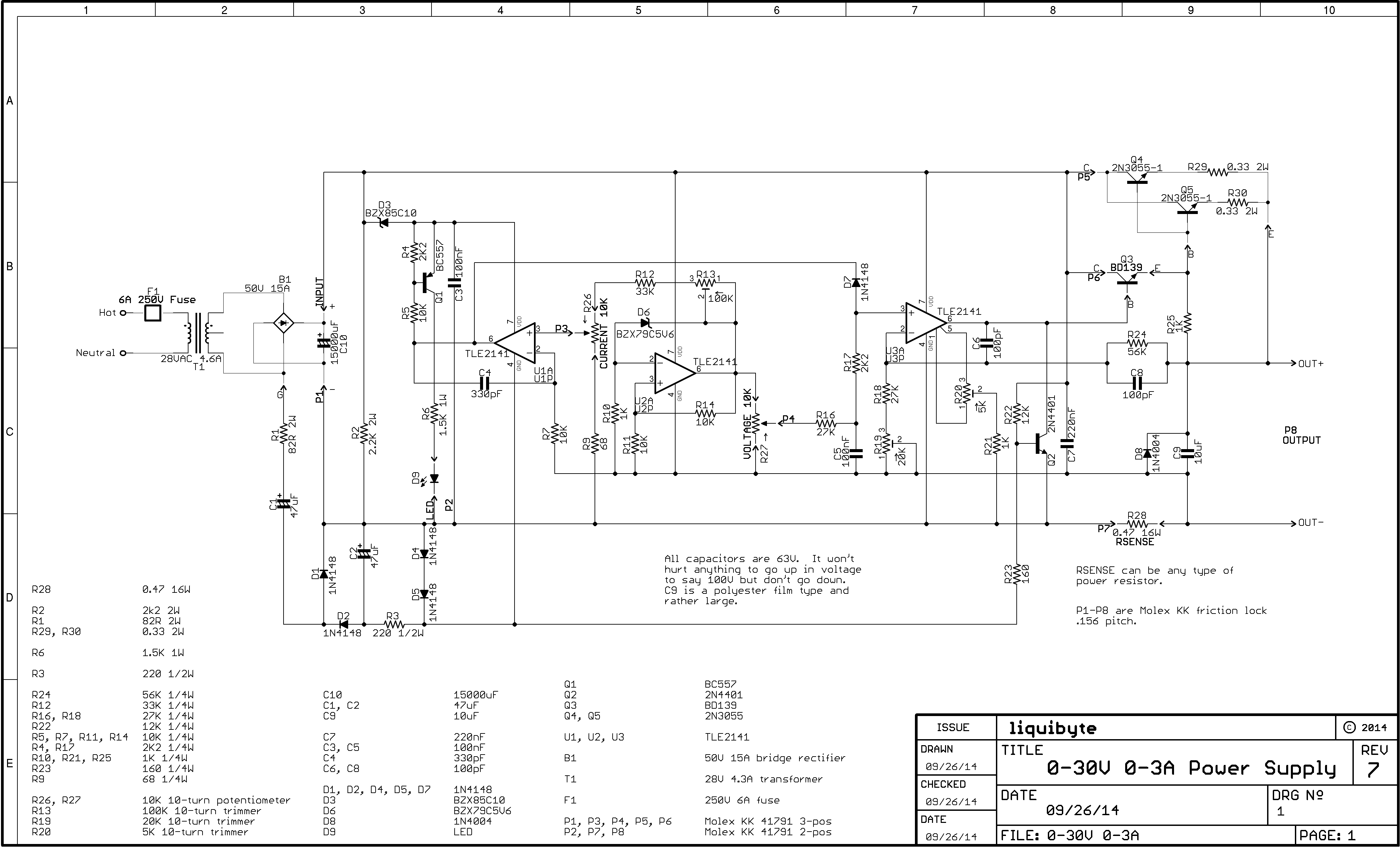

The original project has errors and problems:
1) Many of its parts are overloaded so it is not reliable. The transformer, driver transistor and single output transistor overheat. Your 24V/3A transformer is rated at 72VA maximum but the full wave bridge rectifier operates from the peak which is 24V x 1.414= 34V and with an output of 3A then the transformer power is 34V x 3A= 102VA. You can calculate the heating in the driver and output transistors yourself.
2) Without a load the peak voltage from the transformer is about 36V which is reduced to about +34.8V by the bridge rectifier.  The opamps use an additional negative -5.6V supply so their total supply is 34.8V + 5.6V= 40.4V but their absolute maximum rating is only 36V.
3) There is no way the project can supply 30VDC at 3A because the circuit losses reduce the output to about 25V at 3A. If you increase the transformer voltage then the opamps will be destroyed even quicker and more heat will destroy the driver and output transistors quicker.
Therefore we fixed the circuit and improved the parts.
Maybe you should research the original parts and calculate how much they are overloaded. Also show your teacher the losses that prevent 30V at 3A.
The original circuit would be reliable if it uses a 20V/4.3A transformer. But its maximum output at 3A would be only about 18VDC or 20VDC.

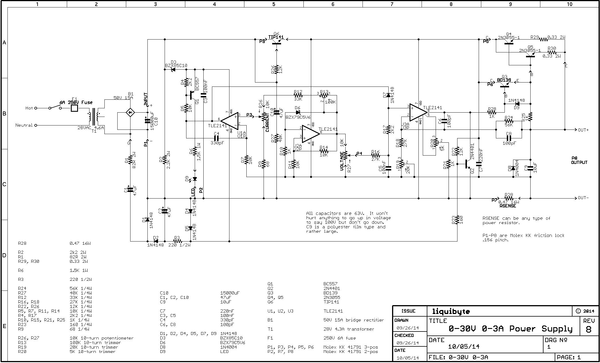

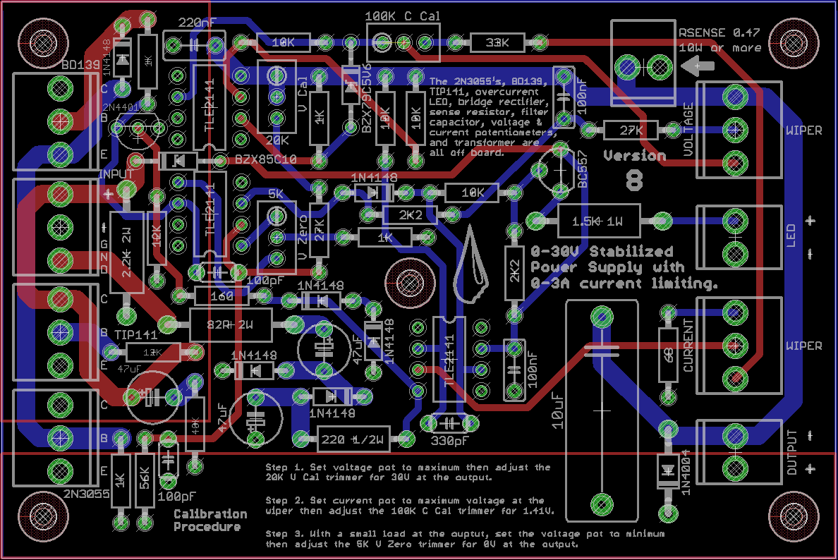

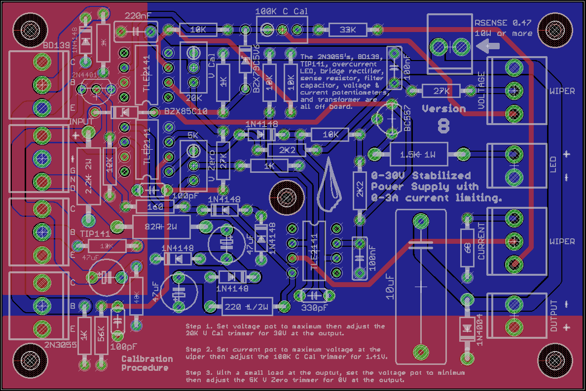

I've been doing a little more work on the board.  I added in the TIP141 soft start circuit redwire came up with and I added R15 and D10 back in.  I figure that if I had these made and R15 and D10 isn't needed or causes unexpected results a jumper can be soldered in instead.  Since I measured overhead to spare I figure it couldn't hurt to try them out.
Since I've done the work and people keep asking about it, I'm going to put the Eagle files up.  I haven't made this yet and I haven't tested the the power supply with the added components yet so if you want to make this it's at your own risk.  If you do make it, let me know how it works.  I plan on doing testing of the added stuff later on next week and if everything works out I'll probably have these made.
Quick edit: redwire reminded me that spacing on fills and traces should probably be bigger for home etching.  If you got this before I edited the post, try downloading again for the updated spacing.  I changed the spacing from 6mil to 10mil.
Another edit: I wasn't happy with a few things so I tweaked some stuff.  I'm happy now.
0-30V-rev-8.zip

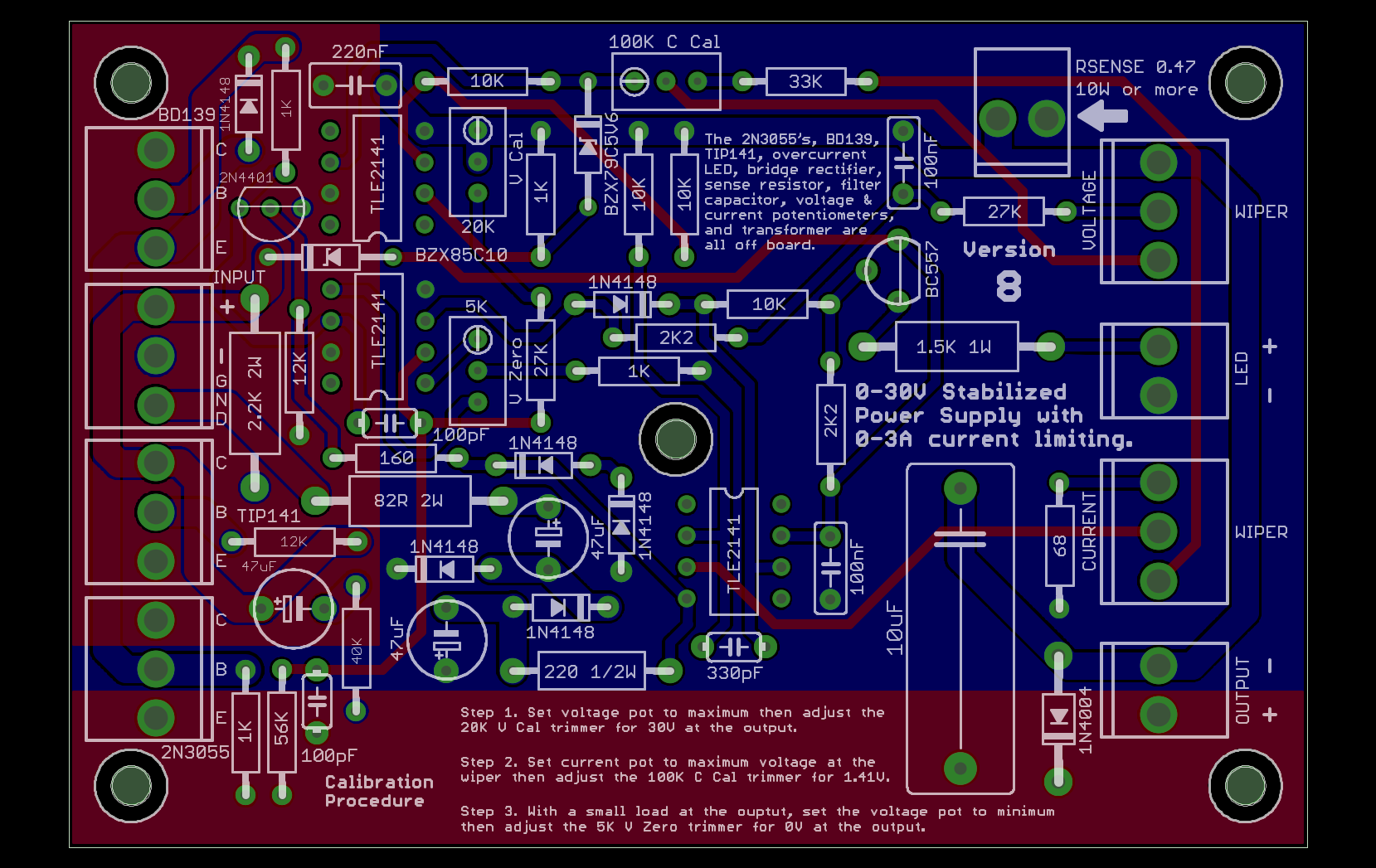

I took the liberty of making gerbers using Elecrow's cam file if anyone wants to have these made super cheap.  You can get 10 boards made for around $20 including shipping.  I'm confident in the design of the board and redwire is sure the soft start should take care of the problem with the startup transient.  I'll be doing testing on this sometime this week and report the results with pics.  If you do have this made, report back on how it works for you.  If you want to test without the soft start, just jumper the TIP141 header from the collector to the emitter and leave out the 12K resistor.  If you want to test without D10 and R15, leave out D10 and use a jumper in place of R15.  The Q1 circuit seems to now be required so leave that in.
In addition to the edit in my previous post, I redid the gerbers and I made a new schematic with the added parts.
gerber.zip

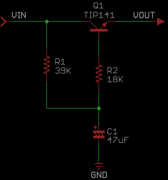

Hold off on populating the soft start.  I started testing last night and the arrangement and values will likely need to be tweaked.    As drawn, the PS kicked on at the same time as the main cap -no good.  I then rearranged the set up by connecting the 47uf cap directly to ground and used  a 39k resistor connected between the collector and cap.  I then used a 18k resistor to the base of the TIP141.  Timing seemed pretty good (about 1 sec delay to reach 12V) with reasonable ramp up on the scope.  I did not test it with a load.  After running through the numbers (39k and 18K resistors) and the data sheet for the TIP, I am concerned that the base current of approximately  0.7mA to the TIP may be a little low under a 3-5 Amp load.  I may need to change up the resistors to increase the base current to the TIP without shortening the delay period.  Otherwise I may need to increase the value of the cap.    Will keep you posted.

After some experimenting, I'm not thrilled with the soft start results.  I don't know if adding all those parts are worth the benefit.
What kinds of results are you getting?  I thought you had a delay going on before and just needed to tweak the time a bit.
I've been looking at solutions using basic transistors and there seem to be limited options there.  Is it maybe because it's not an ideal solution?  My thinking on this is that we should be using the transistor as a switch and not try to make it slowly ramp the voltage.  Isn't fast turn on ok as long as it happens after initial power is applied to the transformer, rectifier, filter cap circuit by at least the time domain that the spike lives in?  How would you delay the voltage to the base so the transistor stays off for say 200 milliseconds or so?  From what I've been reading mosfets seem to be the going rage for inrush current limiting so wouldn't this be adaptable to what we're trying to accomplish?  Something from this app note perhaps?  Figures 5a and 5b on page 9 look interesting but reading the calculations the whole thing seems to be way over my head.  The pic is from something that has to do with the usb spec and gets posted a lot.

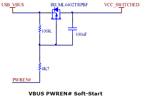

Can someone who might know better tell me if this would work and if not, why?
I think there is a certain supply voltage where the opamps in the project suddenly begin working, maybe with severe overshoot.
maybe why most audio amplifiers do not have soft start. Instead they use a relay for delayed start so that the circuit can stabilize before it has an output.
Link to comment

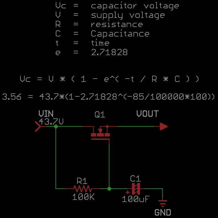

I've measured the spike before and without the power supply attached so I'm thinking that even though the circuit is handling things to a certain level it's just not enough and may eventually damage the op amps themselves by being continuously subjected to +60V at power on.
If I put this before the op amps and if f I have a VGS(th) of 3.5-5.5V such as with this one, then at around 850ms or so this would turn on with the above circuit given the values of 100K and 100uF according to the calculation that I got here.  My settled voltage after rectification and filtering is 43.7V and is consistent between two separate power supplies.  So, given that value, the 100K resistor, the 100uF cap, and the equation 43.7*(1-2.71828^(-85/100000*100)) I get 3.56V @ 849.7476ms.  I made sure I verified the calculation and didn't just rely on the page itself to do it right so I'm confident in the values but I'm not sure how well it would work as I've never tried something like this before.
I don't have the mosfet I linked but I do have quite a few laying around to try this out with but am wondering if I'm just wasting my time with such a simple solution.  Should I be looking into the app note above and calculating out a circuit for either figure 5a or 5b and trying that instead?

Ok I've gotten something that seems to be working fairly well  I have a 39k connect to the high side, then a 2.2k connected to the 39k then a 47uf connected between the 2.2k and ground.    Then I have 4K7 resistor connected at the voltage divider between the 39K and 2.2k.  The other end of the 4k7 is connected to the Base of the TIP141.  Start up is nice  and shutdown occurs nearly instantly .  The first picture is startup the second is shutdown.  The blue line is connected to the main cap (10,000uf) and the yellow is the output.  Test was taken with about a 0.5amp bulb.
