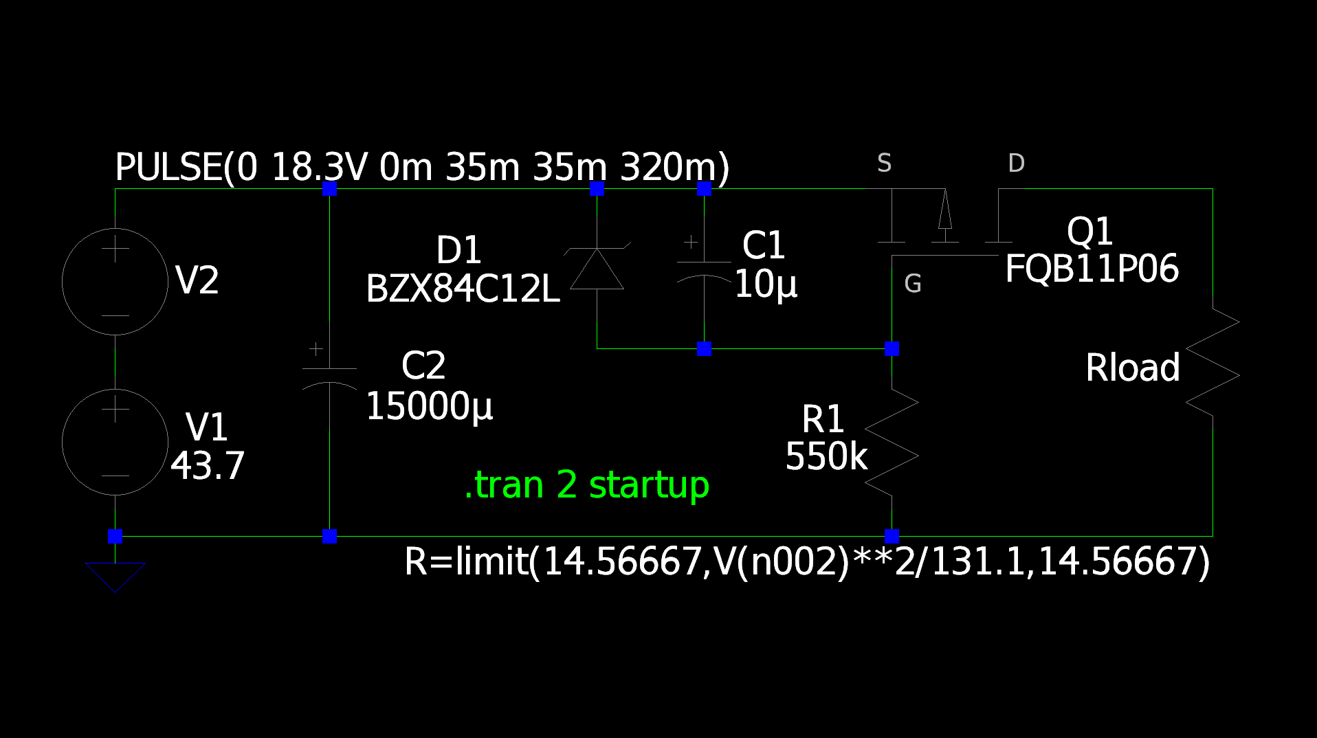

I'm having a discussion over at eev about the mosfet schematic.  I think we have found two solutions.  Mine requires a zener from the source to the gate to keep VGS below 20V.  I'm going to try both and see how it goes.

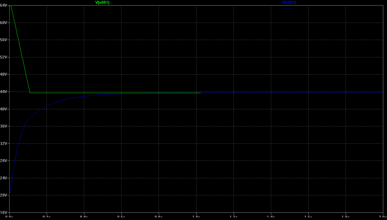

I have no idea if I'm really doing this right but I seem to be getting results from LTSpice.  I was trying to model the spike and then tune the turn on curve of the transistor to fall after that range.  I have no idea if this would work in the real world or not but it sure does look nice.  I've attached the .asc file zipped up if anyone wants to give it a whirl.
soft-start.zip

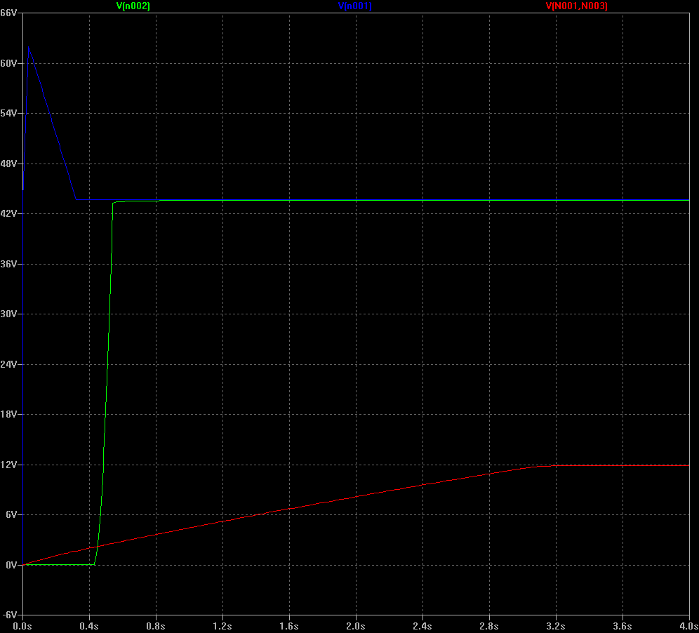

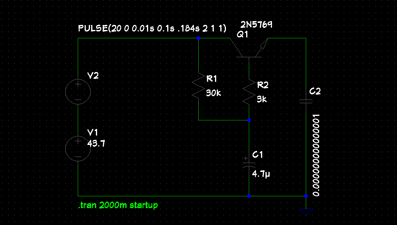

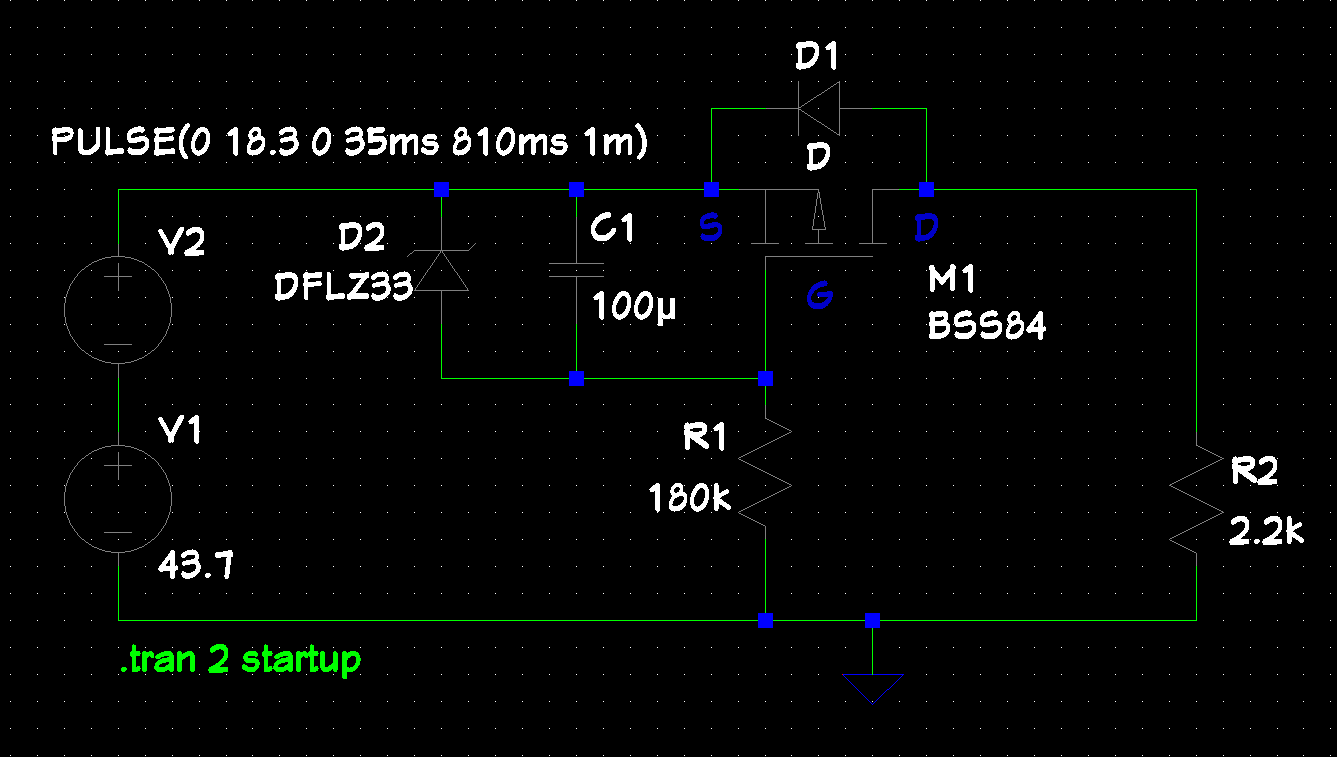

Here's the mosfet solution that I've been working on.  It seems to work except that LTSpice says that the gate is seeing the pulse (V[n003]).  Changing the delay is just a matter of changing the value of R1.
Edit:  I'd been measuring the gate to ground and should have been measuring gate to source.  I got a little help with that and now it shows the correct plot.  So, we have two working solutions now.  This one may be a little better because of the voltage drop across a traditional transistor.
mosfet-fixed.zip

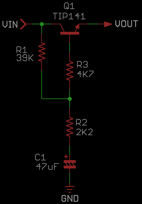

I did some testing with the TIP141 and 5 amp load and nearly burned up the TIP because I didn't have a decent heat sink.  I put the Tip on medium sized heat sink and noticed the temperature rise to about 125 C which was hotter than anything else on the board, even the output transistor heat sink.    I wonder if I miscalculated something. I thought operating more or less like a switch would not generate that kind of heat (except at start up).  I was thinking that the voltage drop when fully on would be about 1.2V at 5 amps or 6 watts.  I'm definitely burning more than 6 watts.  The other thing I noticed is that the turn-on delay was nearly triple or about 3 seconds.

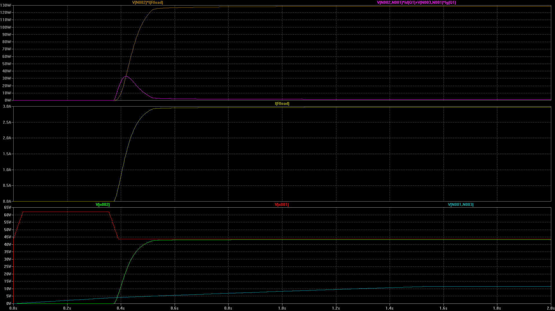

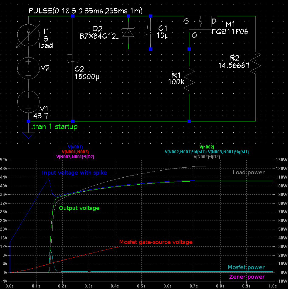

That's definitely not a good thing.  You wouldn't happen to have a PFET to test my theory out with would you?  I haven't fully finished the simulations yet because I want to test using a load as well but I've just now figured out how to work some of the basic stuff so it may take a little time.
Edit: For example, here's the results with a 3A load.  I may be modelling things wrong but things definitely changed when I added the correct load for 3A and a 3A current source.

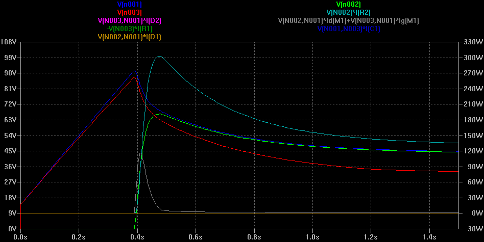

Guest liquibyte
I rearranged some values and redid the plot.  If I'm doing this right, the power looks good for the zener and the mosfet so there doesn't seem to be any issues there.  I put in the filter cap too because it's part of the circuit right before the mosfet and I wanted to make sure it didn't alter the results.

I think I'm starting to get the hang of this after doing a bit of reading.  Here's the results with things set correctly if I'm reading everything right.
Edit:  After getting some feedback and doing a bit more research, I think I've finally got something that gives fairly good results.  I'll have to wait to test it but hopefully this is a solution that works.
