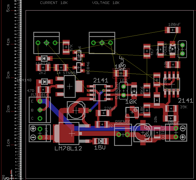

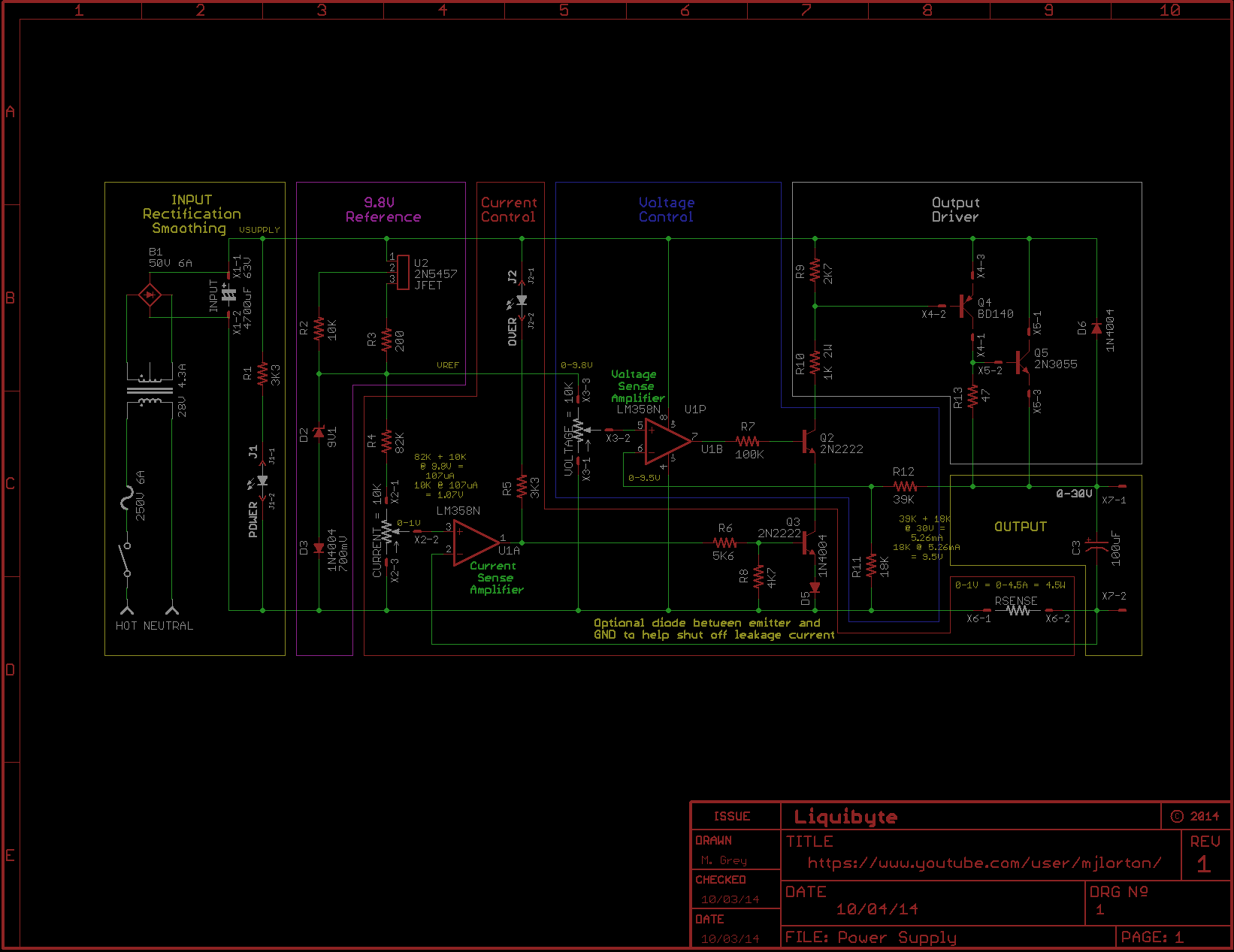

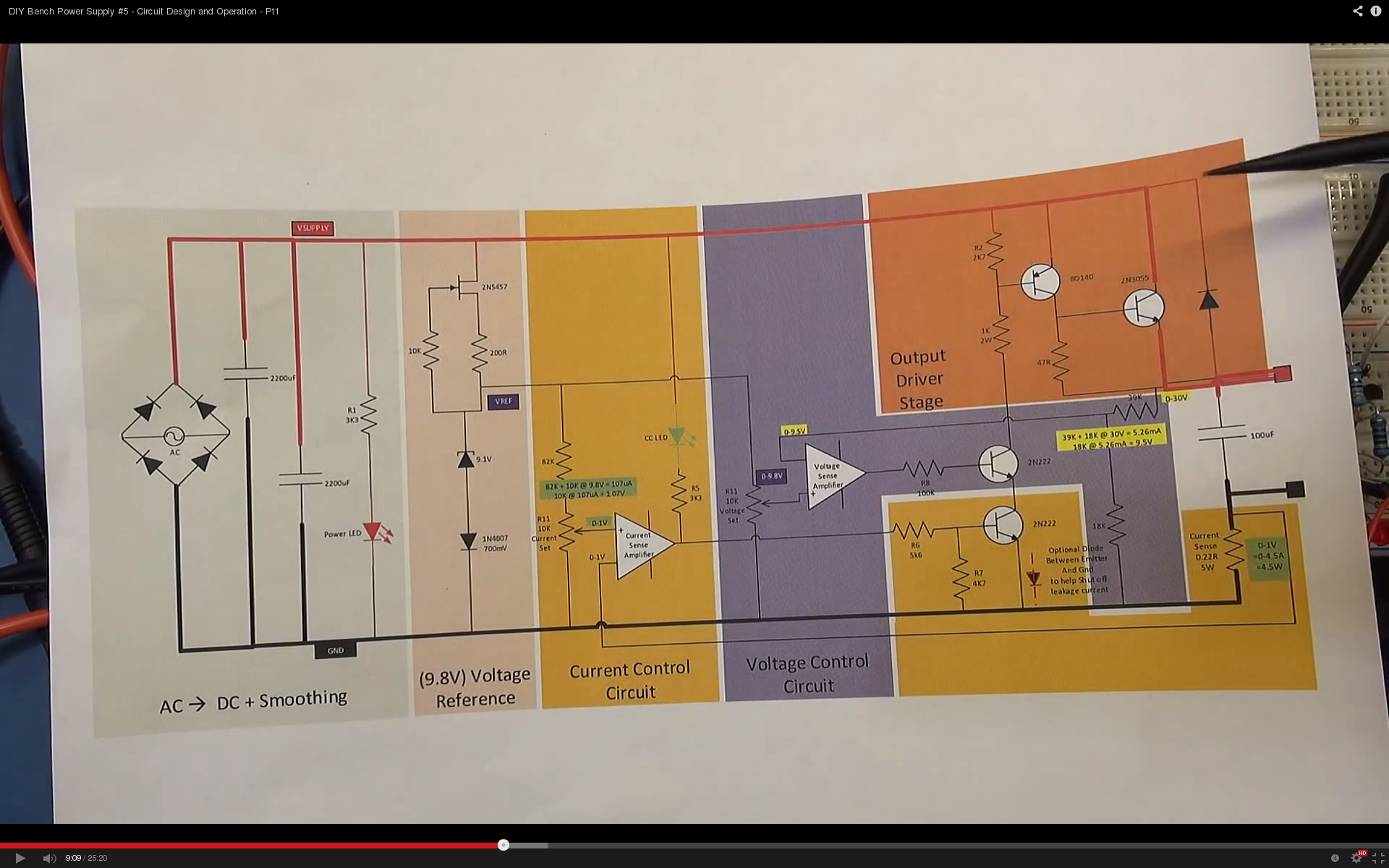

So redwire keeps talking to me about this new power supply over at youtube and I thought I'd draw a schematic and board out because the guy hasn't seen fit to publish anything downloadable or static, just videos.
I don't like video tutorials because they aren't searchable so I don't know if the transformer represented is the right rating.  I just did a freeze frame of the video in HD and a screenshot of the schematic and went from there.
I do, however, get a kick out of working with schematics and turning them into boards and this one was fun.  I've kept the big parts and the parts that get hot off the board so what we have is the control circuitry.  I managed to get this board down to a 5cm square which was really challenging and took me two tries.  This could be made really tiny if surface mount parts were used.
I have not built this yet and can't tell you if it works right or how it performs and I'm just putting it here in the hopes that someone might find it useful since schematics or boards don't seem to have been published for it.  I eventually plan on doing some testing with this to see how it works but right now I've been busy with the other one in the big thread(s).
Anyway, here are pics of the board and schematic and the .brd and .sch Eagle files zipped up for your consideration.

I also sketched this a few days ago up but your Eagle skills are much better.  Please check on the following items:
1. The LM358N has a range of 3V-32V which is out side of the needed operating range of the voltage sense amplifier.  Suggest using a TLE2141.
2.  The current sense amplifier has no connected rails.  In this mode the high would be 0 to 1 V, the LED would always be on,  and Q3 might never conduct.  I suggest a TLE2141 with a cap between the output (pin 6) and Pin 2.
3.  I think R9 should be 2K2 instead of 2K7.
4.  Is R13 47 ohms?
5.  RSense is  0.22ohms
Suggestions for discussion:  Changes I intend to implement-
1.  Use a 15V Zener to feed a 7812 linear voltage regulator instead of the fet and zener combo used to set up a reference voltage.  Using a 15V zener would reduce the rail to rail voltage on the current opamp  as well as the voltage to the linear voltage regulator.
2.  C3 is correctly listed as 100uf but this seems high.
3.  The unnamed main filter cap (4,700uf) seems small for 3A.
4.  A small cap between the output of the voltage control opamp and inverting pin may be helpful.

To be honest, I just did this up for the practice.  I didn't really think about calculating it out and just used a pic of the schematic from the video to sketch things up.  I hate it when people do videos but don't release at least an image of the circuit.
I knew that from the datasheet and to be honest, knew that the transformer voltage was probably too high for the op amp used.  I might redo it with 2141's in place.  I had originally thought of doing that but I just wanted to replicate the circuit first. I should probably just not be lazy about it and calculate out the right transformer though.
The 358 is a dual package so the rails connected on the voltage side will take care of that.
4.  Is R13 47 ohms?
That's the problem with doing a screenshot of a video, hard to read some of the values.  It says 2K7 in my screenshot.  I didn't think twice about the value other than replicating it.  I thought that R13 was 47K but if you zoom in on it, it seems to say 47R.  I'll attach my screenshot so you can have a look
You're right, I forgot to put that value in there.  My bad.
Still, you can see why people would want to do a discrete version though.  I tend to think of regulators as black boxes and op amps as more of a discrete component even though it's not.
I thought that too but, like I said, I just wanted to replicate the circuit in the video.
In the original, it was two 2200uF caps but I don't see the need for separate caps and opted for something a little larger but of a common value.
That's something I noticed that was missing too.  Doesn't it prevent oscillations or something like that?

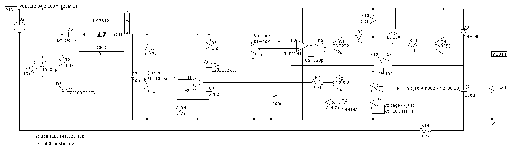

After running some tests, here is the latest version.  Seems to be working pretty well.  I was able to set the voltage to about 3.5 V -unloaded  and then put a load about 1.5A with no drop in voltage.  I will continue to do more tests.  I found that the leakage voltage to be about 3-4mV which is very good and the diode did nothing to change that.
Your R9 82R resistor is hooked up the the wrong rail in that schematic I think.  I'm also getting a lot of oscillations a low voltages when I simulate this and can't get the output to go above 12V with a load.  You say you've got this built?  What's the output look like on the scope at lower voltages?
Share this post
Link to post
Share on other sites
If you connect the 82R resistor to the other rail then you will never measure the voltage drop across the current op amp and the PS will never current regulate.
I had 3 boards made based on the first schematic that I posted.  I  did notice a few problems 1) voltage drop when I added a load  2)I changed to a 10uF cap for faster response but discovered significant noise.  I changed back to a 100uF and it is smooth.  3) It had some noise on pin 3 of the voltage op amp so I put a cap on it and it was quiet.    4) I initially had a cap betwen the ground and ground pin on the 10k potentimeter and that didn't work.  5) There was an grounding error on the old .brd file.    As far as I know the sketch shown is correct.
I get 37V output with a 28AC transformer.  If you only get 12 v then you likely have a short (or equal value) on the feed back resistors on the voltage op amp. Considering you are feeding 12V and only getting 12V out.

I can only get the sim up to 1.1A and it drops the voltage below 12V when it gets there.  I zipped it up for you to try because I may have gotten something wrong.  I've been working on the other one and it's gotten my eyes tired today.
Edit: forgot to add the 2141 models to the zip.

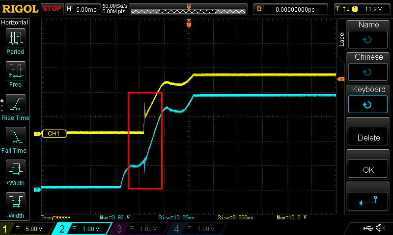

Liquibyte  here are some results:  The blue line is the reference voltage to the voltage control op amp and Yellow is output voltage.
NewFile 3 is startup 12v, under load
NewFile 4 is startup 12v, no load
NewFile 5 is shutdown with load  (no load takes a long time to shutdown for scope)
NewFile 6 is startup 3-4v, under load

I wonder if this is being caused by the zener.  I encountered something like it in the sim I was doing for the other supply.  The spike was cascading through the downstream components and took me forever to figure out.
