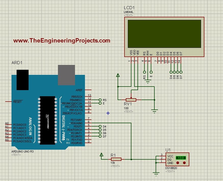

  • First of all, get these components from Proteus components list as shown in below figure:
18B20 in proteus, 18b20 arduino code, 18B20 code in proteus, 18b20 simulation,interfacing of temperature sensor with arduino
  • Now design the circuit as shown in below figure:
  • As you can see in above simulation, we have used Arduino UNO board along with LCD and 18B20 temperature sensor.
  • 18B20 in Proteus can’t detect the real temperature but we can change the temperature by pressing + and – buttons.

  • Now get your hex file from Arduino and upload it to your Proteus Arduino board and hit the RUN button.
  • If everything goes fine then you will something like this at the start:
  • After a delay of around 5 sec you will start receiving the Temperature sensor 18B20 values on your LCD as shown in below figure:
  • Now you can see the value shown in the temperature sensor is the same as in LCD.
  • So, now by clicking the + and – buttons on temperature sensor, you can increase and decrease the value of temperature and same will be changed in LCD.
