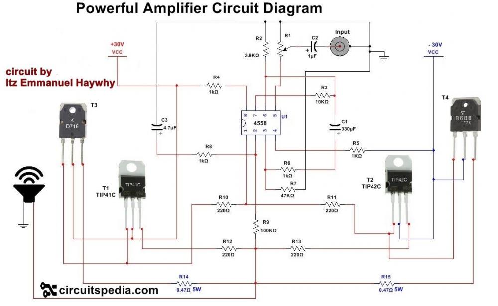

This is circuit diagram of powerful audio amplifier. This circuit is given by Emmanuel. In this circuit one ic 4558 and 4 Power transistors are used with some discrete components. Use 20v-to 60v for operating this circuit. This is a single channel audio amplifier circuit. Use capacitor of minimum 50v value. Positive supply voltage is given at the middle pin of both transistor TIP41C and D718. Negative supply is given at middle terminal of D688and TI42C Transistor. R1 is the variable resistor potentiometer for volume control. This vol. control may be value of 50k to 100k. Use Big size speaker with this circuit. 4558 Audio Amplifier Circuit Diagram.
In image of assembled kit there is no 5w resistor connected

The circuit shown is a block diagram, not a schematic. The inputs and outputs of the opamps are not shown and the collectors, emitters and bases of the transistors are not shown.
An important capacitor between the positive and negative power supply pins of the IC is missing.
Diodes or a transistor to bias the output transistors into class-AB is also missing then there is severe crossover distortion. The volume control is wired backwards and shorts the signal source. The transistors are not connected as a Darlington, they are simply paralleled, why?
Hey, the amplifier has no specifications about its output power or distortion, the impedance of the speaker is also missing.
The datasheet for the RC4558 by Texas Instruments recommends a maximum supply of plus and minus 15V then why does this circuit have supply voltages that are twice too high?
With a plus and minus 15V supply, the maximum output voltage swing of the opamps is plus and minus 12.5V and the output transistors reduce the amplifier output to plus and minus 11V which is 7.8V RMS. Then the output power is only 7.6W into 8 ohms or about 13.7W into 4 ohms.
I made a proper schematic of this nightmare of an audio amplifier showing everything wrong with it:

100% working
This diagram was given by one user that used already this circuit at home by implement from This diagram.
No Direct supply given on ic. capacitor may only one issue
Which inverter circuit is wrong , please tell me , I will checked and modifiy
This diagram is given by one user that used already this project at home by implement from This diagram.
Which inverter circuit is wrong , please tell me , I will check and modify

Your corrected circuit is correct but my circuit is not wrong. One BD140 PNP transistor was also connected as here on that video.

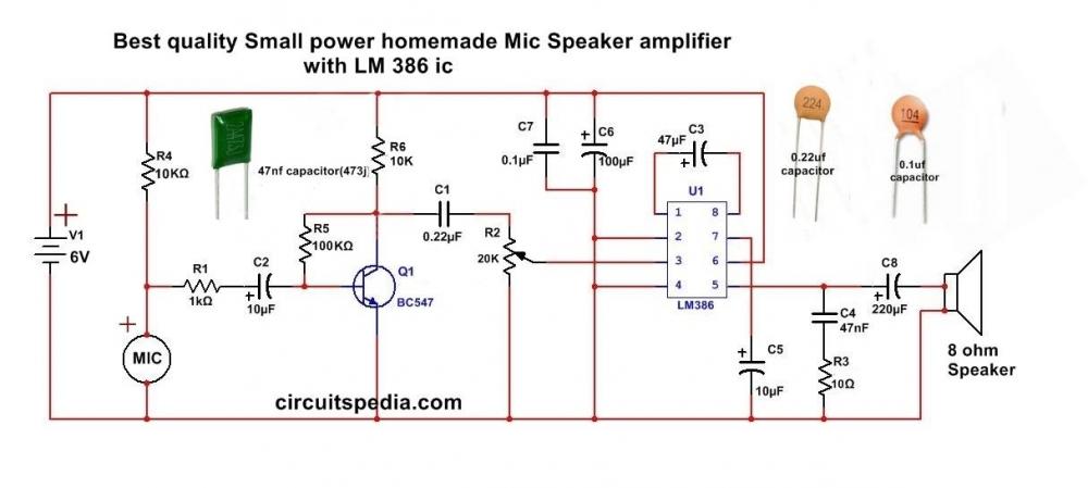

Here is another Circuitspedia circuit that has serious errors. Also, its text says to use a 3V to 6V supply but the datasheet for its LM386 says that its minimum supply is 4V or 5V.
That transistor itself is not required, LM386 will amplify mic input while 386 in high gain mode (1and 8 connected with capacitor).

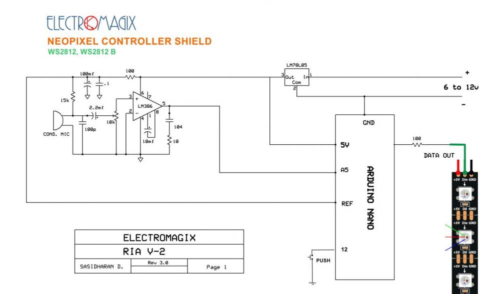

10 hours ago, audioguru said:
The output of the voltage regulator and positive supply for the LM386 and Arduino all need a capacitor to ground to prevent oscillations.
Capacitor is present on board, forgot to draw in the plan.... :D…. Scrooj, that's my neopixel controller board, I made board first  schema very recently. happy to meet you still alive … after six years... this site seems deserted, only the old people like you still dedicating time to educate people....and the people are running behind digital and IOT apps without the knowledge of fundamental electronics. Ha !!
