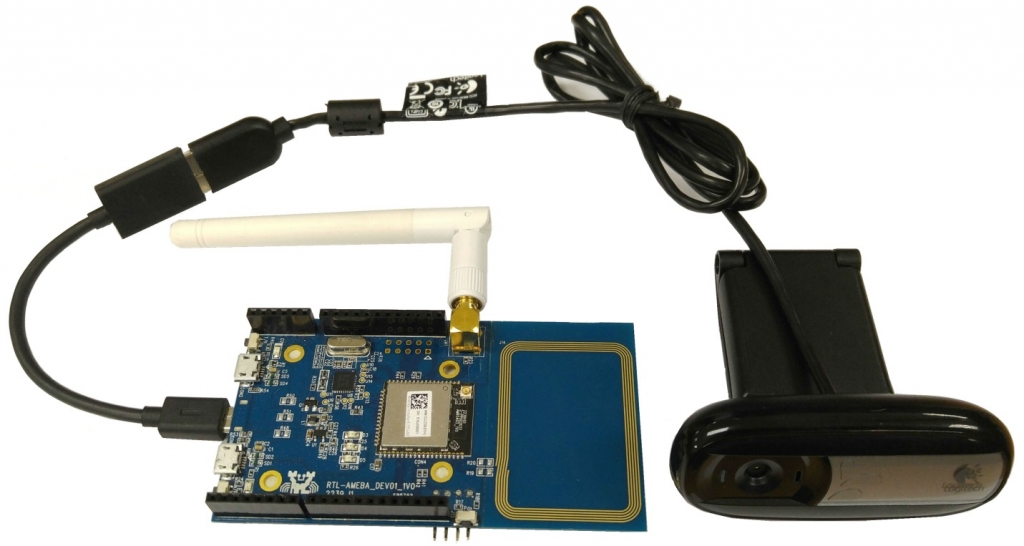

Detailed wiring is as below. Connect Micro USB OTG to Ameba, then connect the USB camera.
Note that in the above wiring diagram, the webcam uses Ameba as power source. If the power supply of Ameba is not sufficient, this would cause the camera unable to work. That is, you have to make sure the power source provides sufficient power to Ameba, or you have to choose the USB OTG which can be connected to external power source.

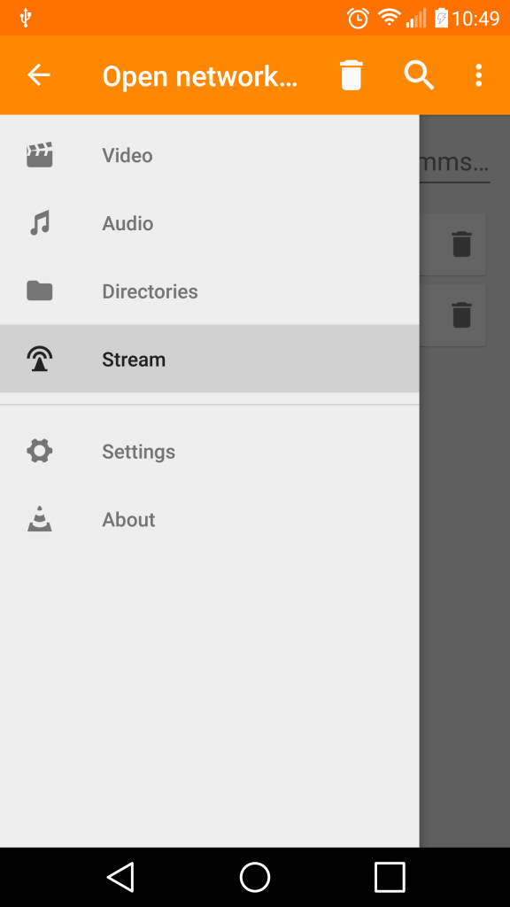

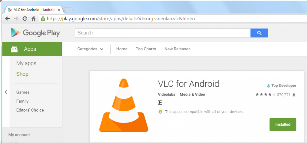

VLC also provides application for smartphone:
Click "Stream"

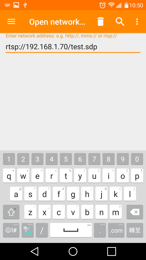

Enter the link, and make sure the smartphone and Ameba are connected to the same network.
