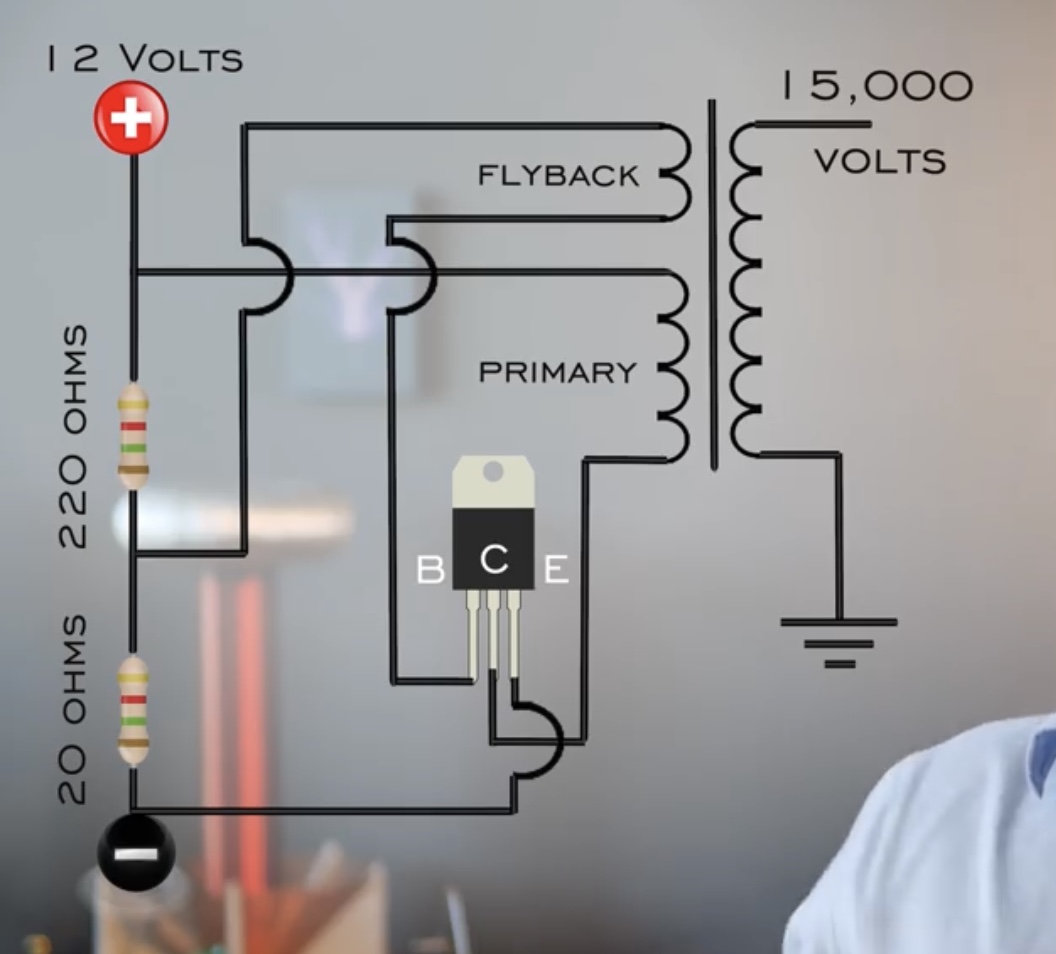

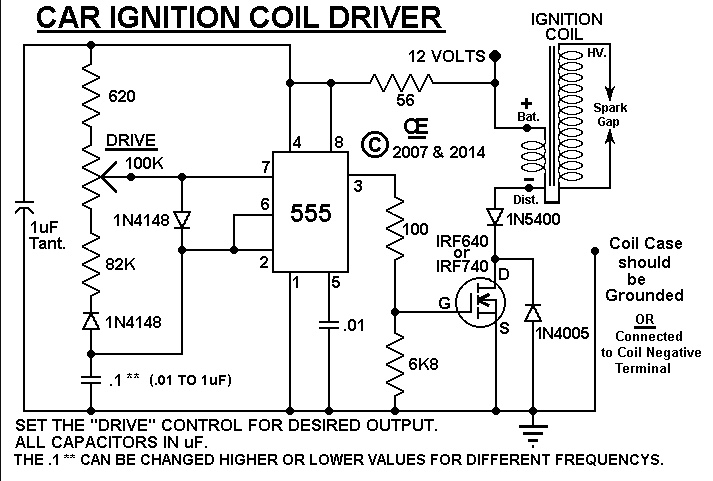

Kerrowman Posted March 17, 2021 Author Report Share Posted March 17, 2021 Hi Harry, That makes sense but in the case of the ignition coil HV systems, like in the link you gave, they can operate at a similar frequency of say 200-500Hz and still give very powerful sparks so is the construction of an ignition coil, and also a flyback transformer, different to such a degree that they avoid this pulse width issue? I'm inspired to build one or other of the attached, although the 555 based one has some useful duty and frequency adjustment. Maybe one of these will deliver 10+kV to my cell without significant losses? Julian Quote Link to comment Share on other sites More sharing options...
