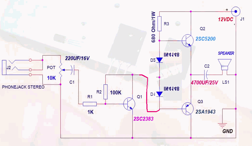

john121 Posted July 11, 2021 Report Share Posted July 11, 2021 Hi And thanks for reading. I have just put together my very first amp and would love some feedback on the circuit. The sound quality is disappointing, works ok, but is there anything you can think of to improve performance. Please see attached image. Thanks! Quote Link to comment Share on other sites More sharing options...
HarryA Posted July 11, 2021 Report Share Posted July 11, 2021 Using what I could find for similar transistors in the simulator I used your circuit: Green trace is the current through the NPN and yellow the PNP. The current through the 8 ohm load looks good inspite of the asymmetry in the transistor currents. Connecting the PNP between the two diodes removes the asymmetry but changes the output current: Quote Link to comment Share on other sites More sharing options...

HarryA Posted July 12, 2021 Report Share Posted July 12, 2021 The output looks good in the simulator at 120mv(peak to peak) the current through the 8 ohm resistor is about 500ma pp which is about 1 watt. At 150mv the output is starting to clip on the bottom. This is do to the PNP Q3 having more base current than Q2. Q3 is directly connected to Q1 while Q2 is off from Q1 by the two diodes or 2 * 0.7 volts I would think. The base currents; green is Q3 and yellow is Q2. I like this circuit better as it is symmetrical; both transistor get the same amount of base current I would think. Quote Link to comment Share on other sites More sharing options...

HarryA Posted July 14, 2021 Report Share Posted July 14, 2021 Making your R1 2000 ohms from 1000 ohms improves the output with slightly less output power. What do you expect for output power and what do you have for input voltage? Also the transistors are large current perhaps some thing smaller? The circuit you are using has a base current of about 1.8 ma for the 2SC5200 at 150 mv peak input that is quite low. Quote Link to comment Share on other sites More sharing options...
