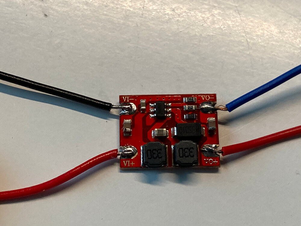

Anders Weile Posted November 9, 2022 Report Share Posted November 9, 2022 I bought this little converter - a DM13B-3.3 which accepts a voltage range from 2.5 to 15V. My problem is that it just seems to short circuit the battery - a 3.7V Li-ion. I'm positive (no pun intended) that I connected the right polarity. The unit got extremely hot in a matter of seconds and started to smell. Have I misunderstood something very basic? The battery at Vin, 3.3V at Vout, right? I have one other unit, but ask for advice, before I sacrifice that one, too. Quote Link to comment Share on other sites More sharing options...
HarryA Posted November 10, 2022 Report Share Posted November 10, 2022 Try measuring the input resistance at the +Vin and -Vin. On the up/down converters I have they measure 400k to 2meg ohms. Perhaps comparing the two would be helpful. One has to expect failures from these inexpensive Chinese modules. Quote Link to comment Share on other sites More sharing options...
Anders Weile Posted November 14, 2022 Author Report Share Posted November 14, 2022 Sorry for the late answer. I measured both units and they behave in a similar way - goes from low to high resistance on the input terminals. However, I tested the other unit and it works perfectly. Seems to just be a faulty unit. Thank you for your reply. Quote Link to comment Share on other sites More sharing options...
