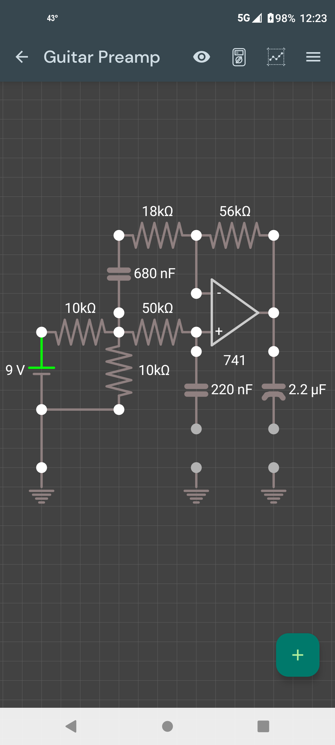

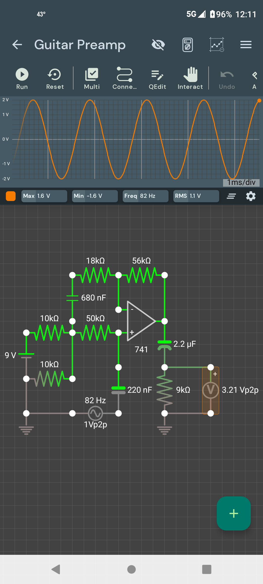

Paul Bober Posted April 20 Report Posted April 20 This guitar preamp feeds the RCA line inputs (-10db), on consumer grade audio equipment Quote
