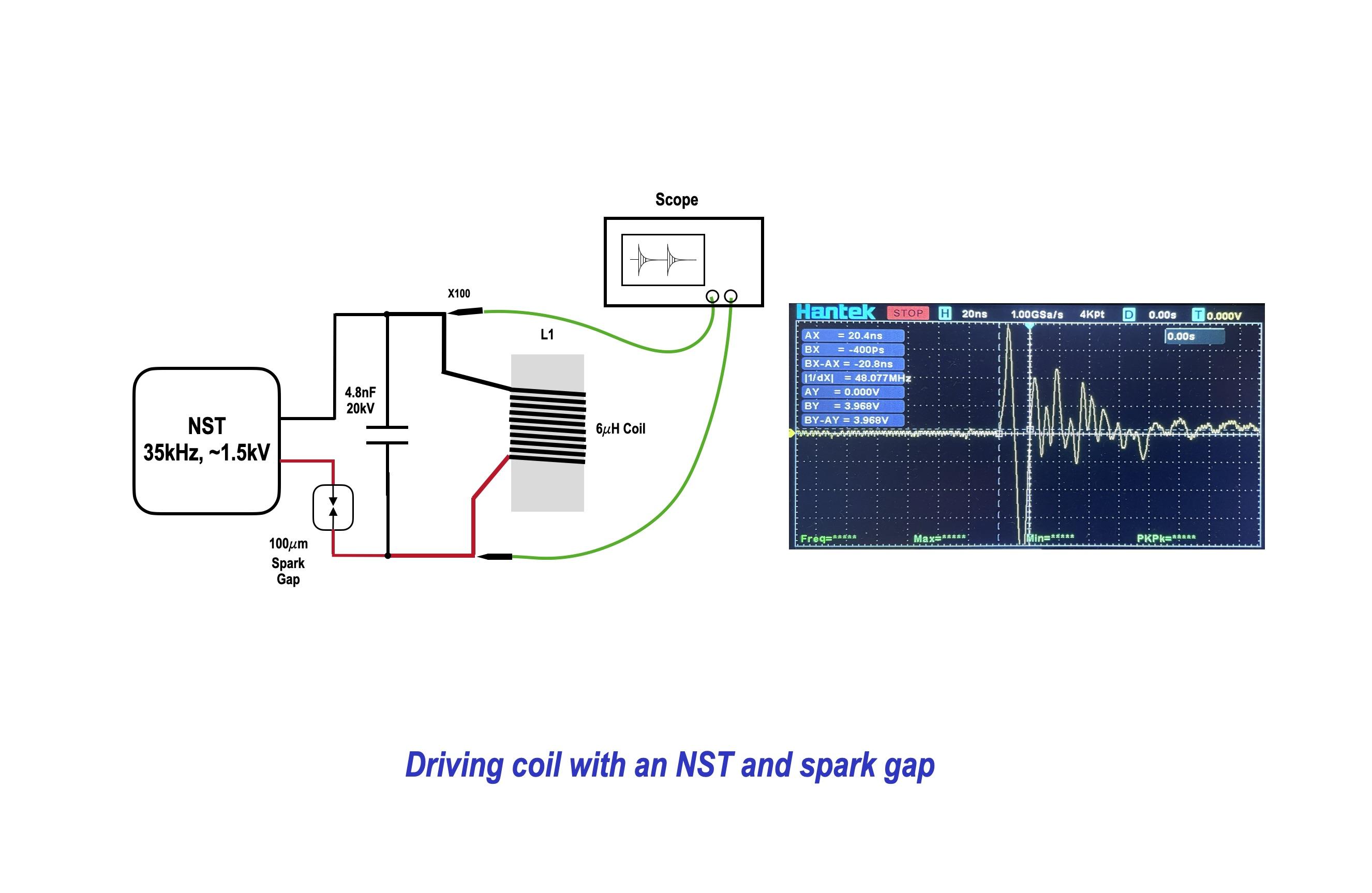

Hi there,
I'm exploring resonance in LC tank circuits at radio frequencies and have a query about my observations.
In the first picture, I have a 6𝜇H coil and a 4.8nF cap in parallel, and I have measured the f(sr) using the setup shown in the attached. The result, according to the scope, is 899.28 kHz (at the bottom). This fits well with the calculated value when you take into account the additional parasitic capacitance of the coil.
Now, when I drive this tank circuit with an NST at 1.5kV, at approx 35kHz and with a spark gap, I can see ringing on the scope with each irregularly spaced spark, but the frequency indicated is around 48MHz, as in the second attachment.
Is this just a harmonic of the fundamental frequency shown in the first slide, or something else? Also, perhaps relevant is the pic of what I take to be the sparking interval, which suggests around 1.3MHz, compared to the approx 35kHz of the NST, and somewhat random, as in the last attachment.
Lastly, substituting the spark gap for a 1kV GDT gives no trace at all.
I would appreciate any comments on what is going on, in particular:
1: Why does the fundamental f(sr) not appear when the NST is driving the circuit?
2: Why is the apparent spark frequency so much higher than the NST output?
3: Why does using a GDT appear to stop the resonance?
Thanks in advance.

I think these were the ones. I have sorted most of the issues except why using a GDT instead of a spark gap seems to stop the resonance occurring. The scope is basically a flat line.

The 48MHz I have shown to be from the wide spectrum output caused by the spark gap. The LC resonance is clearly visible at around 950kHz as expected.
The unresolved issue is why when using a GDT (1kV), the circuit stops resonating.

Not quite. When I replace the spark gap with a 1kV GDT, the system does not function at all. I had hoped that the GDT would result in more consistent 'ringing' of the tank circuit. Any ideas why using it appears to short out the tank circuit?
