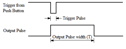

555 Timer IC’s are the most commonly used ICs for timing and Pulse generation applications. They can adopt itself into various applications due to its different operating modes. The three main operating modes of a 555 Timer are Astable Mode, Monostable Mode and Bi-Stable Mode. Each mode has its own properties and applications since every mode provides a different type of wave forms. During a Monostable mode, as the name suggest there will one (mono) stable high state of pulse for a pre-defined time. This pre-defined time can be set by selecting the correct values of Resistor (R1) and Capacitor (C1) shown in the below circuit. This is a simple circuit to make the 555 timer IC to work in Mont stable mode. Whenever the push button connected to Trigger pin (pin 2) is pressed a trigger pulse is detected by the 555 IC and so it will trigger the output pulse on its output pin (pin 3) as shown in the waveform below.
This output pulse will stay high based on its pulse width. This output pulse width sets the pre-defined time and as said earlier it can be set by selecting the correct values of Resistor (R1) and Capacitor (C1) using the below formulae.
Output Pulse Width (secs) = 1.1 x R1 x C1
