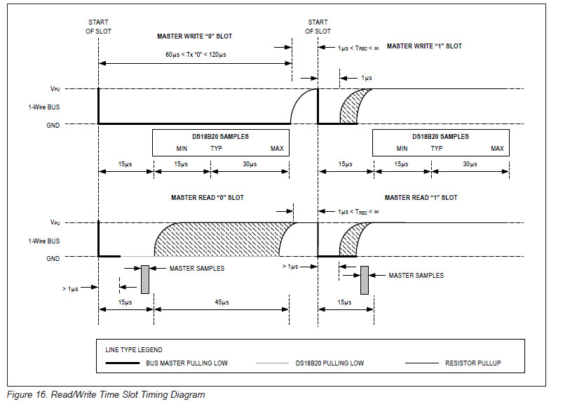

Hi all,
I'm really stuck trying to get my code to work and read temperature from the DS18B20.
After I've parsed the temperature reading I seem to get 0b01111111 in whole degress C.
I used this website to help me: https://www.maximintegrated.com/en/app-notes/index.mvp/id/2420
Code:

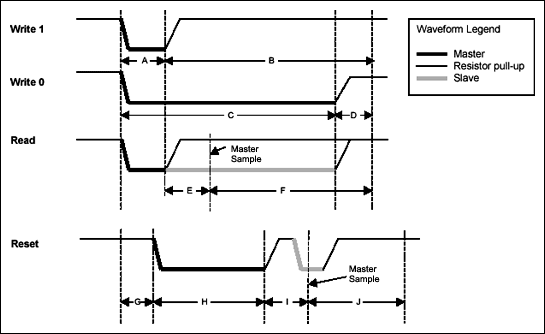

Hi Sadlercomfort,
I read your source code again and they have some point may be "wrong"
Code:
unsigned char read_bit(void)
    DQ = 0;             // pull DQ low to start timeslot
    TRISC0=0;            //Lower the port
    TRISC0=1;            //Release to return high
    DQ = 1;             // then return high
    __delay_us(15);     // delay 15us from start of timeslot
    return(DQ);            // return value of DQ line
Follow up waveform of OW:
Set output--> out 0 -->"have a small delay (A)" -->set input -->"wait a little to make sure DS18b20 return value (E)"-->read bit -->"small deday to wait follow up waveform(F)".
You can follow up waveform I post upper, to fix other one wire function.
I post my onewire lib:
onewire.h:

I'm not using one-wire, I'm using my own supply for the DS, and my Vdd is not tied to DQ.
Can I still use this one wire code?
Also, the timing diagram you've shown me is different to the one in the datasheet and it doesn't include the time.
I'm not very good at reading timing diagrams o_O

Hi Sadlercomfort,
1. You must have pull up resistor from DQ to Vdd, Vdd from 3.3V-->5V is OK. Because DQ pin is open drain. Pull up resistors must be have. Currently, Im using 1k-->3k3. See datasheet to check the maximum Idq and choose pull up res.
2. Of course, DS18B20 communication is one wire, the figure 2 in your datasheet, it the one wire wave form. May be has a little diff but its still one wire.
3. "I'm not very good at reading timing diagrams". Hehe, you have to read if you want to code . If have any issue, contact me via skype:datle2805

Everything is connected up fine as shown in Figure 7. With a 4.7KΩ pullup resistor and Vdd/Vpu are regulated 5v DC.
Hi Sadlercomfort,
Maybe I should rephrase that to 'I'm not using parasite power'. So are you suggesting that only difference with parasite power is the commands..not the individual reading/writing of bits?
I know the importance of reading a timing diagram, that's why I mentioned it.:rolleyes:
Figure 16 is much easier to follow than Figure 2, I'll keep mulling it over until it sinks in.

It's going to take me a while to understand your code.. its like hieroglyphics to me. Again this will take time. o_O

OK, lets start analyze code and wave form.
Note: bold line in wave form mean that master IO pin is set as output, normal line: master IO pin set as input.
1. Master write bit 1: (figure on the right top)
/* Set line low */
// for first 15us second master always write 0 to start a transfer bit
ONEWIRE_LOW();//set output is 0
ONEWIRE_OUTPUT();// set pin as output
ONEWIRE_DELAY(15); // delay 15 us sec, depend on one wire slave device, in this case, follow wave form upper here, figure on the right top
/* Bit high */
ONEWIRE_INPUT(OneWireEnum);// set master IO pin is input -->look at figure again and you will see normal line
/* Wait for 45us and release the line */
ONEWIRE_DELAY(45);// delay 15us + 30 us -->see wave form.
ONEWIRE_INPUT(OneWireEnum);// dont care, I like to release IO as input for next bit transfer. If no need to send, Master IO pin is always set as input and connection is off
2. Master write bit 0: (figure on the left top)
/* Set line low */
ONEWIRE_LOW();
ONEWIRE_OUTPUT();// Set master IO pin as output and set IO is 0 (low)
ONEWIRE_DELAY(60);// delay 15us + 15us + 30us
/* Bit high */
ONEWIRE_INPUT();// look at the last, you see on the waveform have a small "normal line" at high (logic 1).
/* Wait for 5 us and release the line */
ONEWIRE_DELAY(5);// small "normal line" is 5us delay
ONEWIRE_INPUT();// dont care, I like to release IO as input for next bit transfer. If no need to send, Master IO pin is always set as input and connection is off.
3. Master read :
/* Line low */
ONEWIRE_LOW();
ONEWIRE_OUTPUT(); // set output and output 0
ONEWIRE_DELAY(3);// small delay > 1 us-->see wave form upper here
/* Release line */
ONEWIRE_INPUT(); // set master IO pin as input. (normal line in wave form)
ONEWIRE_DELAY(10);// wait a little to make sure DS18B20 ready to send data
/* Read line value */
if (ONEWIRE_READ()) {// get data from device
/* Bit is HIGH */
bit = 1;
/* Wait 50us to complete 60us period */
ONEWIRE_DELAY(50);// wait to finish 60 us one bit read phrase total time
/* Return bit value */
return bit;
Some timing may be little difference. Because using your wave form. But using my current timing in my source code its still work well. Dont worry. hehe

Thanks I'm beginning to understand it more now you've broken it down. :)
I never knew this! At the beginning of the program should I set ONEWIRE Pin as input or output? And low or high?

/* Bit high */
Also, when I set ONEWIRE_LOW(); then ONEWIRE_OUTPUT(); does this mean the voltage on the ONEWIRE pin should read ~0v. Because I've measured this with a multi-meter and I'm not getting 0v.
Why is my ONEWIRE pin not pulling low? o_O
You should set master IO pin as input. because of pull up resistor, logic will be high
Depend on MCU you use, may be set IO pin as output before output its. Currently, Im using STM32F, it work. But in PIC, may be change order, set as output firstly, then output it later.
Please test you can set output and can toggle IO pin.
ONEWIRE_LOW()--> ~0V. If not, please check IO pin is correct. May be you are connecting to another pin. ^^
