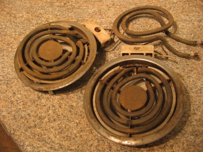

Can you get your hands on some stove heating elements from the thrift store or a home recycling store, etc? You could use that as the load and it would provide the feedback current. It looks like there is a 10A fuse on the 120VAC, so it is meant to operate about a 1.5 HP or smaller motor. The current limit can be set for about 20A max on the DC motor current, so if you get a stove eye with about 5 to 10Ω resistance it should work. You can add 2 or more eyes in series to increase the R and reduce the load current. They will glow and get hot so use caution not to burn down your workbench.

When I recieved the DC drive after checking armature output the only component I changed out was the lm324 opamp but this did not make any difference from what I see. I need to get my hands on a element or somthing to simulate a motor connected.

Why an element? Why not a motor?.
You can find motors in broken devices all day.
Printers, toy cars, trains, VCRs, washing machines, drills, sanders, battery vacuum hoovers, battery fans.
Also a vehicle breaking yard: windscreen wiper motor, windscreen washer motor, electric windows, mirrors, seats etc.
But an element can also be a toaster, hair dryer, sandwich maker, hot air gun etc etc etc. Use your imagination.
