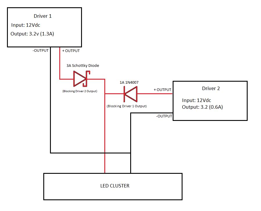

Driver 1 delivers 3.2V at around 1.3A. whereas driver 2 delivers 3.2V at around 0.6A. The regular 1N4007 on the positive output line of driver 2 seems fine in terms of letting current flow through and does not heat up much. Since Driver 1 is delivering a higher current, I want to put the 3A Schottky diode on there. So i guess my question is, will a regular 1N4007 on driver 2 be able to block current from driver 1 and will the Schottky diode be able to block current from the lower current driver 2?
I've quickly sketched up a diagram of the diode application below, do you think the diode arrangement will be ok?
Thanks

The 1N4007 should be fine in this application.
The Schottky diode, too. The leak current should be too small to bother driver 1.

Note that you will no longer have 3.2V, due to the forward drop of the diodes...

Unless it is a constant current supply, which he did mention in the OP.

Yes you are correct it is a constant current supply. And the voltage doesnt change even though I have the diode. I am guessing the constant current driver automatically adjusts to allow the small extra voltage for the diodes?

Yes, it does as long as the load (LED) is within the compliance range of the driver. Which it obviously is.
