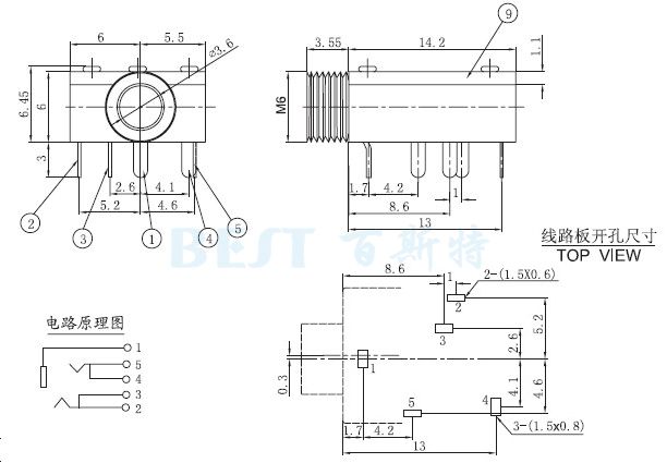

I found these 5 pin 3.5mm stereo audio sockets, any ideas on how I can use the internal switches to light a LED.
Is it as simple as using them as a switch and passing 5V through them, or is using a mains power supply risking a ground through the PC because it's not isolated any more.

You show a stereo jack that disconnects two unbalanced (not bridged) stereo loads and connects the two new stereo loads that are plugged in. There is no third pole to switch on an LED.
