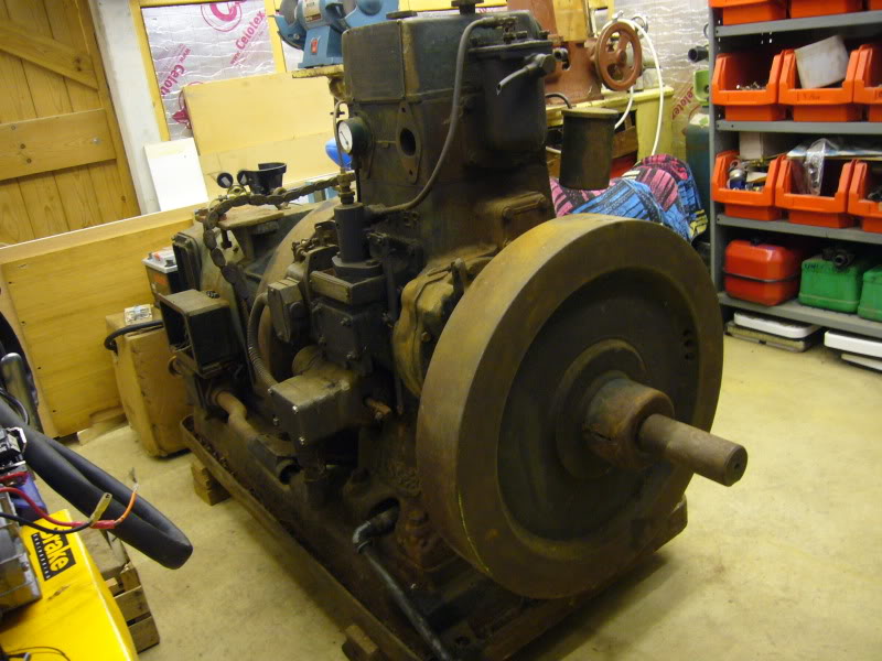

I have a 1940 Lister diesel charging set which uses various large solenoids and oil filled dash pots to control the startup sequence.
I was wondering if I could make a small circuit that could perform the startup and stop sequences. The start up sequence is something like.... Turn on fuel / engage starter contactor (approx 6 seconds) / switch over compression changeover valve / switch in generator contactor etc...

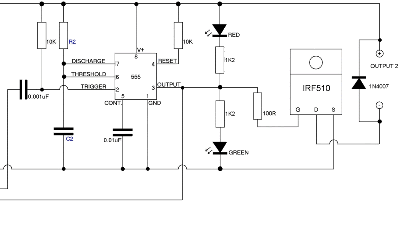

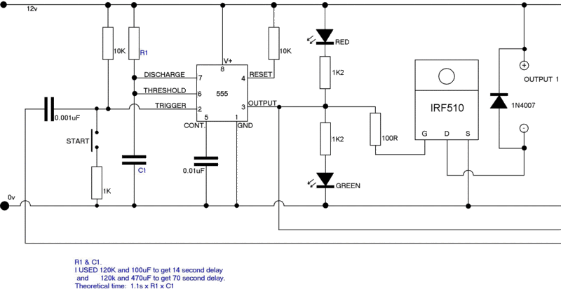

I found various 555 sequencer circuits on the internet, the 555 data and other bits of information and developed this circuit....
I started with one 555 timing an interval and just switching two LED's on and off.
I chose 12v as my voltage to work with as I can then switch relay coils on the output.
Then I added a second timer section and linked them to alternate between section 1 and section 2. It could have been more than 2 sections but all I wanted to do was prove it worked.
I then rummaged around to find a chunky transistor to switch the bigger loads. I found I had some TIP31A transistors and some TIP122 transistors. Looking at the data sheets the TIP122 seemed to have a much bigger gain so a small input and handling a big output.
That has a maximum 5v Base/Emitter voltage so I decided to add a potential divider from the output of the 555 to 0v to give about 4v for the TIP122 as the 555 output is 10.6v.
With the TIP122 connected Base / Emmiter voltage comes down to 1.4v over the transistor so maybe the potential divider is not needed but I left it in there to ensure the transistor did not see any more than 4v.
This is working well and I have been triggering a relay and another solenoid with it. This load is only about 0.5A so have not tried out getting the full 5A out of it yet.
The next problem I had with it was when I was using a piece of wire to cause a trigger on the first section, where my start switch now is, it would also trigger the second section. I tried a 100R resistor and that stopped it triggering both. I tried a 1.5K resistor and that also worked so I settled on a 1K resistor as I have more of those than any others.
I then tidied up my scrawled mess into the image above.
It would be great if some of the more knowledgeable folk on here could have a scan over the circuit to see if there is anything to comment on.

1. The 4V maximum on the transistor I think is the maximum b-e voltage with the base negative. This will not apply here.
2. The transistor needs a specific input current, this can be obtained with a single resistor from the 555.
3. A junction transistor will drop a volt or two, so dissipating heat. A fet can be turned on to provide a very low resistance so will need a very little heat sink.
4. You should have catch diodes across the solenoids to suppress high inductive voltages.

The data sheet says drive with 20mA to provide 5A. The drop across the transistor will be 4V so there will be 20W dissipated - a lot.
An IRF540 fet will have resistance of less than 0.1 ohm when turned fully on, so loss = 5 * 5 * 0.1 = 2.5W
The catching diode must be connected across the solenoid, not the transistor to stop the collector/drain rising above the supply voltage on turn off. The diode will need to pass 5A for a very short time so a 1A diode (1N400x) should be adequate.

Yes, if you lose 4V in the switch, you will only get 8V in your load.
The equivalent connections as you say are:-
Base = Gate
Source = Emitter
Drain = Collector
12v is good to turn the fet fully on so connect it to the output of the 555 without a voltage divider. A gate resistor of about 100 ohm is recommended to inhibit oscillation during the transition. The current going into the gate in the steady state will be so low as to be unmeasurable.

Here is the latest incarnation.
I now have the IRF540 installed.
There is very little voltage drop over it so the relay coil sees very nearly the full 12v which is good.
Before I removed the TIP122 I had in there before I measured the voltage drop across that.
That was only about 0.6v so the relay coil was seeing around 11.4v. I could not find the 4v voltage drop mentioned.

The 4V drop on the TIP122 will be there if supplying 4A, your relays presumably take much less than this.
Do you need a relay? I was under the impression that you would be driving the solenoids directly.
A little simplication can be made by using a single 470R resistor to feed the common led connection.

Edit 3: Just realised I should have the catch diodes on the circuit too...... back to the diagram again.
Edit 4: Updated with catch diodes in:

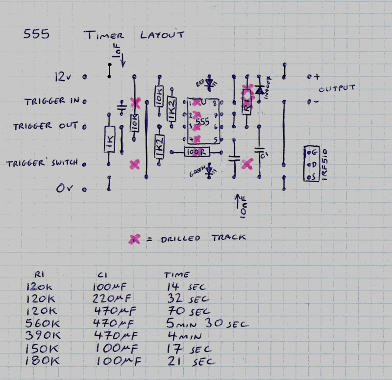

I have updated my layout, made up a vero board layout.....
and made up a couple of circuits.
My camera is useless under artificial light so will take a picture tomorrow.

Something seems to be cacheing an old version of the image.
Hopefully it will sort itself out.
The only difference is I added an extra linking wire across two tracks on the 12v line so the vero board can take more current.
