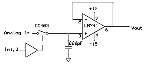

I need to close the JFET in my sample and hold circuit with a postive voltage,
the reason being the sampling must be triggered by a keypress of my CV keyboard, so this mean using the 9V gate signal from the keyboard.
I made a schematic of an idea for this but im fairly sure it wont work,
however it does provide a good visual explantion of what im trying to do,
this will definitely hold the JFET open but I doubt connecting the gate to ground with the 3906 will close it.
there also would be resistors before the transistor base and gate, I just didnt bother adding them in.

all that circuit will do is short the battery through the transistor when the switch is closed.
do you have a switch off a logic level?
if it is a logic level, do the circuits share a common ground?

You need to make the gate negative with respect to the source to turn the FET off.

my thought was that instead of adding an electronic switch I could take advantage of the mechanical switch in the circuit.
original plan :
as you can see the only time the JFET would be closed is during a sample (but thats only if the JFET could be closed with positive voltage WHICH IT CANT :(),
Diode idea:
its now becomes just a hold circuit.
the offset voltage and bias current are miniscule thanks to to LM6144,
If they still pose a problem I was thinking perhaps removing the first stage inside red box,
I have seen circuit that only include the second sampling stage

Ever hear the expression "That's like comparing Apples & Pears"? Well there's no Pears in this Sample & Hold video but there are Apples.
Here's a link to the LF398N that he mentions near the end of the vid.
BTW: I was surprised to find quite a few S & H Circuits that employed JFETs but as stated by Alec the Gate requires a negative voltage with respect to the Source to switch them off.
Chris

I was looking for one of those sample and hold chips in the beginning but I couldnt find any available.
but I think now even my diode idea would be unnecessary (it would cause a voltage drop anyway right?),
in this even simpler circuit the switch could be my keyboard key, the typical first voltage follower you see in S&H circuits is absent but its not necessary in the case of the noise toasters CV input, which we established a few months ago.

The diode in post #6 will prevent the flow of opamp input bias current to ground/negative rail (unless you have some other path for that), and will also prevent the sampling cap voltage from decaying.
Have you considered using a CD4052 or similar?
now im also confused,
preventing the sampling cap voltage from decaying? isnt that what 'holding' a sample is?
and the diode preventing the flow to ground, firstly i dont see the path to ground in any S&H circuit from the diode,
and I dont see how an open switch wouldnt prevent the flow aswell?
Up to a point, yes. But unless you can get the voltage down again your circuit becomes just a peak detector. With the diode in circuit you couldn't measure a low voltage signal amplitude that follows a high voltage signal amplitude.
It would prevent flow; which is why there would need to be an alternate path, which isn't shown in post #6.
Yes but the next time a sample is taken the cap voltage must follow the analog signal. If the signal at that moment is more positive than the previous sample the cap needs to charge more positive. On the other hand if the signal went less positive the cap has to discharge back into the buffer amplifier. The link I posted shows a good scope plot that makes the theory of operation very clear.

im not sure if you understand what I mean when I say I just need a hold circuit.
In the typical S&H a JFET could allow independant control of sampling,
so an AC input could be sampled at any point from peak to peak,
I dont need this, I just need to maintain the DC input from the keyboard once the key is released .
in the red box is 1 key from the existing keyboard , there are 14 in total

What will cause that voltage to fall back to zero?
What are you actually trying to do?
If you can explain it, the solution may not be what you're looking at.
