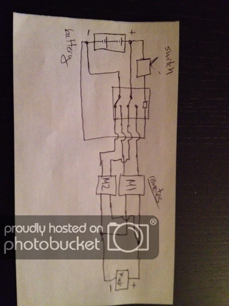

Yes its a 50amp fuse, is there a way you could draw me a quick schematic of the control box? Thanks alot guys, i'll post a pic of the diagram i was thinking about, but still there is a switch inside or outside
gogogsr
Jul 19, 2012
7
Jul 19, 2012
7
Would that work

It appears it will, that is basically doing exactly what I described using a relay vs a keyed switch, the problem is finding a reliable 50 Amp (75 Amp or more would be suggested) 12 Volt relay...
It would require a separate control box with logic, relays or SSR's and power supply.
This is how most winches operate, the hand held control just flips starter solenoids in a control box... It really simplifies the swapping out as you are now just dealing with switching the low current hand helds, and that is usually just breaking the ground (hot) to each one...

Actually, I was thinking of something with intelligence, IE, no manual transfer switch. CC has a good point though. They have to be beefy relays. I'm a bit astounded that that handset drives that motor directly!

Yes CC, I agree. That circuit is workably simple if his client will be happy with it. Not that I would recommend using a smaller relay than 75A but in his design the relay contacts aren't doing any live switching which will reduce the demands on the contacts considerably.
