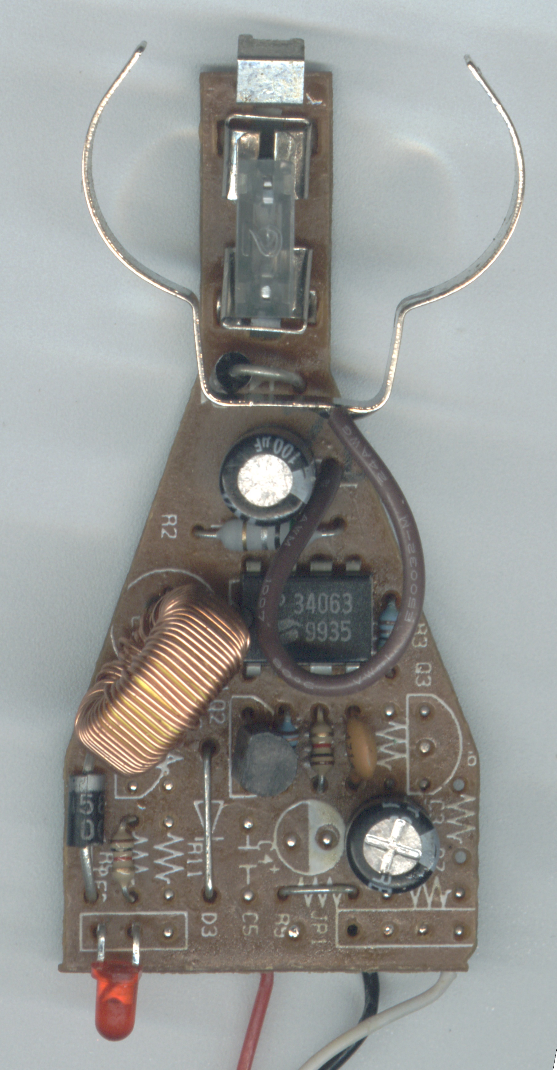

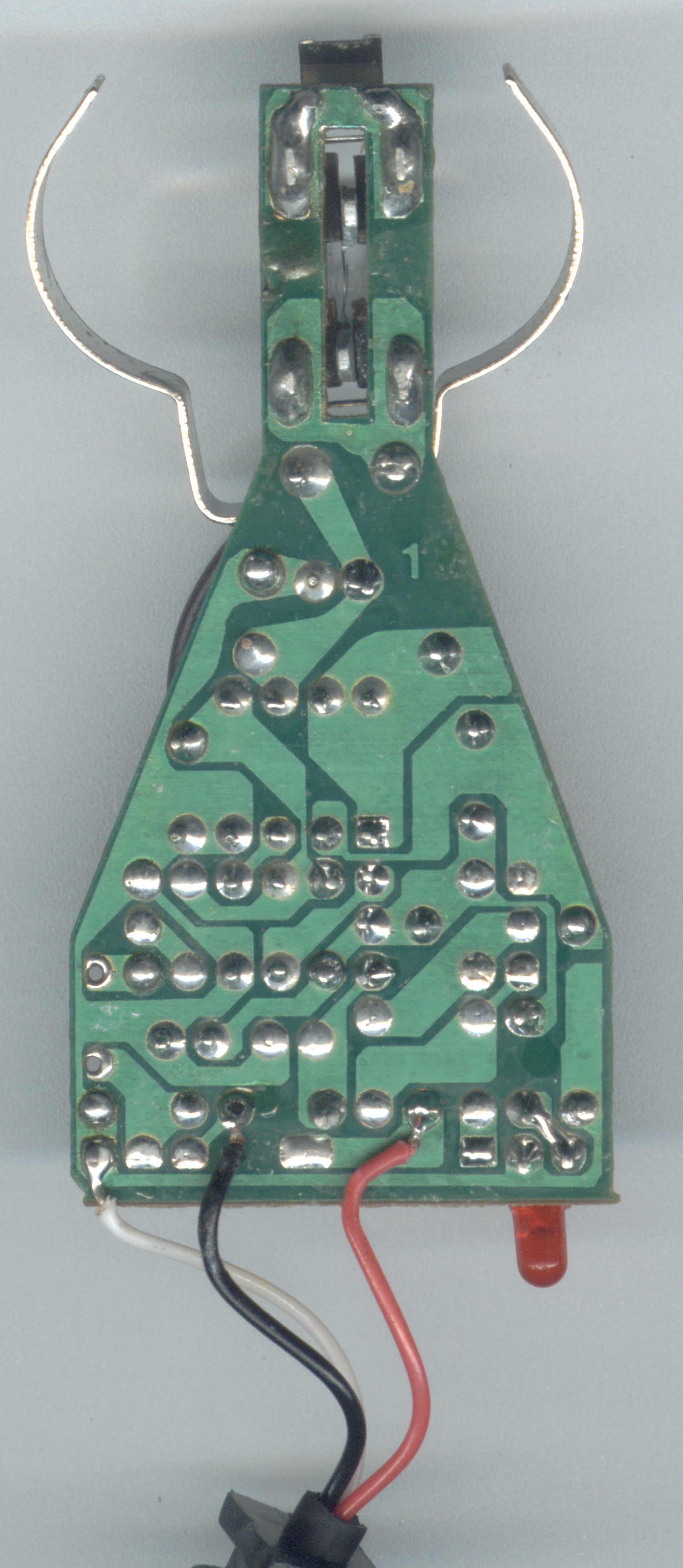

I just remembered that years ago I tore apart a Belkin F8V718 vehicle lighter outlet to phone charger adapter that used an MC34063, and had made pics of the PCB for it:

That looks useful !
So it uses a torroid iron powder core inductor.
But i suppose a shielded inductor would be better since the psu will be on the same board with the microcontroller.
