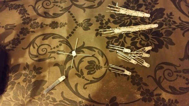

I have many 5 mm RGB LEDs that I want to solder together into a long chain. I want to make three chains of about 30 cm length. They will be hidden inside some frosted acrylic tubing so it doesn't need to look too pretty but it does need to be pretty straight.
In this picture you can see the method I've used to bend the legs outwards, then downwards before soldering each LED to the next. I guess I can just proceed like this but it's hard to keep the thing going straight and I wanted to check whether anyone knew of an easier or tidier way.

You maybe better to have a wooden template.
Or a wood dowel.
leave the 'common' straight and bend the other legs out. Then use the 'common' on the wood dowel keeping it all tidy and straight.

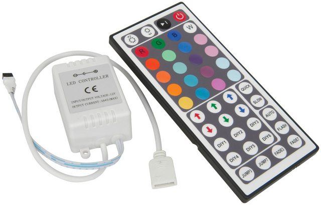

Hi, thanks for your advice. I'm actually intending to use one of these controllers from China. They seem to output a constant voltage and I was going to use a single high-power resistor (one for each colour) attached to a heatsink. There will be three columns of LEDs in series. I've done a similar project before where I used high-power LEDs (~1 W per colour) and it seems to work okay.
